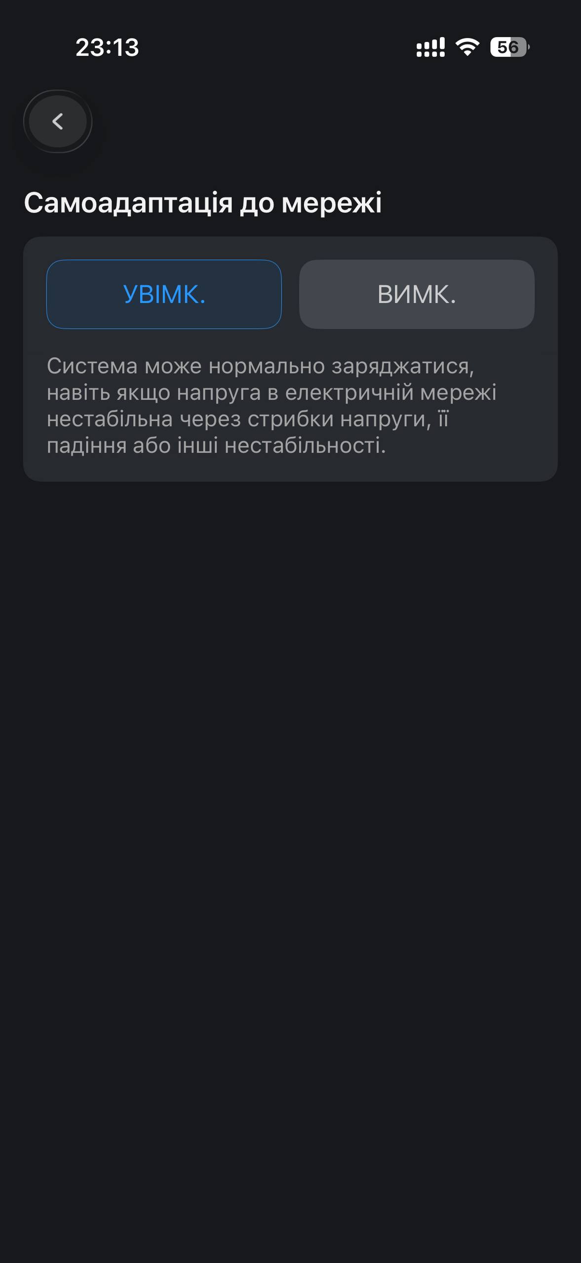

Hi @likeastwood, ror the AC300, please enable Grid Self-adaption mode while charging with the generator, then adjust the parameters according to the actual input.
As for the Elite 10, we have removed the upgrade notification, so you will no longer be disturbed by it.
I can only enable this function. There are no additional settings. Elite 10 has additional settings, but this station will not charge from the generator either. The stations detect power, but do not charge.
