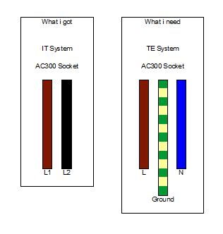

Has anyone a solution to get the Grit system from the “IT” the AC300 delivers, to a TE ?
I’ve installed my AC300 and everything works fine, but my problem started when i tried to connect it to my Pool…

Austria, but we got the same Grid system as Germans. The problem i got is, that the pool needs Line, neutral and Ground(don’t ask my why, probably because of the in-built heating system and laws and regulations) . which the Bluetti AC300 does not deliver. (see illustration in my 1st post)
If you measure the current on the outlet, you get 230V only if you do it on both pins, if you measure 1 pin and “ground” you get about 40V.
