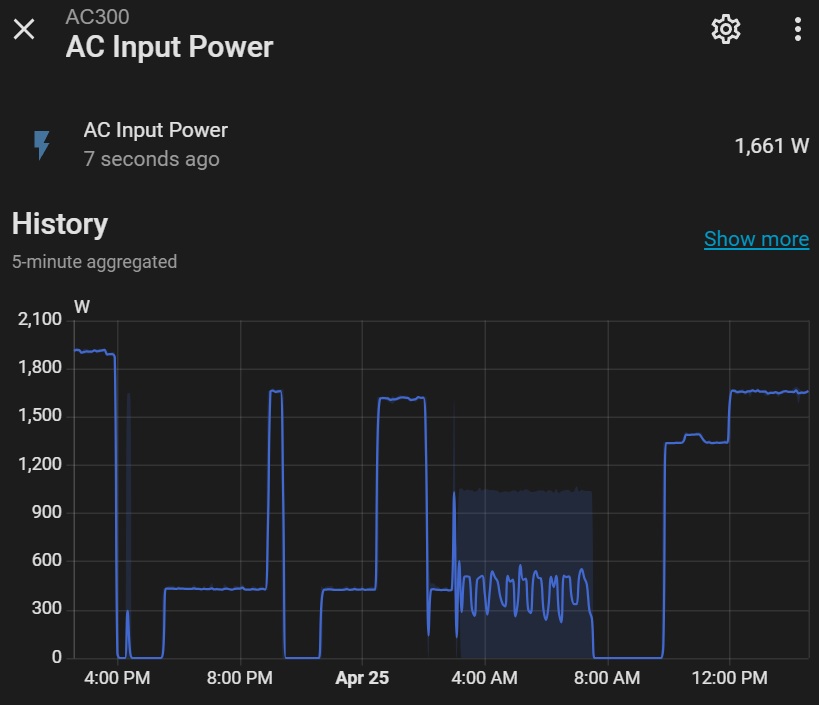

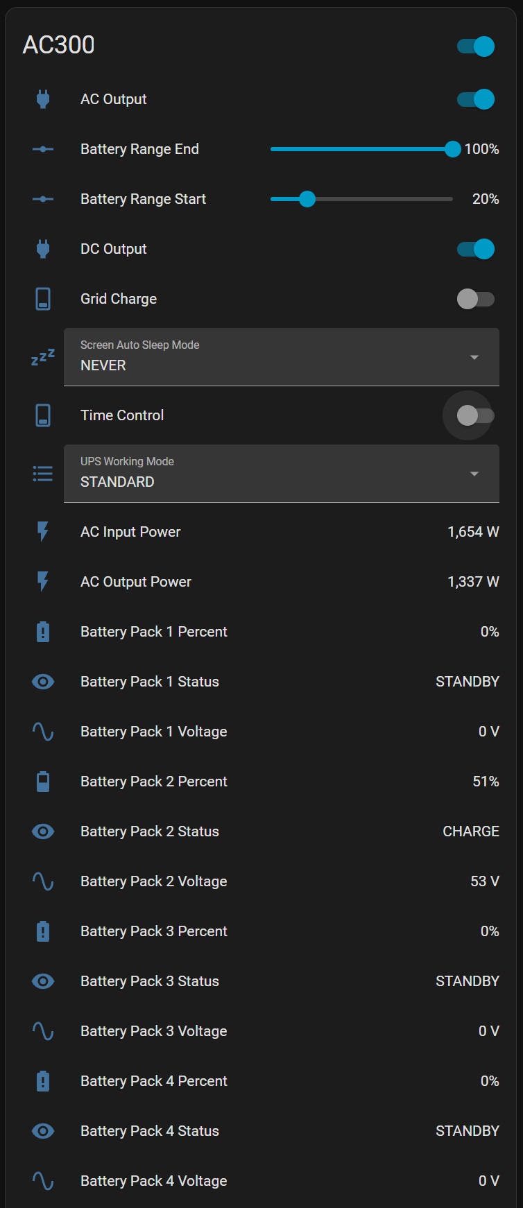

I have integrated my AC300 into Home Assistant without any issues. I can change all values i.e. UPS Working mode, battery charge high and low level, AC and DC sockets on and off. However when I turn off grid charging the AC300 still pulls power from the AC mains? I have a temperature probe on the plug and I want to stop AC charging if it went above a certain level. Any help appreciated.

I haven’t tested the UPS Grid Charge button, but I seem to remember that it is designed for the schedule mode as in peak and off peak. So you might need to switch from UPS Standard to UPS custom to get it working. They talk about the purpose of Grid Charge in the below video. As with a lot of the UPS functions they often don’t work quite as you might expect them to judging by their names.
