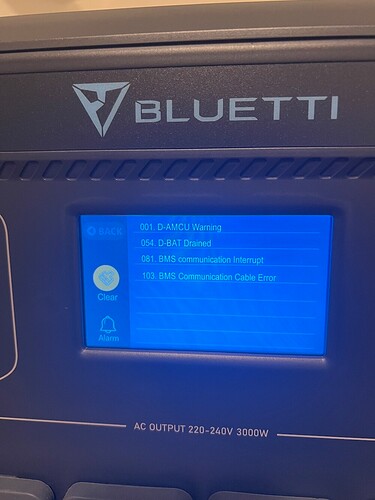

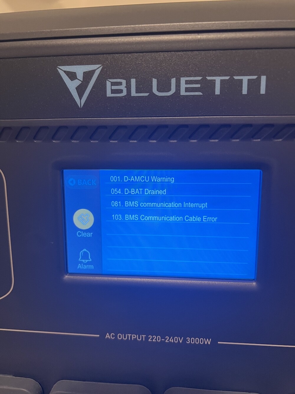

Thank you for your reply. Yes, I’m having issues with my AC300 and one battery in particular. Even though the battery appears to be turned off, as soon as I connect it to the AC300 it powers the unit on. This seems to mean that it is still supplying current even when switched off.
My AC300 also shows error messages from time to time for no apparent reason, and then they disappear. This happens even when I am using the two other batteries that are working properly.
Thank you as well for reminding me about the Chinese New Year.
No probs tonino take a picture of the error code and the more information you can provide to Bluetti regarding your problem and I’ll speed up the process when they get back to you. I tagged @BLUETTI_CARE in the reply so hopefully won’t be too long before they get back to you.
Also when you connect the battery it will turn on the unit. But if you have the inverter turned off and the outlets it won’t draw power.

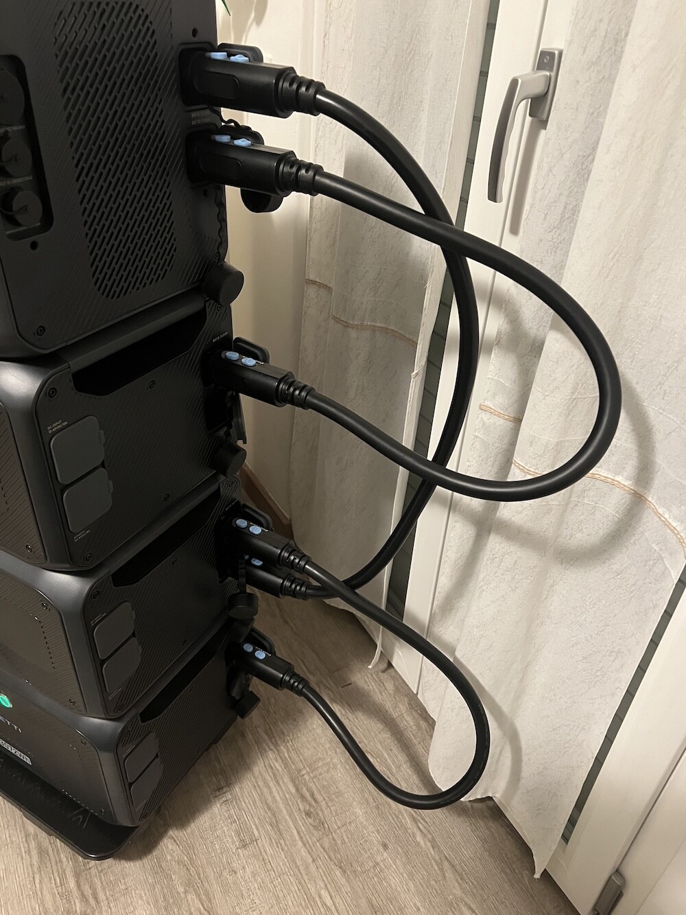

The battery that is causing the problem is the first one from the bottom and it keeps turning on the AC 300 as soon as I connect it even if the AC 300 is off and the battery is off, so it’s as if it stays on even if the button is off. All this generates the error codes you see in the photo, while with the other batteries this doesn’t happen, the error codes come and go until I disconnect the defective battery. I say defective because I don’t know what the cause is. I also replaced the cable and it’s connected to the AC 300 alone, but nothing. I hope I was clear since I use a translator.
