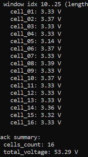

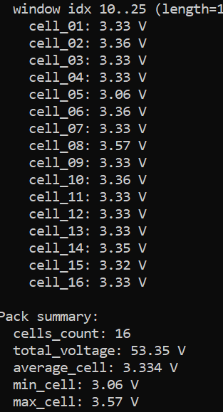

I found a utility that scans the condition of the cells. Is there a way to perform battery balancing?
It was left charging for 24 hours from an external battery via the PV port and then turned off
