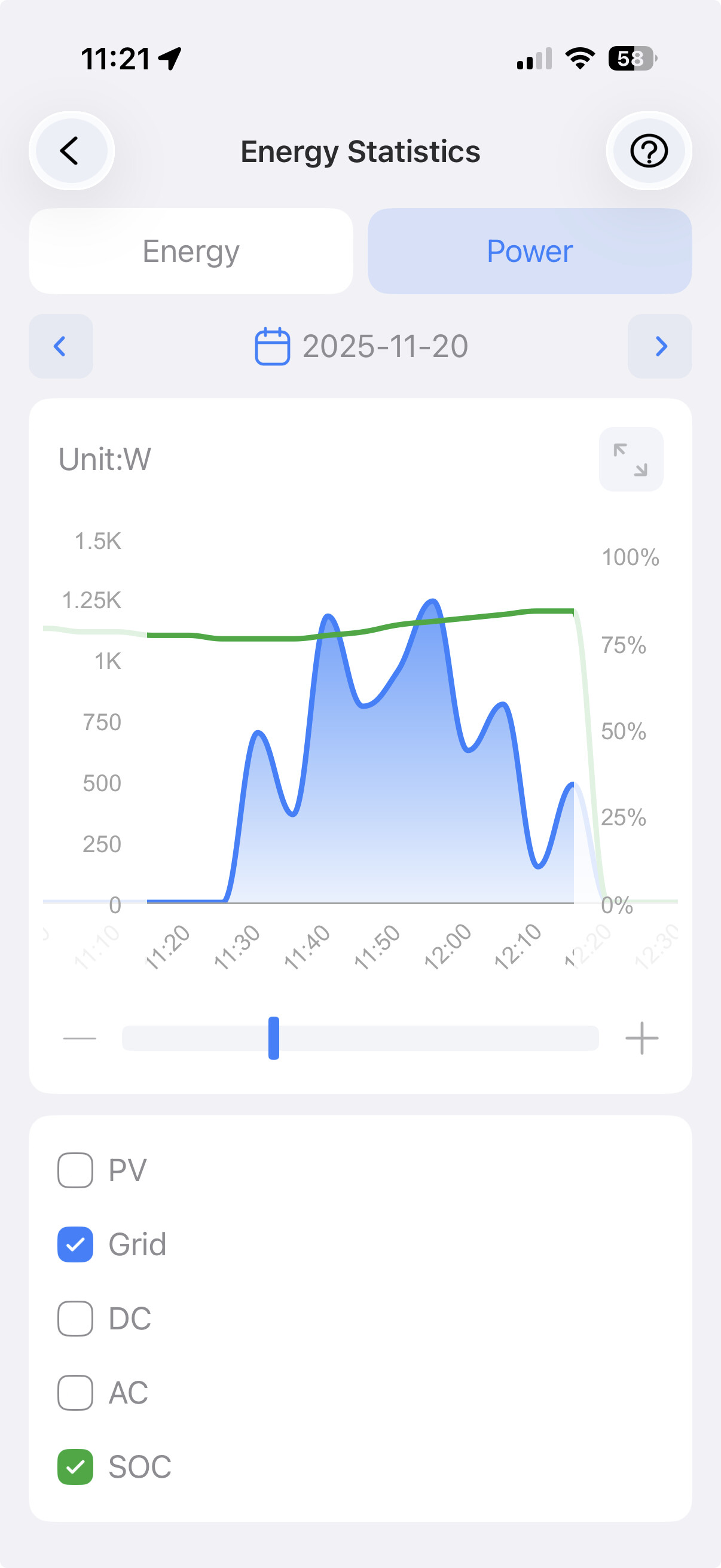

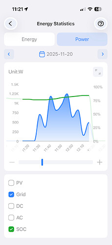

in my case (AC00PL+B210P) powerlifting is off. DC and AC are off. In this scenario grid input power jumps between 150W-690W-980W-1.3KW in Turbo mode or Standard, doesn’t matter. Here how charing power input looks like during last 60min (SOC was 75-85 during this period)

Ok I think I understood the cause of this problem.
Seems the station charing input power depends on the input voltage. When Grid Self-adaptation mode is OFF and grid voltage is 190-205 the station charges at some minimum value (200-300W). Once you turn adaptation ON input power goes to max level.
It would be great to have some feature that will turn adaptation OFF once station is fully charged because adaptation feature slows the UPS switching time.
