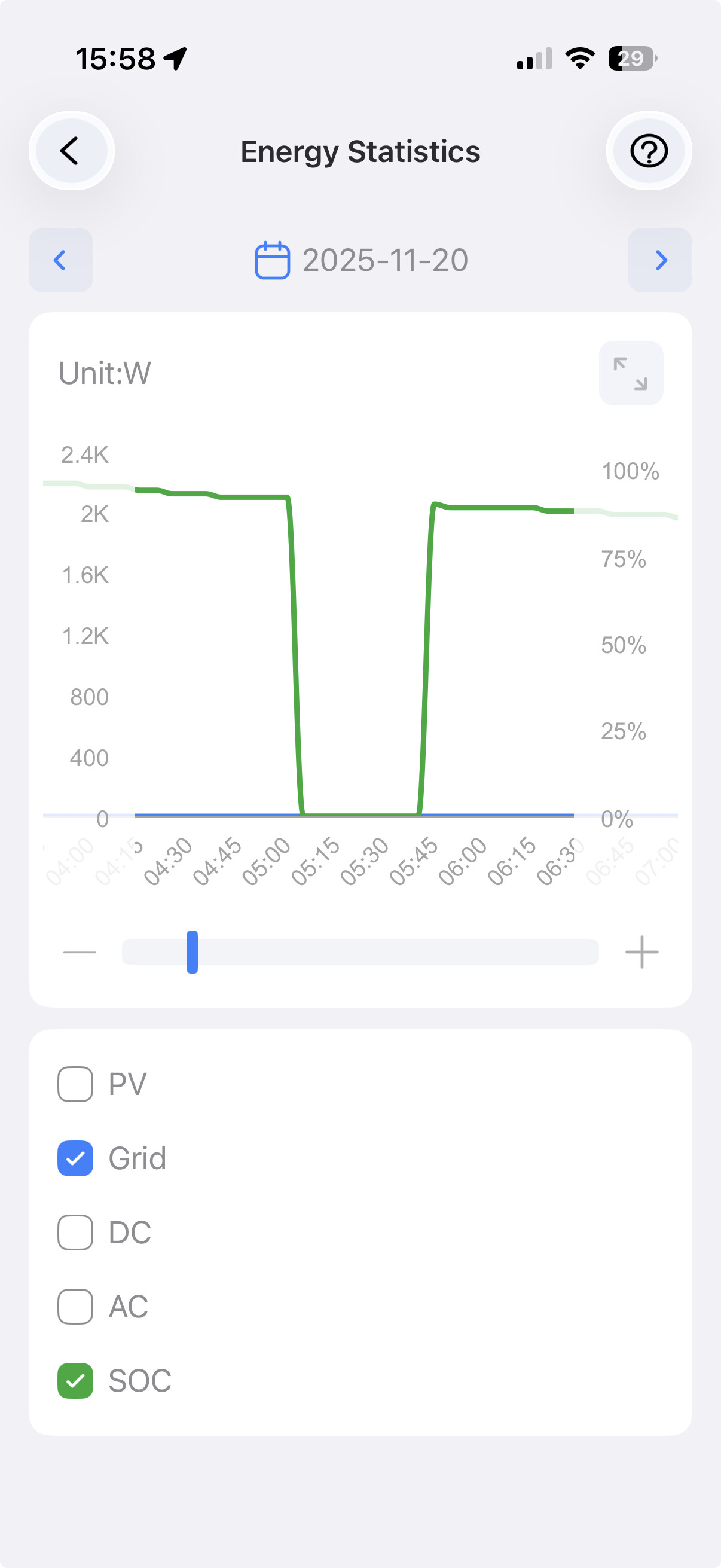

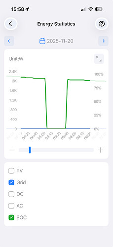

I have the same issue. Also seems that the issue affects power statistic graphs. Then your server is down all lines drops to zero
