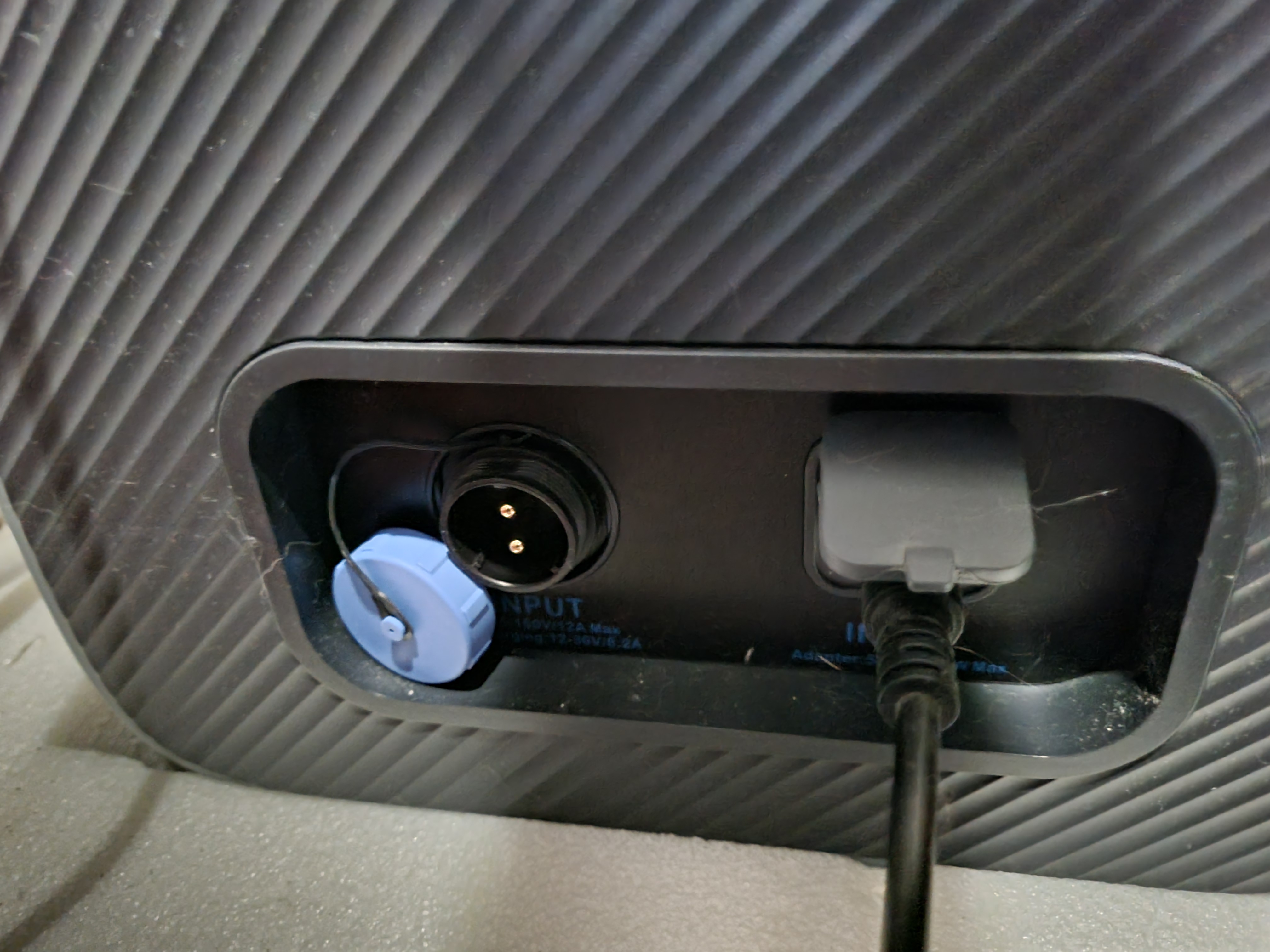

Can I connect my AC200P with B300K using P090D adapter in Power bank Mode?

Hello, you have to buy one P090A to connect those.
Don’t sure.
My ac200p have only PV input connector
I apologize for the confusion. Your device is the AC200P, which does not have the bundling feature. Only the AC200Max and AC200L models support this functionality.
