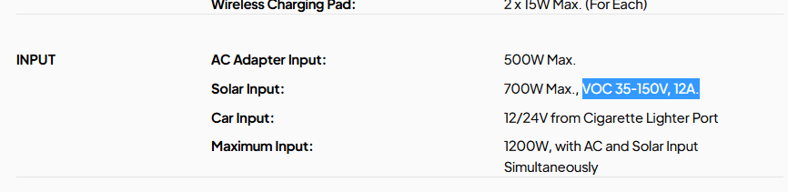

@Fitzy You are outside the VOC range. In other words your panel voltage is too LOW. The AC200P has a VOC of 35-150V which means it needs a minimum of 35V to start charging the generator. Any less then that and you won’t start charging the generator.
