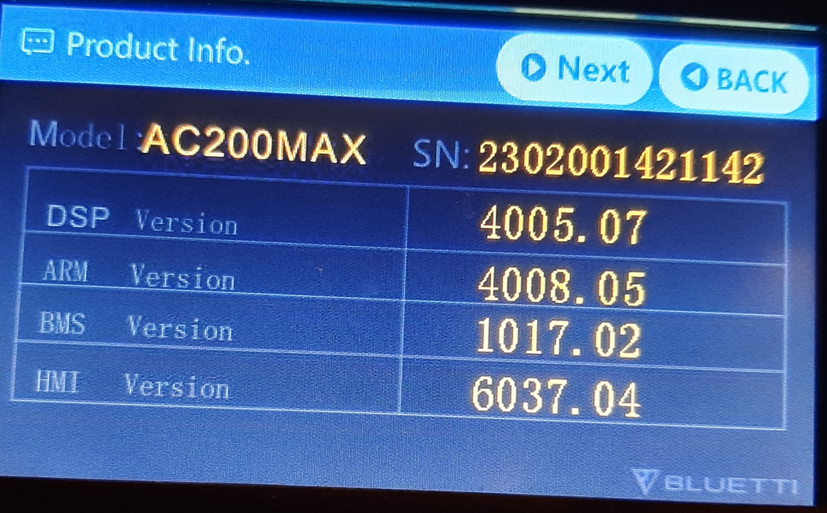

@BLUETTI_CARE Do you think a firmware or arm update could be beneficial in this situation? I’ve also noticed it happening in the other direction for example while charging I’ll reach 60% or 70%, and then suddenly it jumps up to 100%.

I appreciate any advice about how to proceed. If you think the bios or arm update would help I’d like to try. Otherwise if you advise I can send it in for repair replacement or control check, it’s still under warranty.

Hi @Metallicat.420, Thank you for providing the detailed information—we’re happy to assist you!
We believe updating the BMS firmware will indeed help resolve the issue.
We’ve rolled out the batch push of BMS v1017.03, and you can upgrade directly. Please register and bind your device in the Bluetti app, connect via Bluetooth, and then proceed with the upgrade.
After that, please recalibrate the system.

Okay that’s great thank you I updated the BMS as directed.
I will follow the other steps and see how the device responds. I will give some news after I complete this process, thank you.
After tesring for a few days I can confidently say this update has solved my issue thank you very much!
