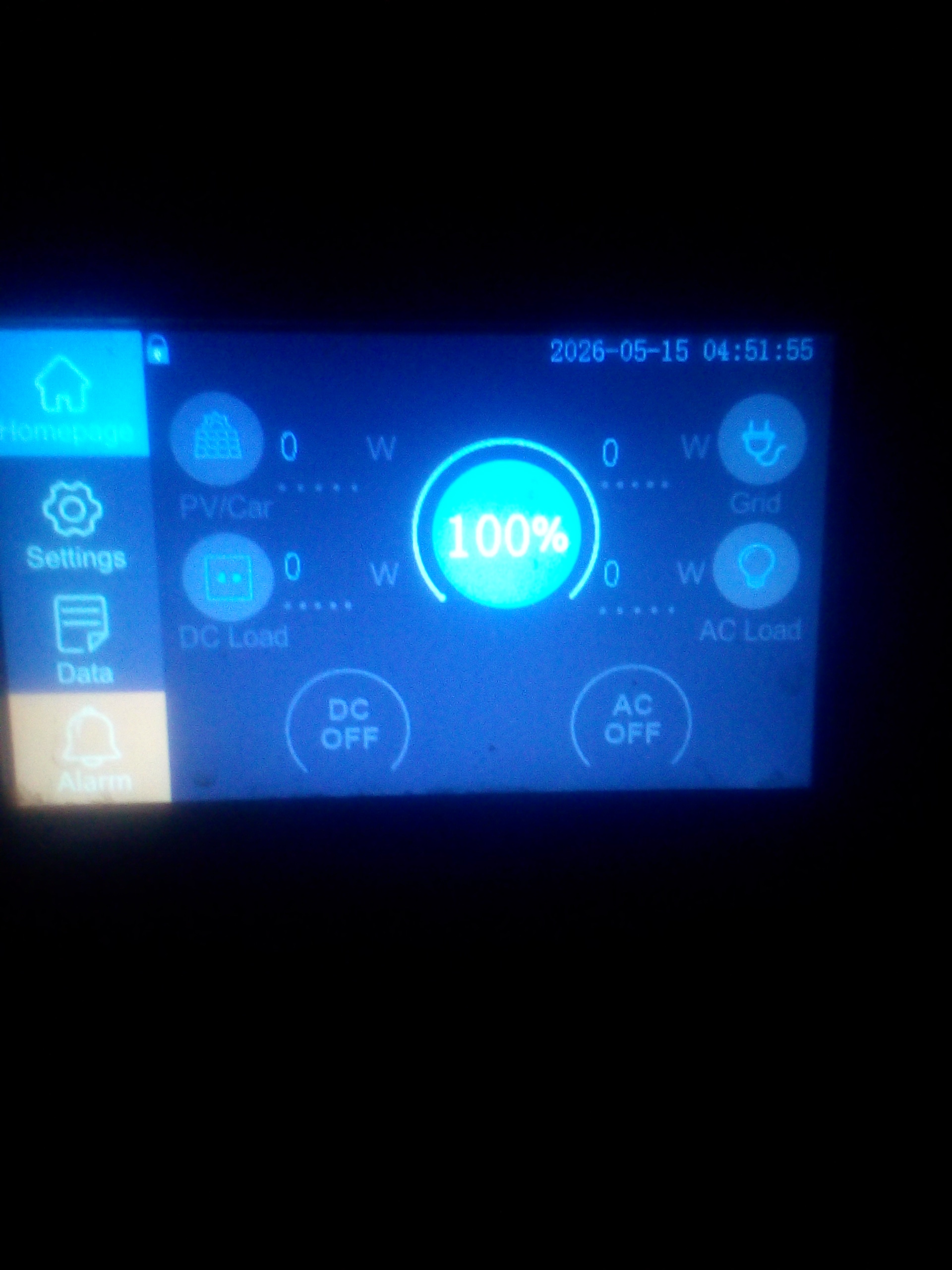

https://community.bluettipower.com/t/solar-panel-q-a-list-post-your-questions-about-solar/35619Bluetti i need your assistance please my bboxx AC200MAX is not working again, it doesn’t bring out any output at all and if i on it, gree light and alarm will sound like 10 seconds and it will off. And the battery is in 100%, I’ve tried all advice in this community but no difference. please I’ll so excited if it can be rectify shortly. Here is serial number:.
Well done bluetti. Please regarding to my ac200max. I need your help about it because it’s yet to work again.
@Bluetti admin i need your assistance please my bboxx AC200MAX is not working again, it doesn’t bring out any output at all and if i on it, gree light and alarm will sound like 10 seconds and it will off. And the battery is in 100%, I’ve tried all advice in this community but no difference. please I’ll so excited if it can be rectify shortly. Here is serial number:.
Hello, we have registered your issue. I will notify you immediately once I receive any updates. Please wait patiently.

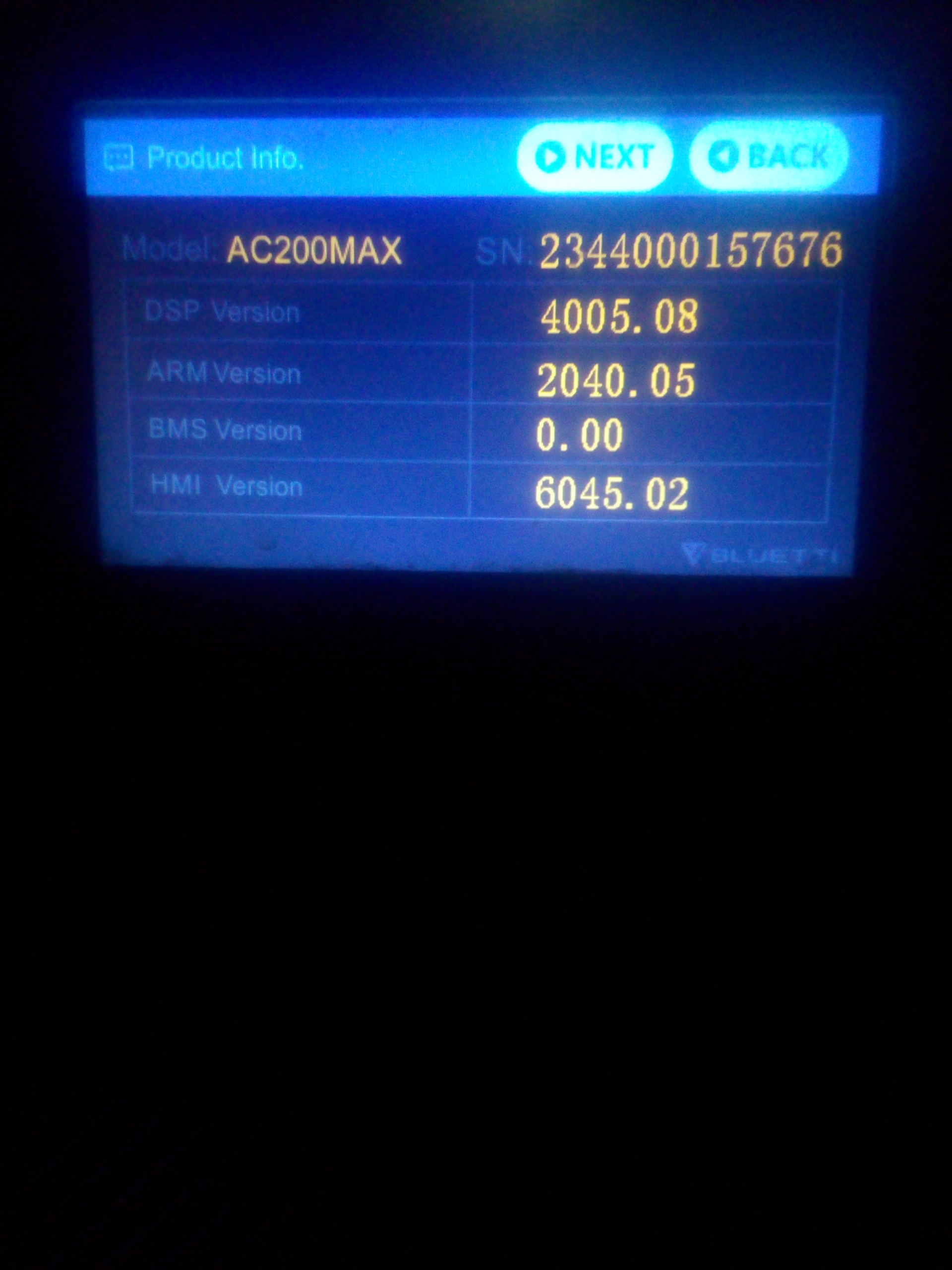

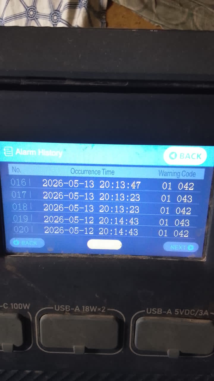

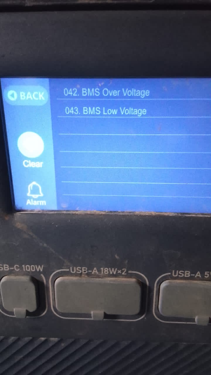

Hello, please check the machine for any error codes and let us know.
This is it sir
