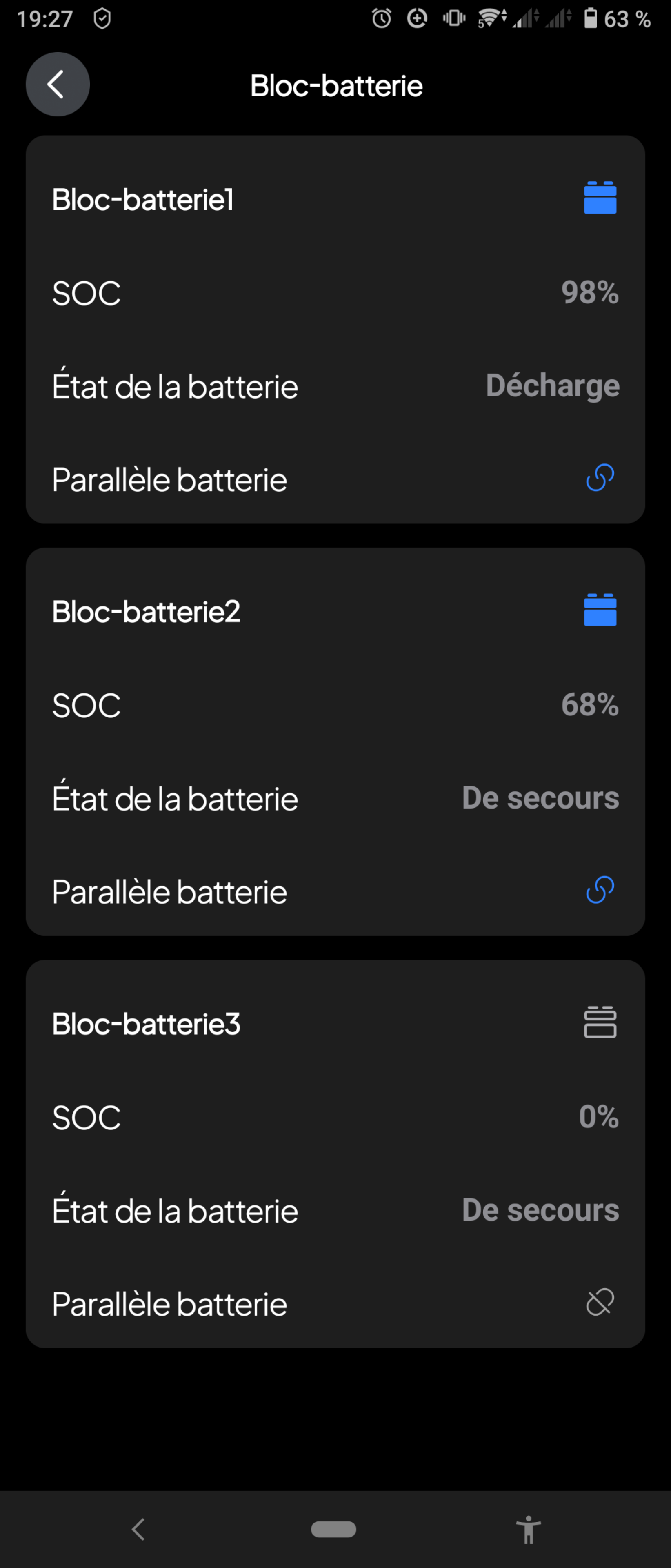

But about number of firmware BMS etc of my B300, I cannot see informations about it when I click on the percentae button of Bluetti app (see capture below) :
It is sure I can see this information through the app or through ac200max screen panel? (I didn’t find in my side).

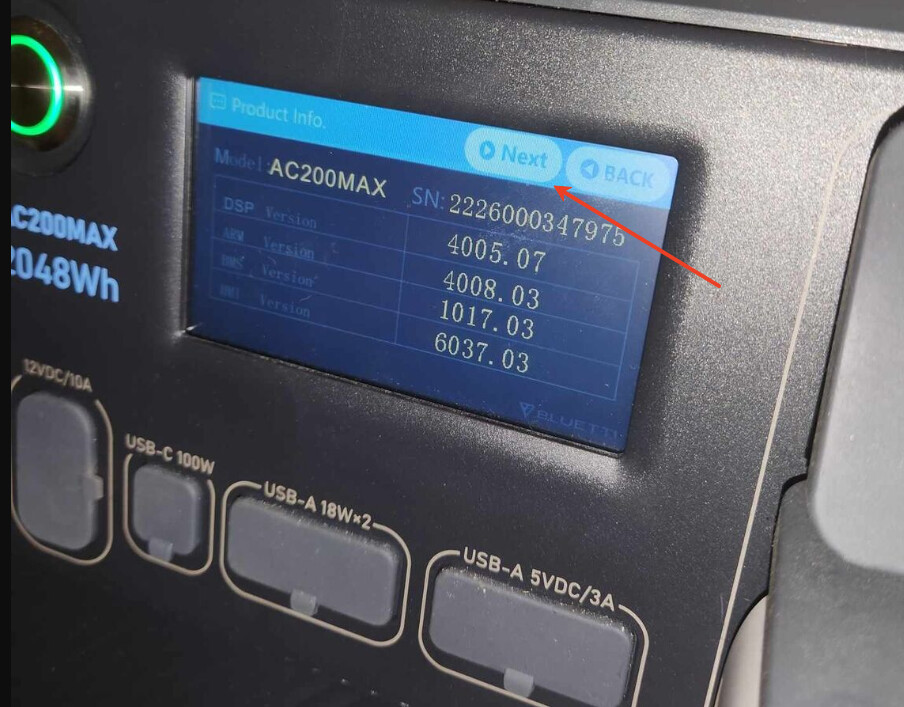

Hi @Matomcat, Thank you for the update. It is indeed a bit strange.
Could you please find the product information interface on the AC200MAX unit, then click “NEXT” to locate the BMS version of the B300? Hope this helps.

Hi Mat, On the AC200MAX unit itself in DATA / PRODUCT INFO / NEXT it has two spaces for BMS1 and BMS2 this should be the expansion battery BMS versions.
The picture in your OP doesn’t show so I am not sure what that is. I can look later when I get home to see what my AC200MAX shows in the app.
I don’t think you can upgrade the B300 firmware from the AC200MAX but you probably don’t need to. They will from time to time go slightly out of balance due to the different size of the batteries even with latest firmware. This typically solves itself as you fully charge and discharge the unit during normal usage

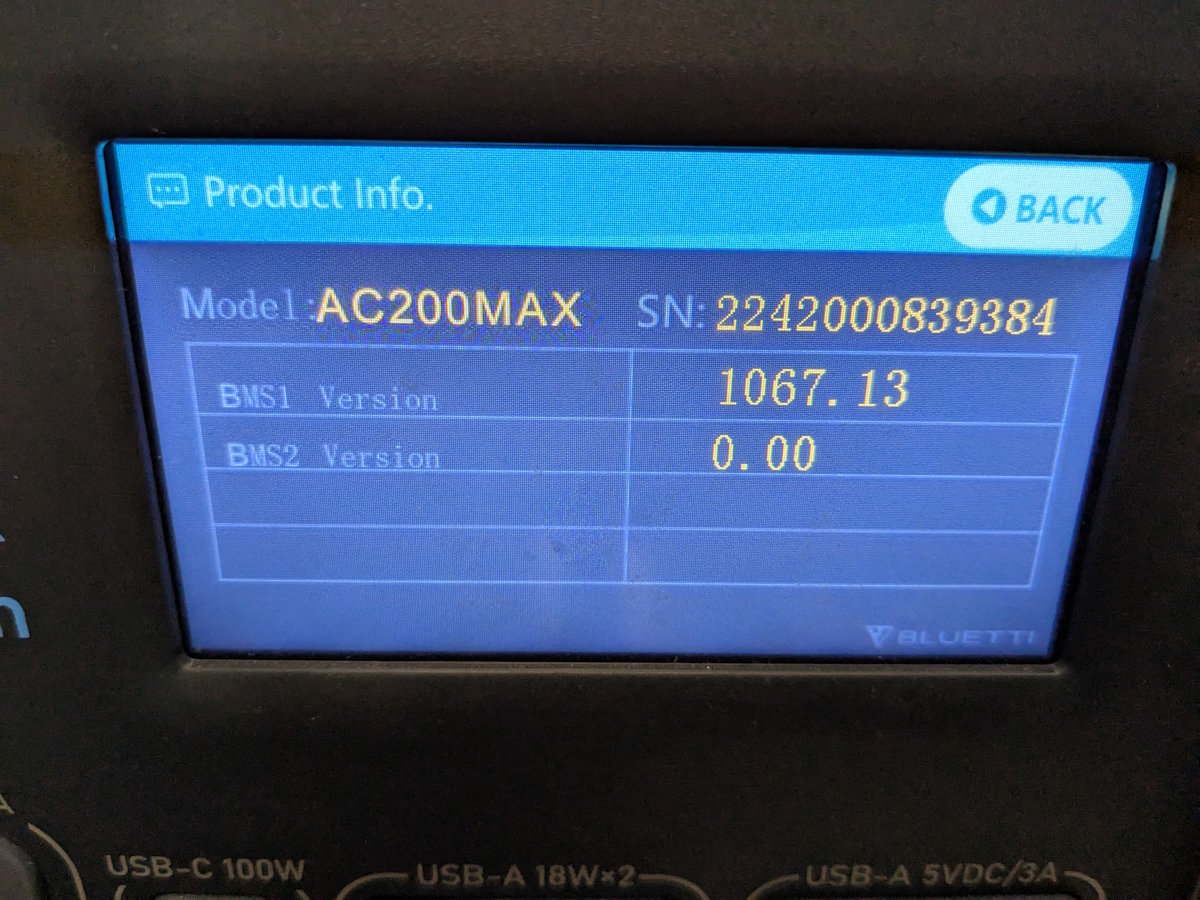

When I see informations of “procuct info”, I can see “BMS2” but with value “0.00” (while my AC200MAX is showing “1021.06”).
But if you are sure I don’t need to upgrade firmware of my B300, it is not a problem. Effectively it works very well within my AX200MAX.

Effectively, I can see BMS2 infos but it displays value “0.00”.
If you are sure that I don’t need to upgrade BMS version of my B300, ok I will not do it.

I plugged a B300K into my AC200MAX and it does show the BMS version under DATA / PRODUCT INFO / NEXT on the unit. See picture.
Are you sure the cable is connected correctly because usually it says 0.00 if the battery is not connected or if the lock is not engaged? So please check the cable connection and make sure you have engaged the cable lock switch at both ends and check again.
