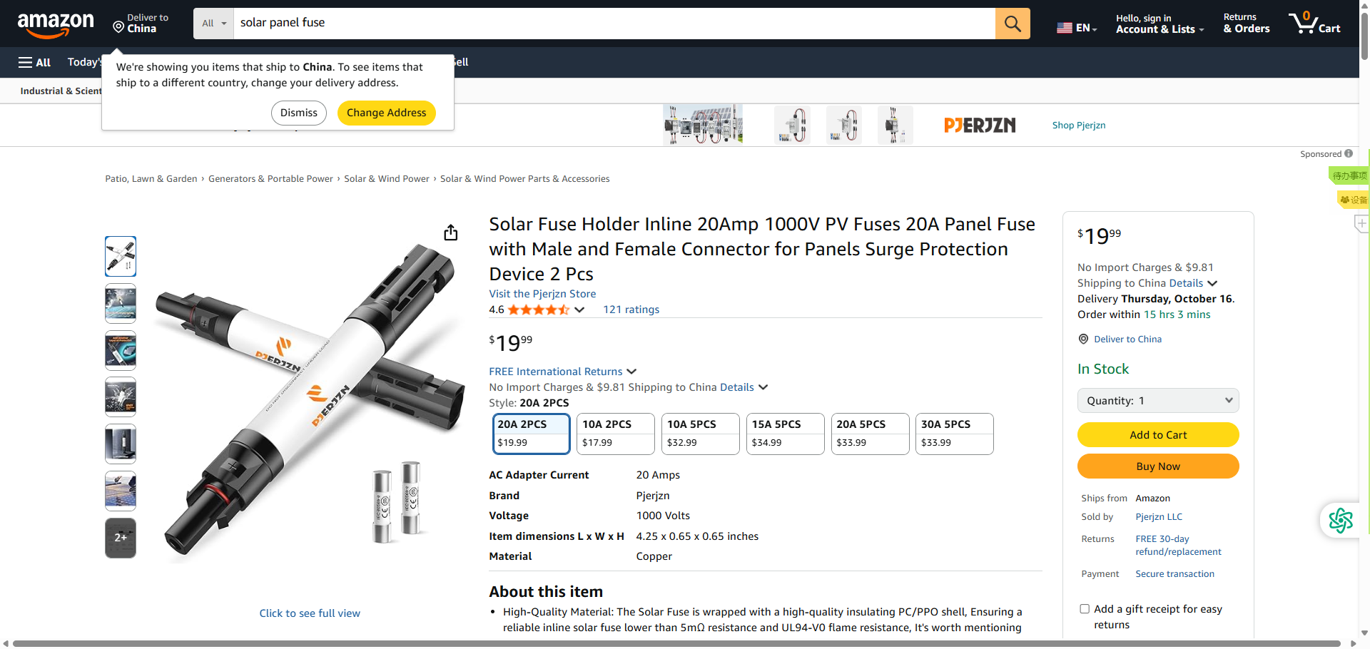

So the question is, does this sound like it will work? And if so, where should I put fuses in the system to make it safe? Should there be a fuse on both strings before they enter the Bluetti (one on each string) to protect the shaded panel string, or should I put a 15 amp fuse after the two strings join together before it enters the bluetti to prevent it from going over 15 amps?
In theory, it would not ever go over 15 amps if I’m truly getting shade on one string while the other is in full sun, but I want to make sure I’m still safe with fuses incase that were to ever happen mid-day (unlikely).
