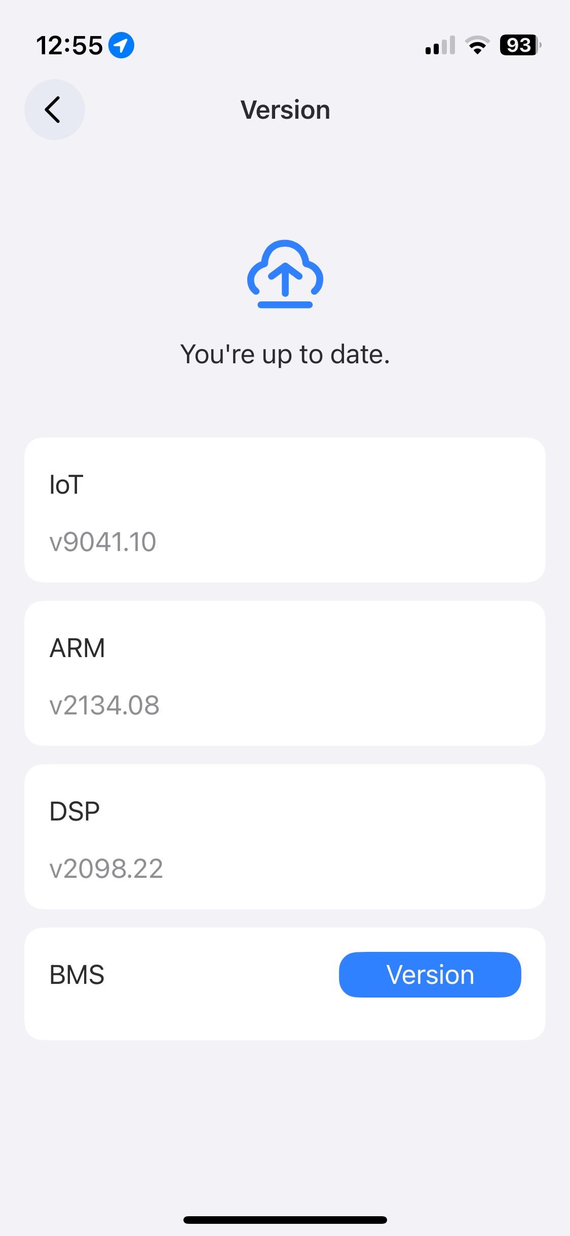

How do I know if I am running the latest firmware? Do I need to download and if so, how do I do that? What is the updated firmware version #? My version screen lists the following:
IoT: v9041.10
ARM v2134.08
DSP v2098.22

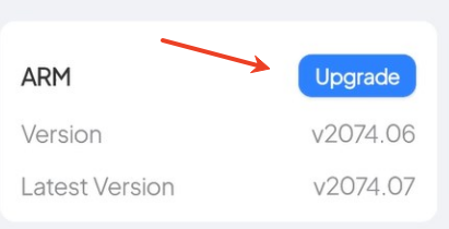

Hi @mbrausam, When you see the blue “Upgrade” button on your firmware update screen, it means a new firmware version is available. Generally, upgrading the firmware is the top-priority solution when issues occur with the power station.
Thank you for providing the firmware version. However, our latest ARM version is currently 213407. Could you please confirm if the version you provided is correct? It would be best if you could share a screenshot of the firmware information.

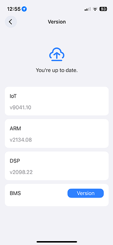

Screenshot as per your request. Screen indicates I am up to date. A 1500 watt space heater and coffeemaker both work fine with AC200L. Thanks. Matt
@mbrausam If I’m not mistaken, the upgrades only show up for the AC200L when connected with bluetooth, and will not show up when connected with wifi.
