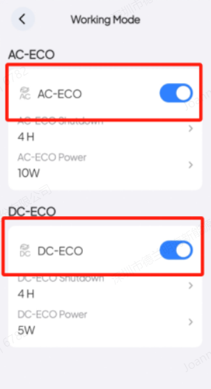

Hi @wynnyelle, We would like to know if you have already bound the Bluetti app. Please log in to the app and check whether the ECO mode has been turned off.
When the ECO mode is enabled, the AC200L will automatically shut down at regular intervals if the load is too small. If you don’t need this function, please turn off the mode.
We have attached a screenshot for reference.
Thank you for the reference pics. No, I do not have the app. I only have a dumb phone, and was told that use of the app is optional with Bluetti (one of the reasons I went with this brand). Is there a way to check for this outside of an app?

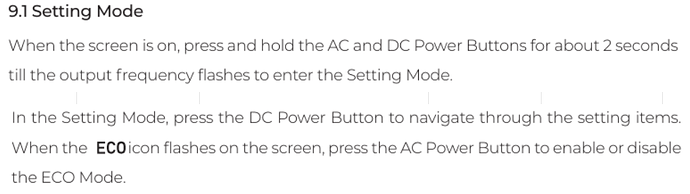

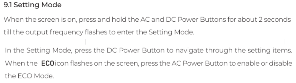

Hi @wynnyelle, Yes, you can switch the ECO settings via the AC/DC button on the AC200L’s body.
Please refer to the screenshot of the manual below. We hope this helps.
