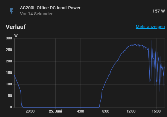

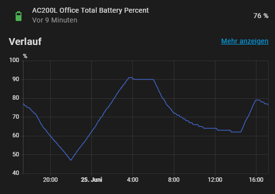

@BLUETTI_CARE i did some testing. Basically the recalibration did something. The balancing is now not so far off anymore. However: the discharge is still a thing.
I attached my monitoring chart for comparison.
At around 10pm I start charging to around 90% which is reached at 03:40 am. At 6 am the charging window closes so the SoC is falling again. At around 8am the sun is kicking in and you can clearly see a flattening of the discharge which bottoms out at around 62% until another charge window opens at 2:30 pm until 4pm.
Basically: The solar input only stops the SoC to fall below 62% which is not bad.
But: the max power input was around 275W as you can see in the chart above.

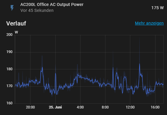

The power draw from AC output was pretty constant with very tiny peaks that should not matter further.
If I do a rough math: 275W - 175W = 100W. If the net consumption of AC200L + B300k is 18W + 5W = 23W there is still a gap of 77W which seems to have no effect at all. At least not from what I can observe so far. I would expect that the SoC at least climbs 1% within 6h of sunlight but so far there is only a bottom out. Maybe the MPPT circuit has a bigger loss than 9%?

From the screenshots you provided, the solar input power seems unstable. Could this be one of the causes?
If you use AC charging, will the test results be different?
Hi @BLUETTI_CARE,
since I live in Germany it is quite normal that solar input is unstable. We often get clouds in the south west. With charging window I meant AC input. I can not charge with solar alone at the moment. But: even when solar input is constant the difference of 100W is not enough to charge the battery. It seems that there is a loss that is unknown. AC charging is stable. I should check how the battery behaves when I charge with 1A only.
