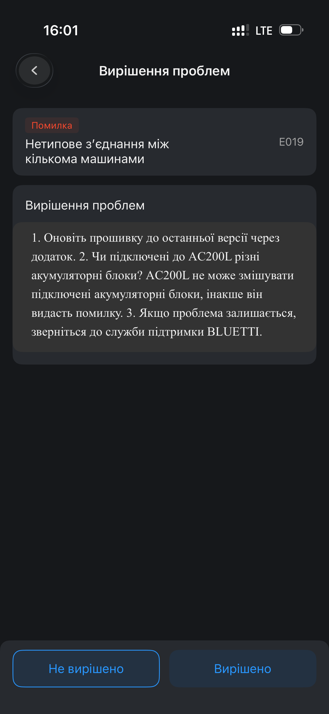

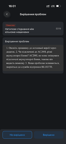

AC200L + B300 + B500K (chained via two P090A cables): does not work. AC200L shows error E019 on the screen and in the app, the B500K has an empty Model field (“–”), and firmware update fails with “The device code is empty.”

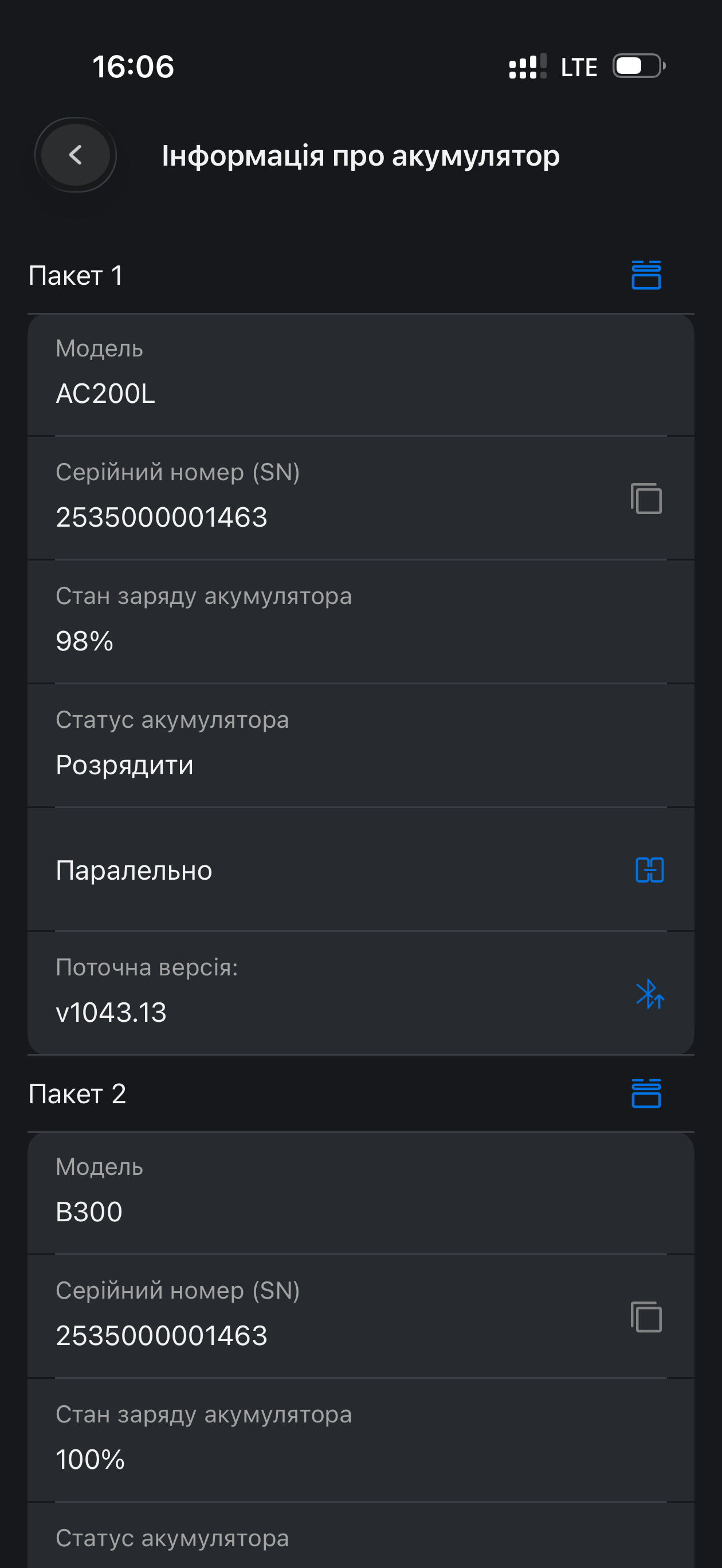

  1. AC200L + B300 only. Works without issues. B300 BMS v1021.06, Model field populated, no error codes.

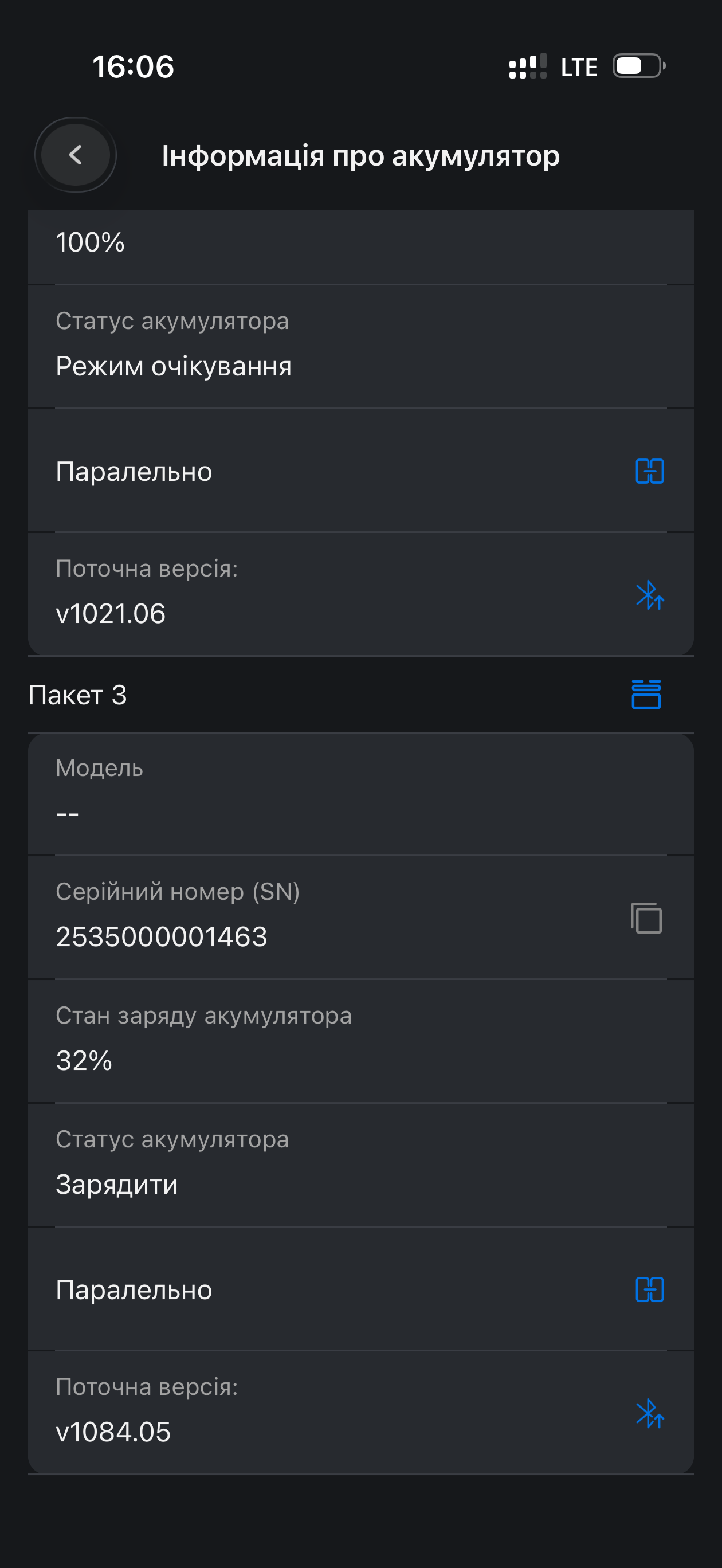

  2. AC200L + B500K only (single P090A cable, known-good cable that works fine with my B300). B500K charges and discharges, SoC and status come through correctly, BMS version v1084.05 is reported. But on the Battery Info page the Model field for the B500K is empty (“–”). Attempting Firmware Update for the B500K returns “The device code is empty” and the update cannot start. The AC200L clearly talks to the B500K on the BMS level but does not have a model identifier for it. No E019 in this setup.
  3. AC200L + B300 + B500K (both chain orders tested: AC200L → B300 → B500K, and AC200L → B500K → B300). The in-app description of E019 says:
“Non-typical connection between multiple machines. AC200L cannot mix connected battery packs.”
Same E019 either way, same empty Model field for the B500K.

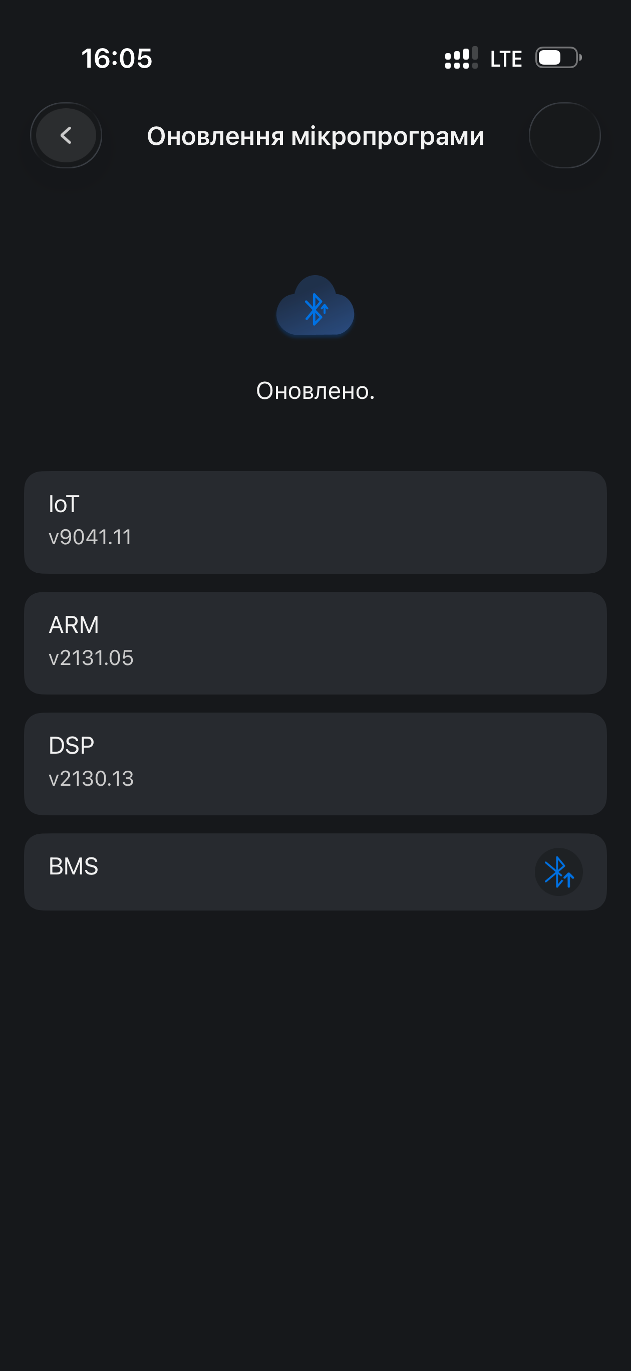

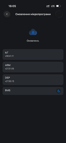

AC200L firmware is the latest per the app: IoT 9041.11, ARM 2131.05, DSP 2130.13.

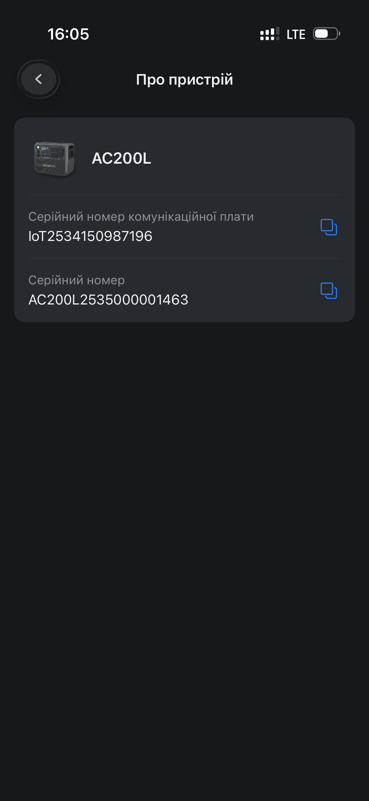

AC200L SN: AC200L2535000001463
IoT SN: IoT2534150987196
AC200L BMS: v1043.13
B500K BMS: v1084.05 (Model: “–”, update error: “The device code is empty”)
B300 BMS: v1021.06 (works fine on its own with AC200L)

Hi @VolodymyrUkr, thank you for getting in touch with us.
We have been in touch with you via email and the Facebook community, pushed the latest firmware to you, and received your feedback that the issue has now been resolved. Is that correct?
Please don’t hesitate to reach out to us if you need our help.
Hi @BLUETTI_CARE,
Yes, the new firmware arrived, and I’ve successfully updated the ARM version on my AC200L. My setup is now fully operational.
Thank you so much!
