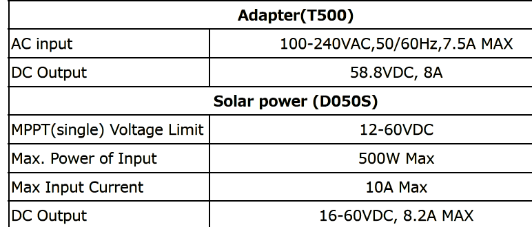

Input specs for B230:

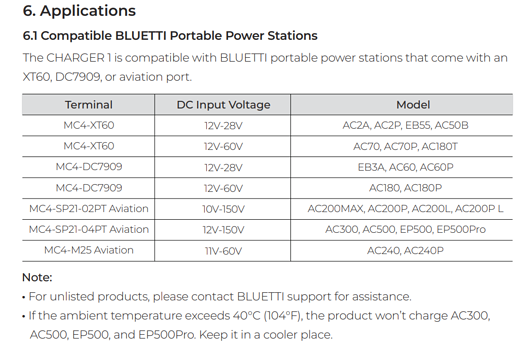

Parameters for using Bluetti Charger 1:

Since I have the Bluetti Charger 1 and four B230s (and four of the D050S), I will ask @BLUETTI_CARE if I can test out the Charger 1 and a B230 using a 12V 100Ah Dr. Prepare battery as the source. I see no reason why it can’t be dialed in to the input requirements for the B230.
Hi @SoulGen , Thank you for that video. I had watched that before I started asking question and did find it interesting. Today I did some experimenting. When I bought my AC200L, Bluetti had not come out with their Charger 1 and I purchased a similar item that was made by Pecron. [PECRON 500W Car Charger DC1242-500 for Cars, RVs, Trucks, etc.] PECRON 500W Car Charger DC1242-500 for Cars, RVs, Trucks, etc. I did not have the proper connection to try it when I was asking the questions, but today I went to Harbor Freight and bought what I needed. When I connect it to the AC200L it turns on and show charging the unit but connecting it to the B230’s 58.8V input and turning on the B230, nothing happens. The power light comes on but the 0 to100 % numbers do not light up or scan indicating charging. Now, I measured the output voltage of the Pecron unit, and it is 42 volts as indicated by my meter. When you look at the input (12-60v) and output (16-58.8v) voltage of the D050S I think my 42v should work. The output of the D050S appears to be determined by the input’s voltage. Not having a D050S to check I would guess if using the 12v car charger cable or 12v lead-acid battery cable, the output is going to be lower than 58.8 volts. So, at this point I think I have a warranty issue to deal with. Again, thank you for you input.

Hi @SoulGen, Thank you for your attention to this matter. We confirm that your 12V battery can be adjusted to meet the input requirements of the B230.
Regarding Charger 1, please note that it is only suitable for car starter batteries—we do not recommend using it with any other types of batteries.
Additionally, even if you use a starter battery, if you connect Charger 1 directly to the 7909 port of the B230, charging will not work due to insufficient voltage. A D050S is required to resolve this voltage issue and enable normal charging.
