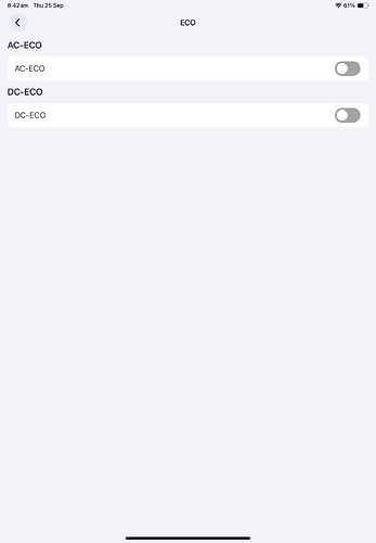

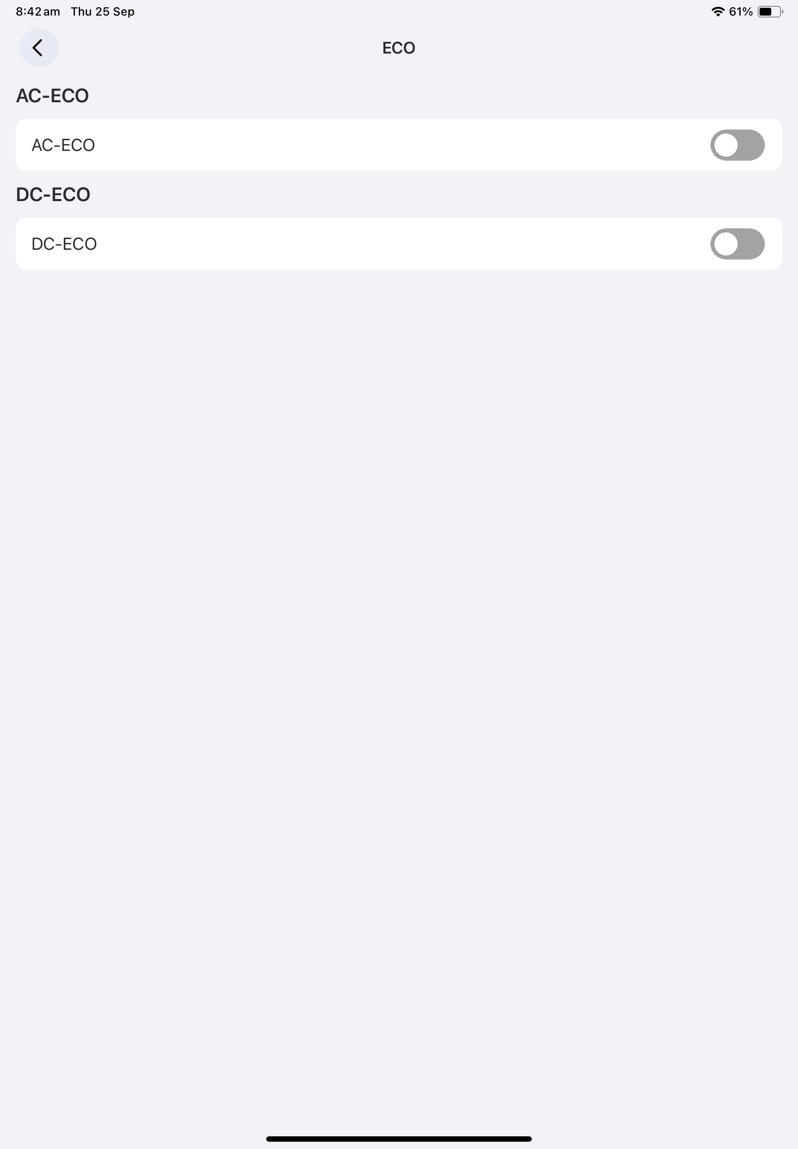

Eco DC: off
Eco AC: off

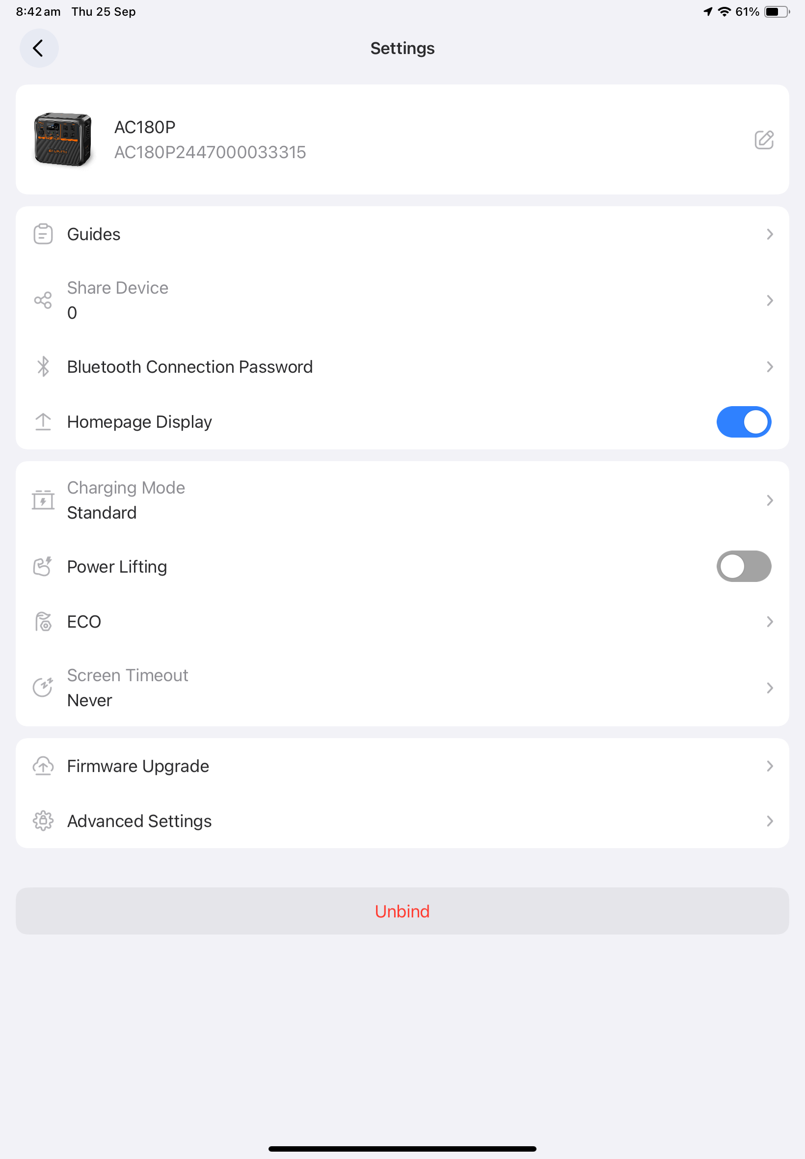

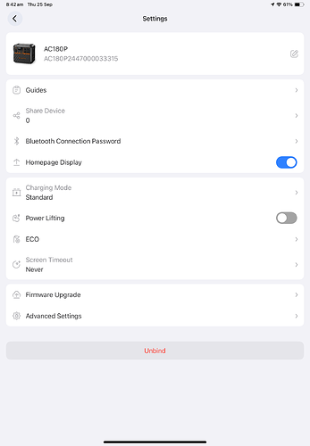

Screen sleep: never
Charging mode: standard

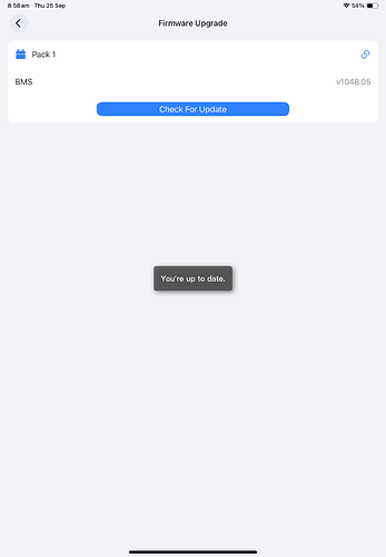

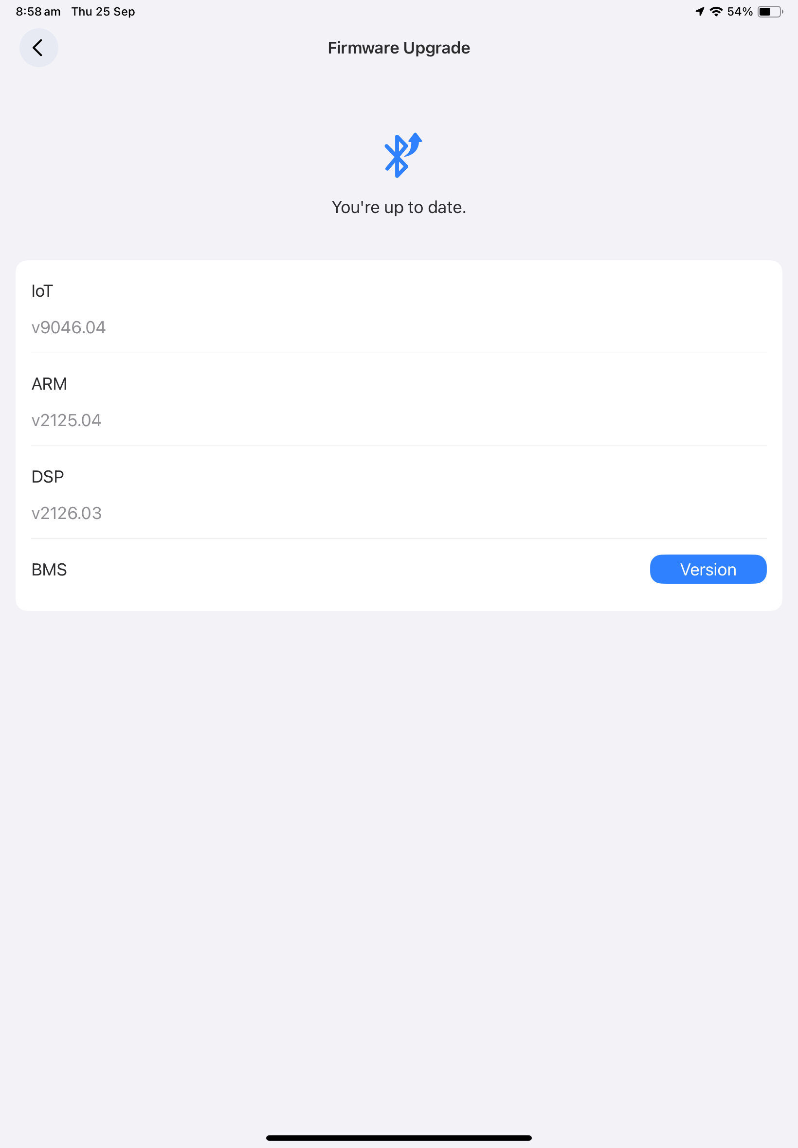

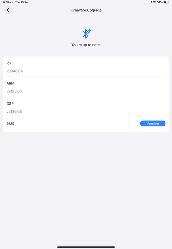

Unit is fully up to date with firmware etc…see pics
