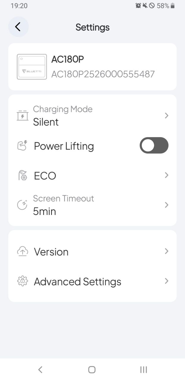

I’m trying to charge my AC180P using a 8000W/220V gas generator, but fail with unstable grid message.
I have enabled Grid Self-Adaptation, and it fails anyway.
Checking the input AC on the app, the generator oscilates between 212 V and 225 V.
As the battery ramps up, the generator tries to compensate but voltage oscilates too much and it fails with a GRID message flashing.
I’ve tried to add a load to stabilize it, but that fails too.

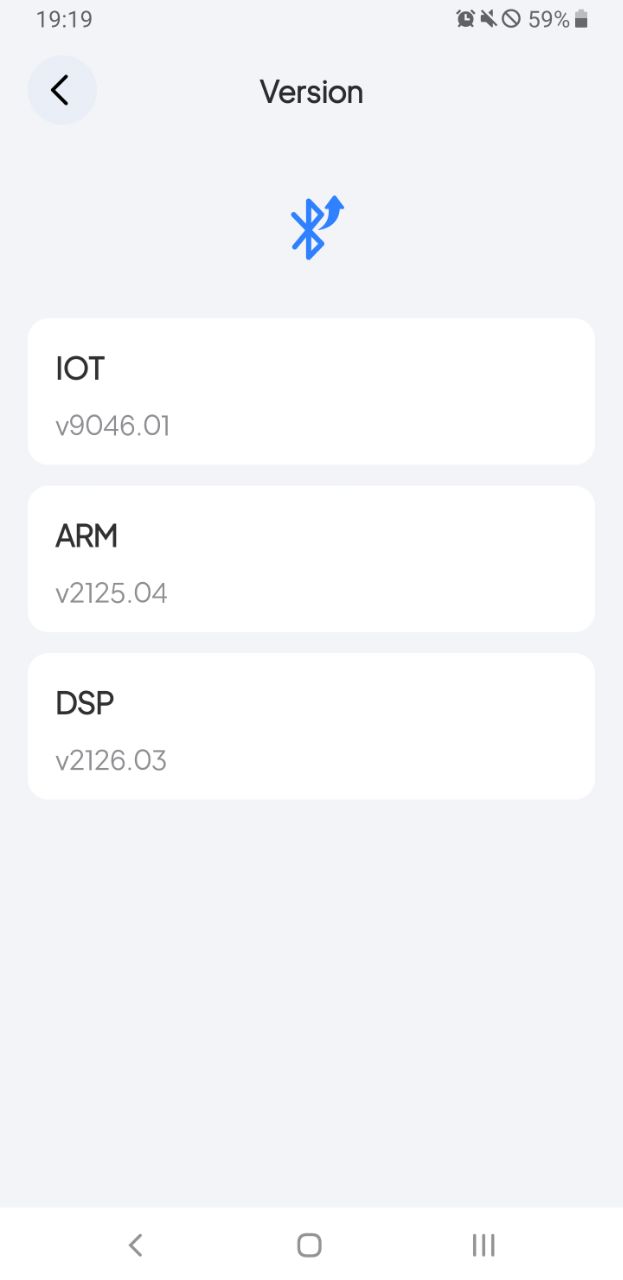

Can you please provide a firmare with more relaxed input voltage range so I can use my generator?
Thomas
