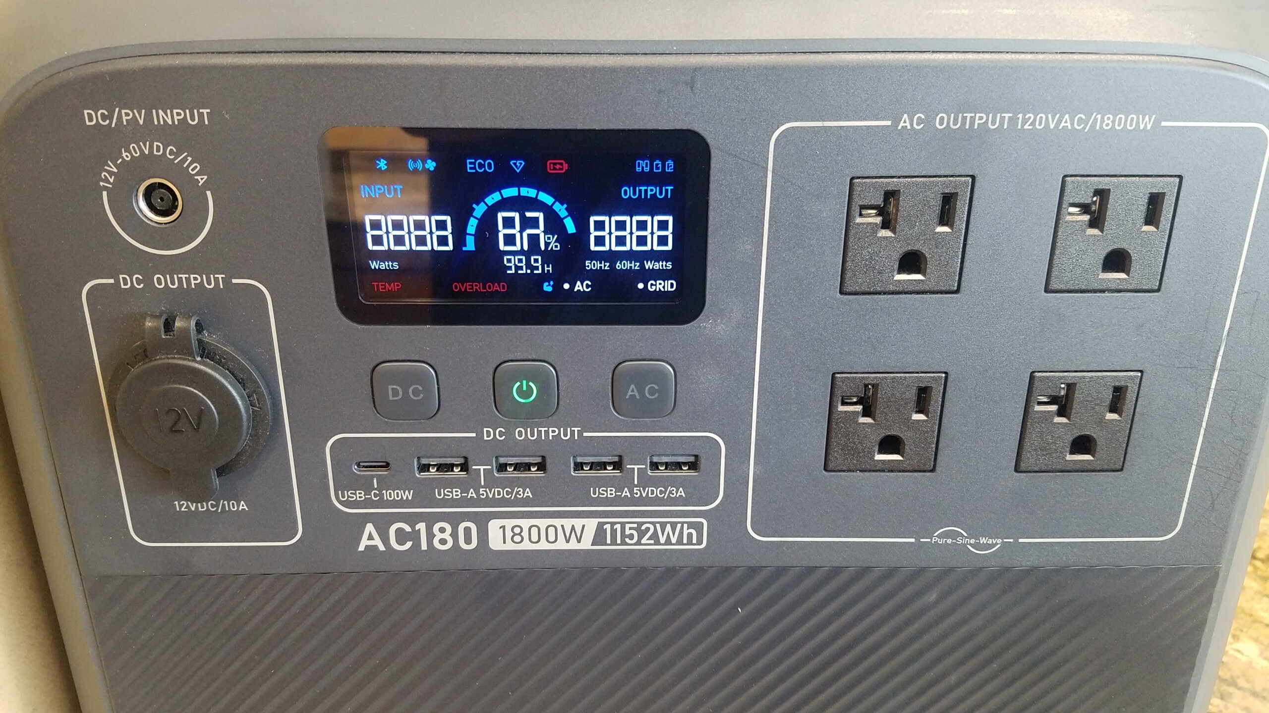

Hi everyone,
Looking for help diagnosing a persistent issue with my Bluetti AC180, which arrived brand new on April 26, 2025 (purchased via Amazon). The unit is displaying multiple red warning indicators on the screen even when there’s nothing plugged in or drawing power. I’ve:
  • Powered it off completely (twice)
  • Left it unplugged overnight
  • Confirmed no external load is connected
When powered back on, the same red indicators reappear immediately.
Additional details:
  • I tested with shore power (AC wall input) — the unit does take a charge, but the red warnings remain.
  • While charging, the screen glitches badly, jumping around erratically and becoming unstable.
  • Once charging is disconnected, the screen stabilizes but stays fully lit with red warnings — no actual improvement.
  • I connected a light load, and the lights powered on normally, even with the warning screen lit.
  • There’s no abnormal power drain — just a persistent error condition with visual instability under charge.
  • Firmware is up to date, confirmed via the Bluetti app.

Hi @warehouse, We’re very concerned about the issue you’re experiencing.
It seems your AC180’s screen showing garbled charates, and restarting it without any load hasn’t resolved the problem — is that correct?
Could you please provide a photo of the screen, along with the AC180’s SN code and current firmware version? We’ll then check if there’s a new firmware update that can fix it.

@BLUETTI_CARE, Please look into this.
Hi @warehouse, We have discussed the issue you encountered, and it cannot be fixed by upgrading the firmware. We would like to arrange warranty service for you.
Please click on my profile photo to contact us via private message, and let us know your order information and email address so that we can make the arrangements for you.
