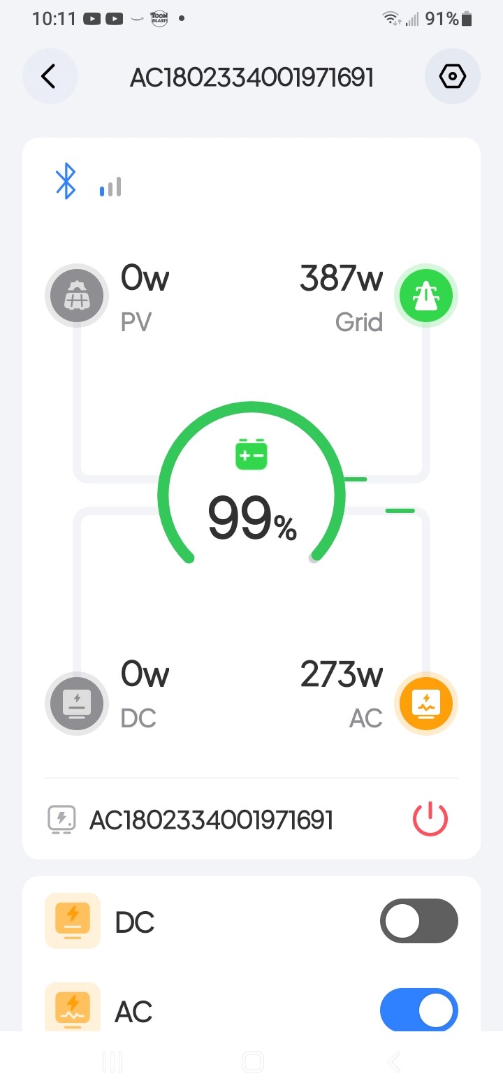

I have an AC180 that I am trying to at least temporarily use it in a way similar to a computer UPS for an always on server that draws around 150 to 175W total. My APC unit failed a few days back and I swapped in the AC180 for this. Anyways I see it’s constantly charging at around 300W with a 175W AC only load and the charging is making negative progress meaning it slowly discharges over days. If I turn off the server removing all but 39W of the load it will switch to charging at around 1KW and this will cause it to charge fully. It’s set to normal mode charging and I have no PV or battery input.
Edit: Interestingly the second the one server shuts down the charging starts at a reasonable rate and > 1KW. I have 2 PCs connected to the AC180. The workstation is off unless I am using it. A few minutes ago I shut the server down with the workstation up and the charging instantly started even though I am currently using over 140W. I will have to do some more testing including starting the server while its charging. It was down to around 48% left and a few minutes later with the server off its over 59%. The server has an EVGA 1000W supply while the workstation has a Seasonic 850W or so.
Edit2: The second I pressed the power on the server the Grid power went from 1.3KW to 400W and the AC output went from 140W to ~290W. The battery was 63% at that point. Also I have tested ECO mode on and off. charging mode from normal or turbo. I have tested power lifting on and off. None of these settings seem to help.

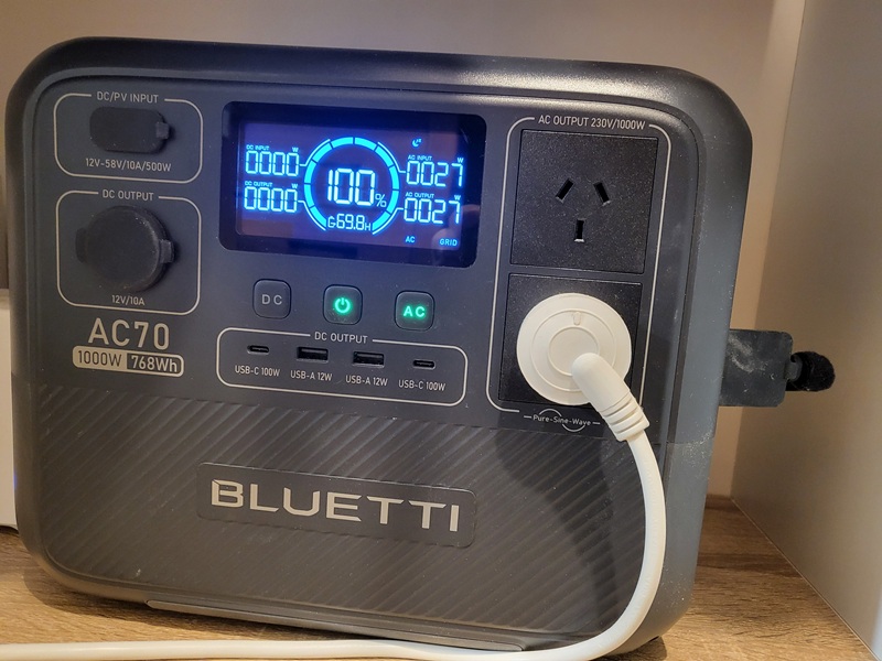

I have an AC70 which is connected to my Fibre optic input to the home, the WiFi Router and the home security camera WiFi/recorder. It has been operating like this for over 6 weeks to date.
The load shows 27W Grid input and 27W AC70 output, which = 100% pass through. Battery at 100%. I don’t check it often, but have seen capacity briefly drop to 99% and a very brief charge from the grid of around 275W. This is the approx charge wattage of the AC70 when set to silent mode charging. As I’ve mentioned in other posts this is probably due to the internal smart charger briefly checking the battery’s SOC. I have other chargers that do the same including, but not limited to, Redarc and Victron.
The AC70 is set to Eco mode = Off, Grid Self-Adaption = Off and Silent charge rate.

I finally did a test to isolate the issue. I ran AIDA64 and FurMark to load the workstation to over 300W of usage with the server in sleep mode. In this configuration I don’t have the problem at all the AC180 works perfectly. So it seems that for some reason the EVGA 1000 G2 power supply on the server is causing the AC180 to have this issue.
I have tried it in charging mode Standard or Turbo each with or without power lifting enabled. The same behavior exists in all modes when the problematic server with the EVGA 1000 G2 power supply is powered on and not sleeping. When its sleeping there is no issue at all.

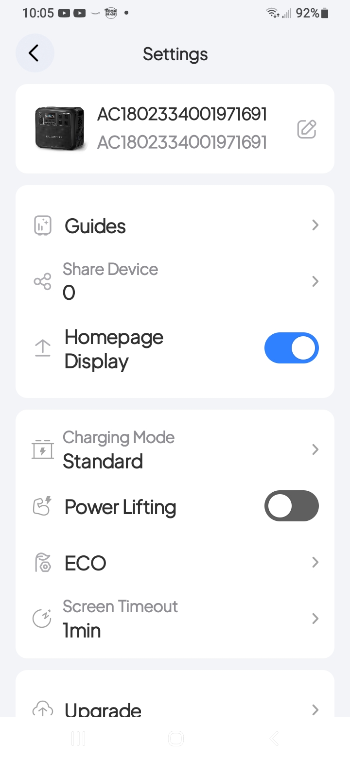

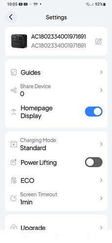

I just turned the server back on and I will attempt to get a picture of the behavior once it goes into charging mode. I did grab a picture of the settings.

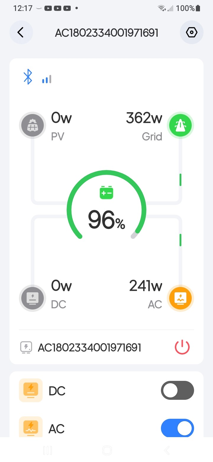

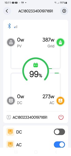

I have added 3 screenshots. The 99% percent image was taken about 2 hours before the 96%. The AC180 is plugged into the grid the whole time. There is no DC load or PV input. Also there have not been any power interruptions at all. I live less than 1 mile from the substation so my power is usually very stable.

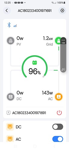

Just now I put the server wirth the EVGA 1000 G2 power supply to sleep and just after it got into sleep mode the AC180 started charging. I added 2 more pictures that show the charging. The second picture was taken a few minutes later when I retested loading the workstation with FurMark and AIDA64.
By that time the charging had already got to 99% and continued charging. In all the testing done today I made no changes at all to the settings. Also at this time the battery is at 100%. I kept the server sleeping.
