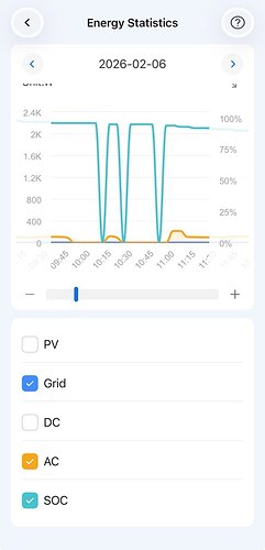

@BLUETTI_CARE I’ve been using my new Bluetti Elite 200 v2 for a few days and I think I also encountered a similar issue to the one described in the post. The power delay seems to be quite significant, as my fridge compressor stopped very loudly during this and I’m concerned it may damage it if it keeps happening. I also noticed that in Energy Statistics graph SOC briefly goes to 0 and then back to the original value when this happens. Attached the screenshot.
Is this a known issue in Elite 200 v2? The app says I have the latest firmware at the moment.
