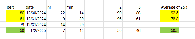

This is the data charted in Excel. Nothing was being powered other than AC is on.
I did reconnect the batteries during this period because the display dropped down to 50% from near 100%. When the connections were moved to different ports the reported value changed on the main screen to a higher value. There seems to still be excessive power lost when nothing is being powered and AC is on. Also there seems to be some problem with the ports as changing where things are plugged in should not changed the home screen SOC value. This is not a good condition. Below are the pictures of the screens.

We’ve reviewed your data table, but the timing isn’t entirely clear. For example, in the first row, “22hr 14min,” is that the recorded time or the runtime with AC on?

  1. I recorded the date and time of the values display. That is the 22hr 14min time you show. You can see this from the pictures.
