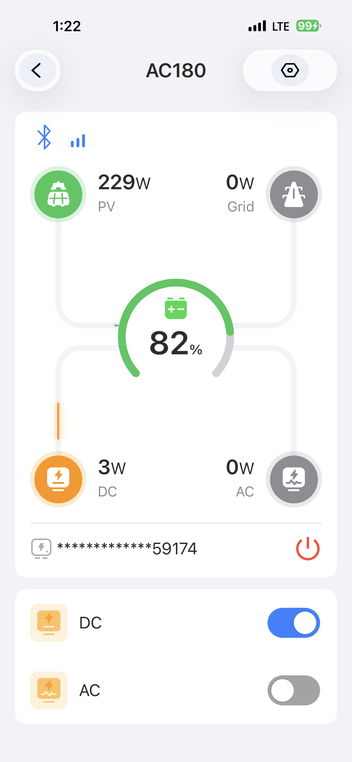

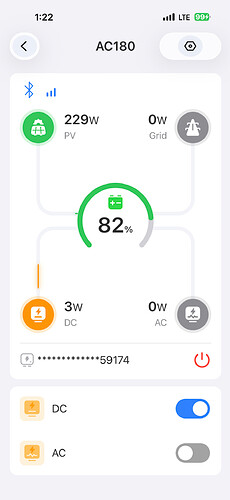

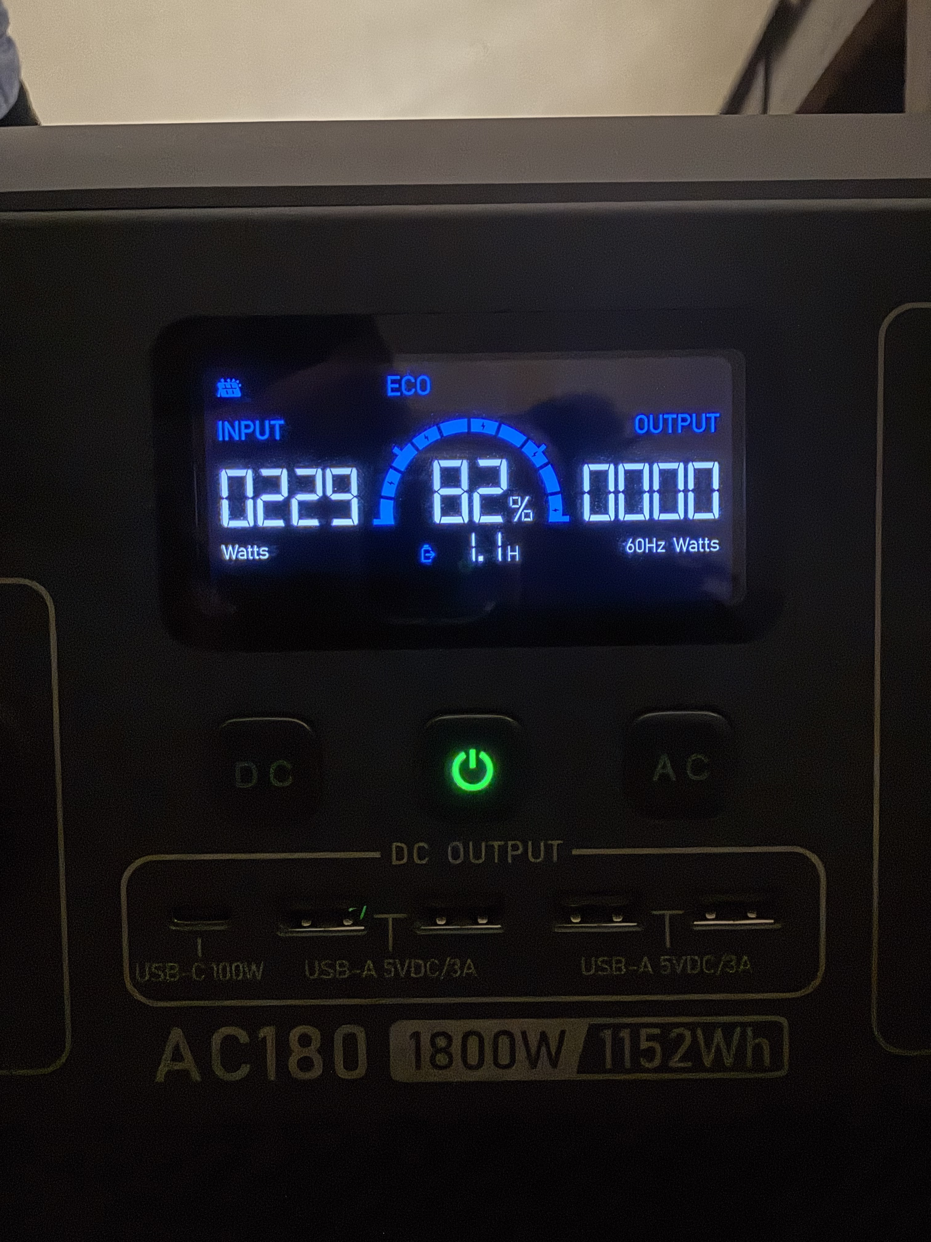

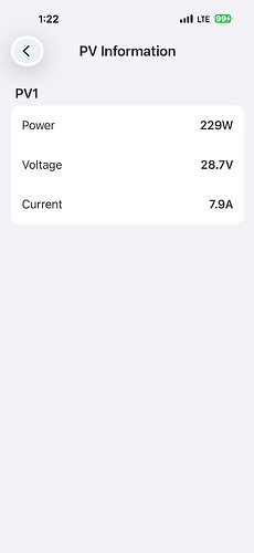

Hello everyone,
Just wanted have a much better explanation about this. as well wanted to know if it’s normal cause something seems not right.

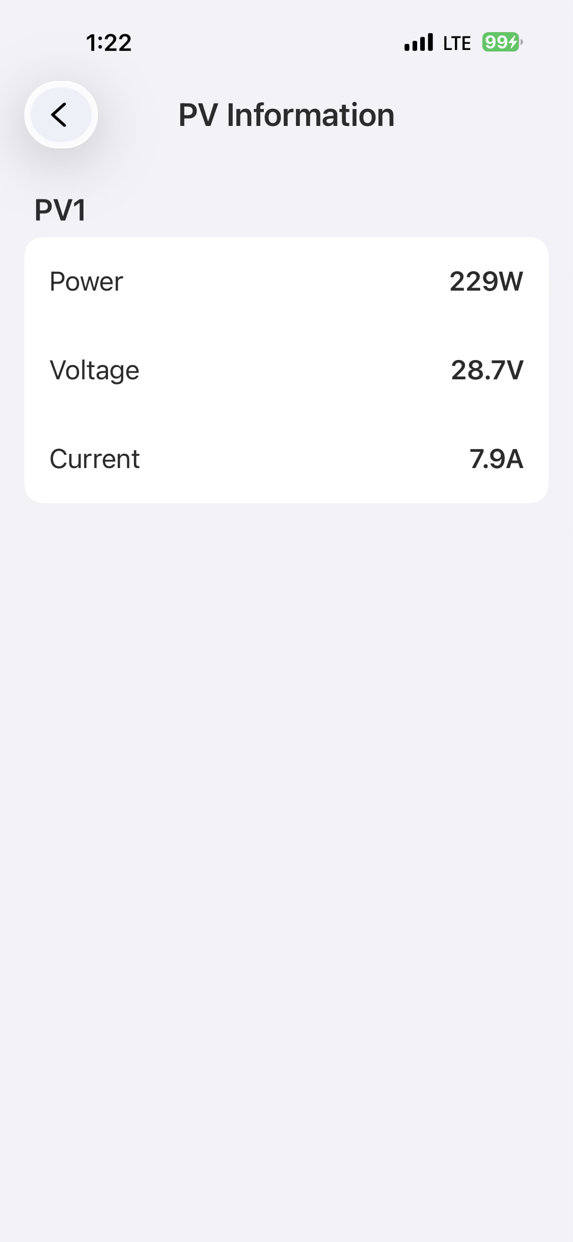

Have a 500Watt Solar Panel, on direct head sun around 1:00 PM (Haiti Time) we have plenty of sun. I know already that i won’t have the full 500watt, but at least i should expected to be around 300watt or almost 400watt when we
GREAT SUN.
the last peak i get from that great sun is 230Watt.
Can you give help me with this… I know i should get more wattage at great sun… not expected to be 230watt max from a 500watt Solar Panel…

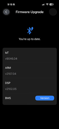

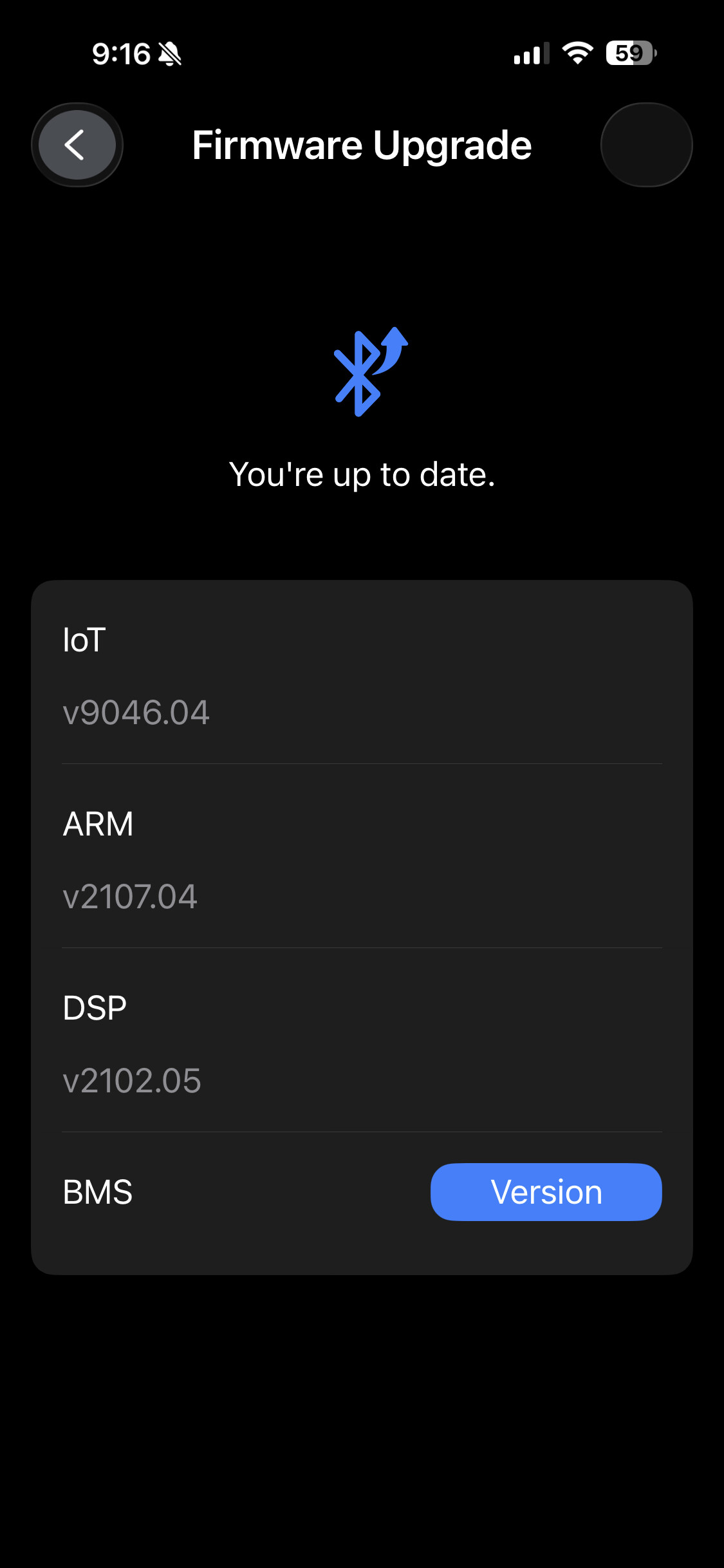

also need to downgrade, IoT, ARM, DSP as well… i found out it worked much better the last i just clicked update for these two options… the BMS is fine… just these.

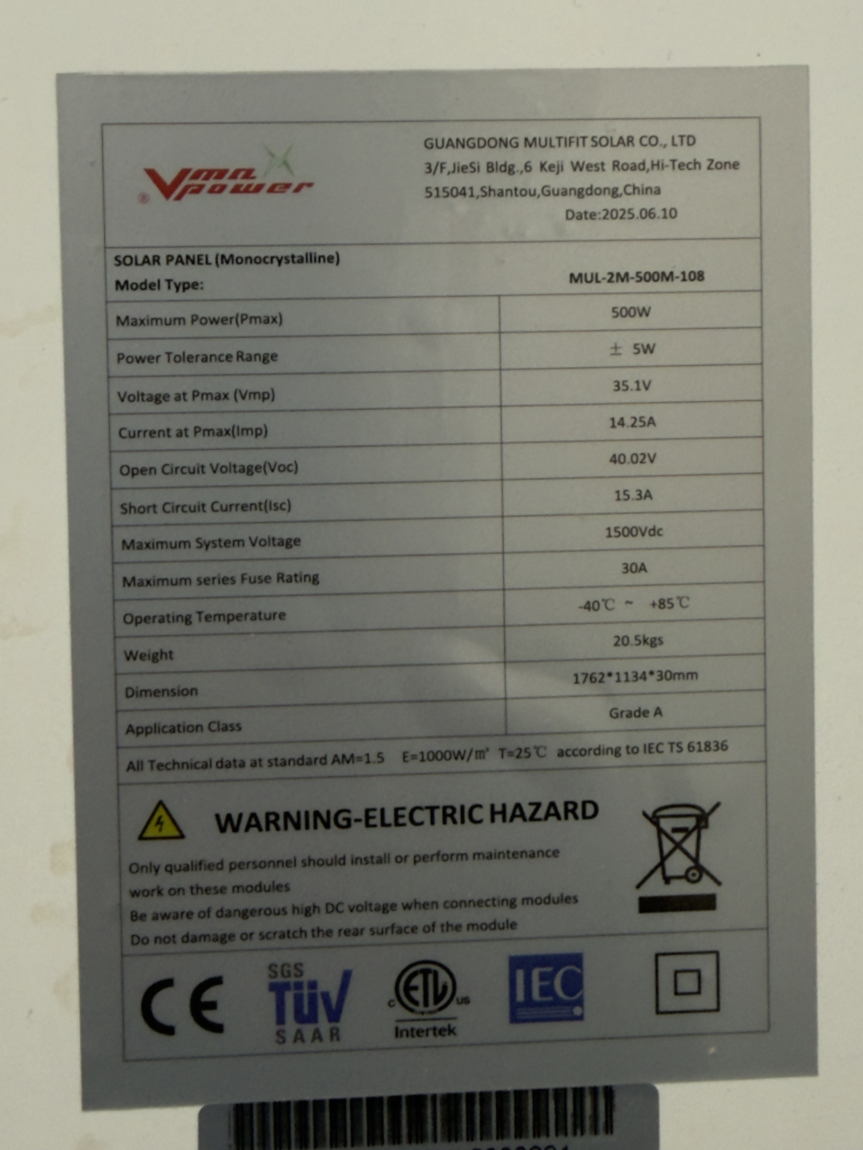

Answering your question: There are several factors that can prevent your solar panel from delivering 500 W. The values on the sticker at the back of the panel are determined by the manufacturer under specific testing conditions. You can find these exact conditions in the manual or on the manufacturer’s website. Therefore, the likelihood of actually reaching 500 W in real-world conditions is very low.
However, there are some things you can adjust to maximize your panel’s performance:

Calculation for the distance from the panel to the power station
When connecting a solar panel to a power station, the cable length affects voltage loss. Because current travels through both the positive and negative cables, you need to double the cable length in calculations.
Voltage drop (V) = Current (A) × Cable resistance per meter (Ω/m) × (Cable length × 2)
Example using your solar panel specs:
  • Panel short-circuit current (Isc): 15.3 A
  • Cable thickness: 6 mm² (10 AWG, copper)
  • Cable resistance: 0.005 Ω/m (typical for 6 mm² copper)
  • One-way cable length: 10 m → total circuit length = 10 × 2 = 20 m
Voltage drop = 15.3 A × 0.005 Ω/m × 20 m = 1.53 V
If your system voltage is 35.1 V (Vmp), this is a voltage drop of 1.53 V / 35.1 V × 100 ≈ 4.36%, which is higher than the recommended 2–3% range. For longer distances or higher currents, a thicker cable would be required to stay within the recommended limit.
Conclusion
At this time of year, achieving 200–250 W is reasonable. By ensuring the panel is fully optimized, you may be able to achieve slightly more power.
Hopefully, this answers your question.
