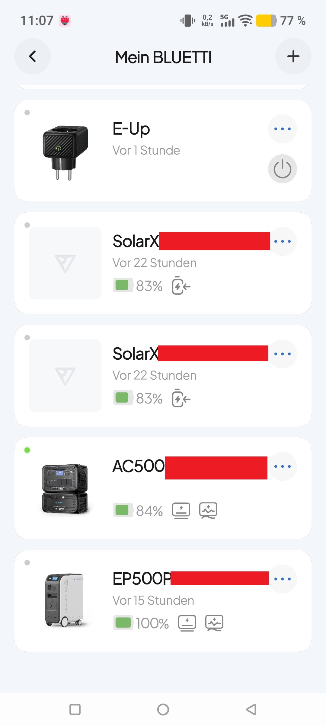

I can confirm, that this setup will work.
I have AC500, 5x B500K, 1x B300k, 2x SolarX 4K
The 2nd SolarX 4k replaced my D300S Drop-Down-Module because of it’s loud noise.
Perfect! Thanks a lot for your feedback and help!
I also replaced the D300S :slight_smile:
I hope that two SolarX4k will particularly help during winter period.
