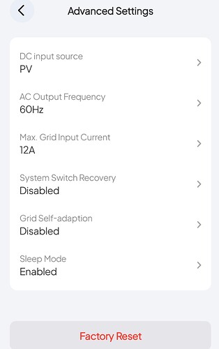

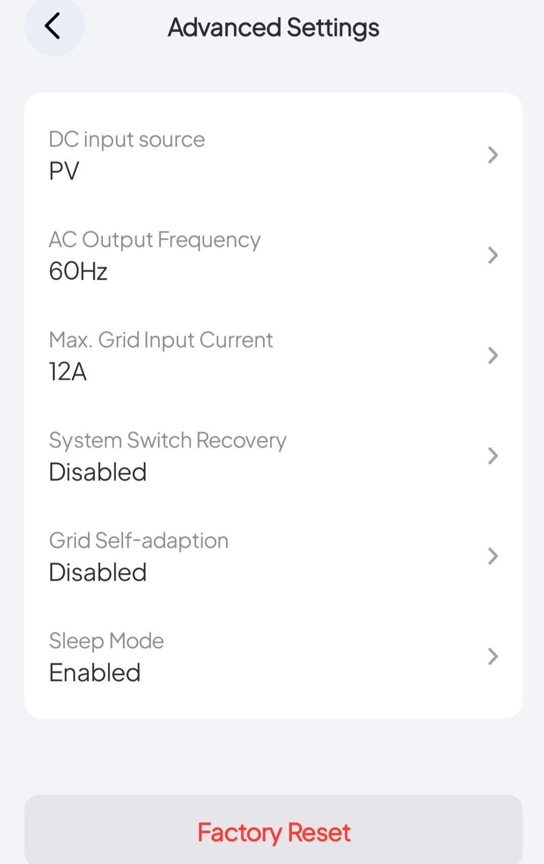

I just opened the app after seeing your reply and saw that the “sleep mode” option is already there so I enabled it. The unit is being recharged from the grid so I’ll try it after it’s done.

@BLUETTI_CARE Thank you! It worked as expected! Excellent!

  • When SLEEP MODE was enabled in the app, you can’t turn it off by holding down the power button. When I held down the button, it said “SLP” and went back to sleep. However, when I kept holding the button after ‘SLP’ showed up, then the ‘OFF’ showed up and powered off completely.
  • I could only turn it off completely from the app. From the app’s ‘POWER OFF’ button, when clicked, it asked if we want to ‘SHUT DOWN’ or ‘SLEEP’. There is no such option when holding down the POWER button on the unit.
  • After it went to sleep, the green LED on the POWER button on the unit turned off too. Had to wake it up either from the app or by pressing & holding the POWER button for a few seconds (see above).

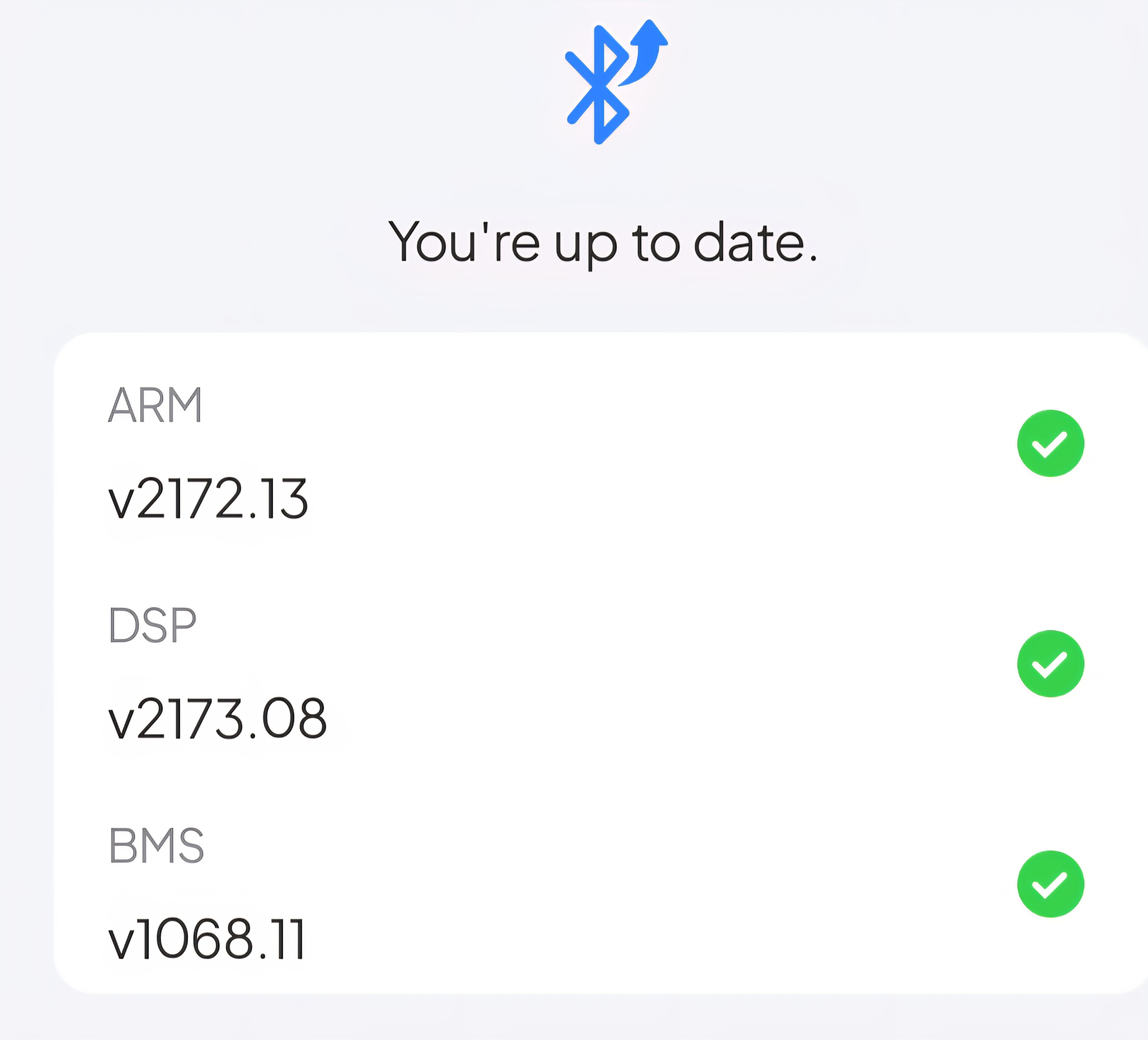

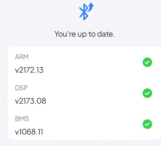

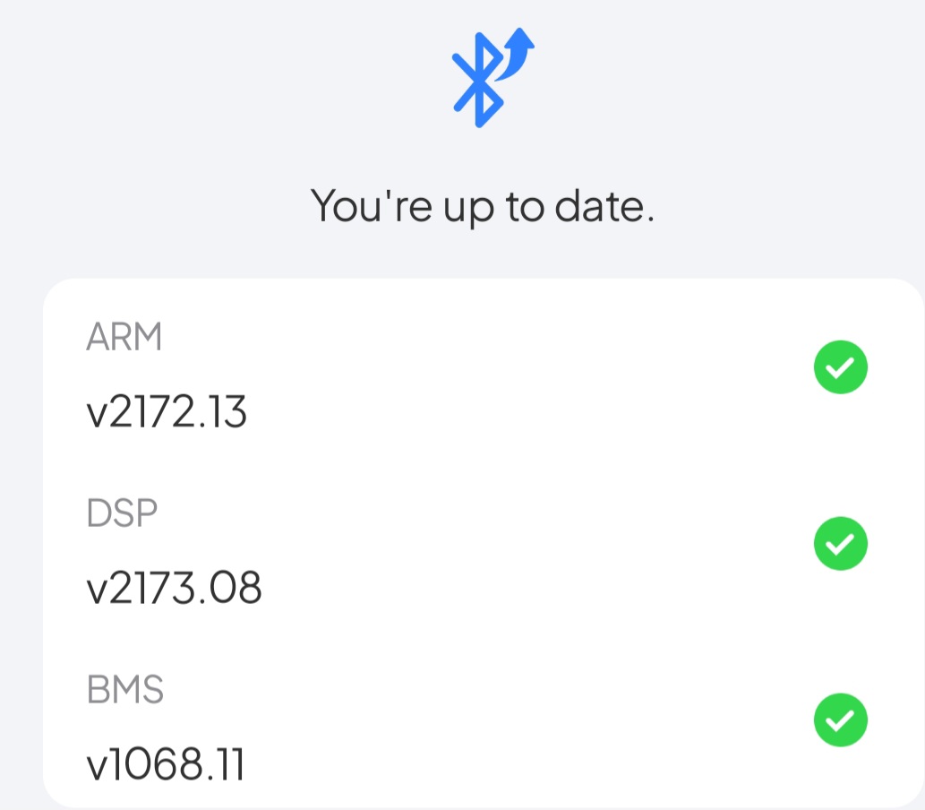

Do I have the latest firmware version for my 200V2?

We have checked and found that your firmware is already the latest version, so there is no need for further upgrades.

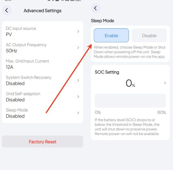

Hi, I do not see this option for my 200 V2?
That’s weird. I have the SLEEP MODE option and my firmware is even older than yours!
Saw that yours is 50 Hz but that shouldn’t matter as we all have the same hardware.
Could it be this only functions over wifi? I can’t test it on the road.
