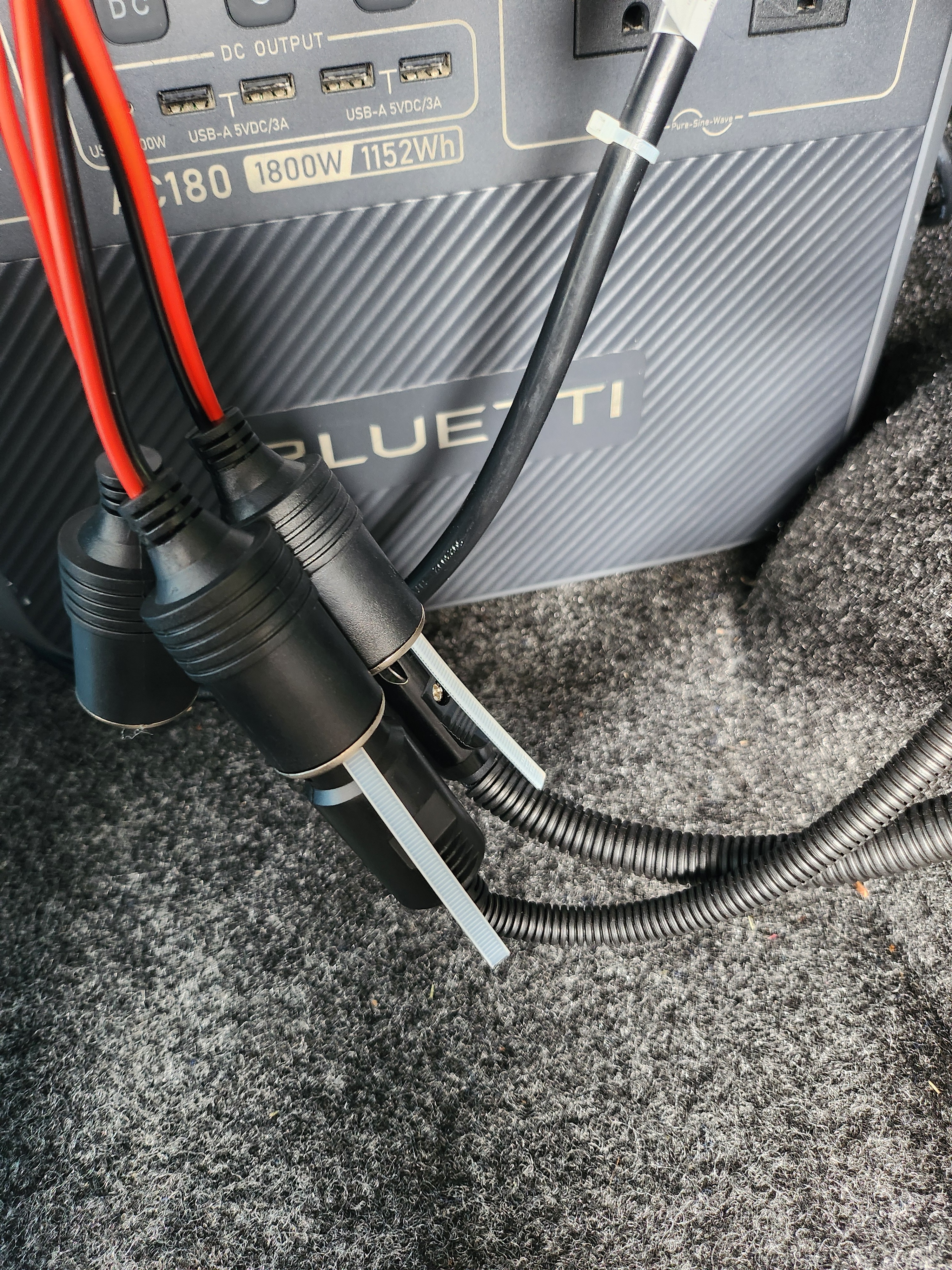

For my setup I found that a zip tie to fill the gap in the socket creates a secure connection for my lights, fan, and 12V fridge in my Moonlander. The 3 way adapter I use is a Chinese generic brand called “Unique Bargains” from Walmart. I tugged on adapter to feel how loose it was before and after applying the zip tie hack. I could definitely feel the difference, atleast in my specific combination of adapter/sockets. You’ll notice that some adapters work better than others. For example when I purchased my AC70 recently the out of the box 12V to XT60 adapter it comes with actually fits in very nicely into the socket without any modifications needed. It’s the third party sockets with varying sizes you have to accommodate for.
thanks, i’ll try the chunk of zip tie!

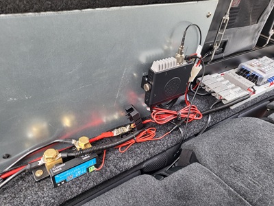

I managed to find some pics, not quite up to date as other mods since these were taken.
This is the setup for using Charger 1 to add to any of my power station’s capacities with an extra 1,280Wh.
7 POWER
I made up this board with an input from the AUX battery and 6 individually fused Anderson outlets, which can serve as power out and solar or AC powered charging IN. It sits behind the fridge slide, fridge not yet installed.
8 SHUNT
The whole system is monitored via a Victron Smart Shunt. This is where I have since modded. An extra 60A fused outlet to power the Charger 1 (Anderson plug to use the small lead shown in the first photo.)
4 UHF
Also where I mounted my UHF base unit, as the Mic has all the controls at the driver seat. The battery is where the Blue Anderson is in the above photo and is a slimline LFP on the side of a drawer.
I have a 12V oven in the 4x4, the Engel, LED light with Anderson that are powered from this board. It is also used to plug in an on roof solar panel and can be used with additional solar mats. Not shown is a heavier Anderson fused lead that powers the Charger 1 when in use.
