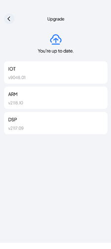

The serial number and current firmware are in the attached printscreen from the BT app
Hi @PaulLacatus, Thank you for getting back to us so quickly.
Now I have applied to upgrade your system to our IT department. They will push the latest version of firmware to your unit in 24 hours.
Please let us know if the new firmware works.
Just Updated the firmware . Right now looks like working ok let’s see in time
