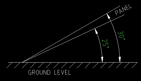

My panel angle should be 35 deg, your angle, due to being nearer the equator, is 25 to 30 deg as this diagram.
ANGLE
It’s 30 deg from ground, not the wall.

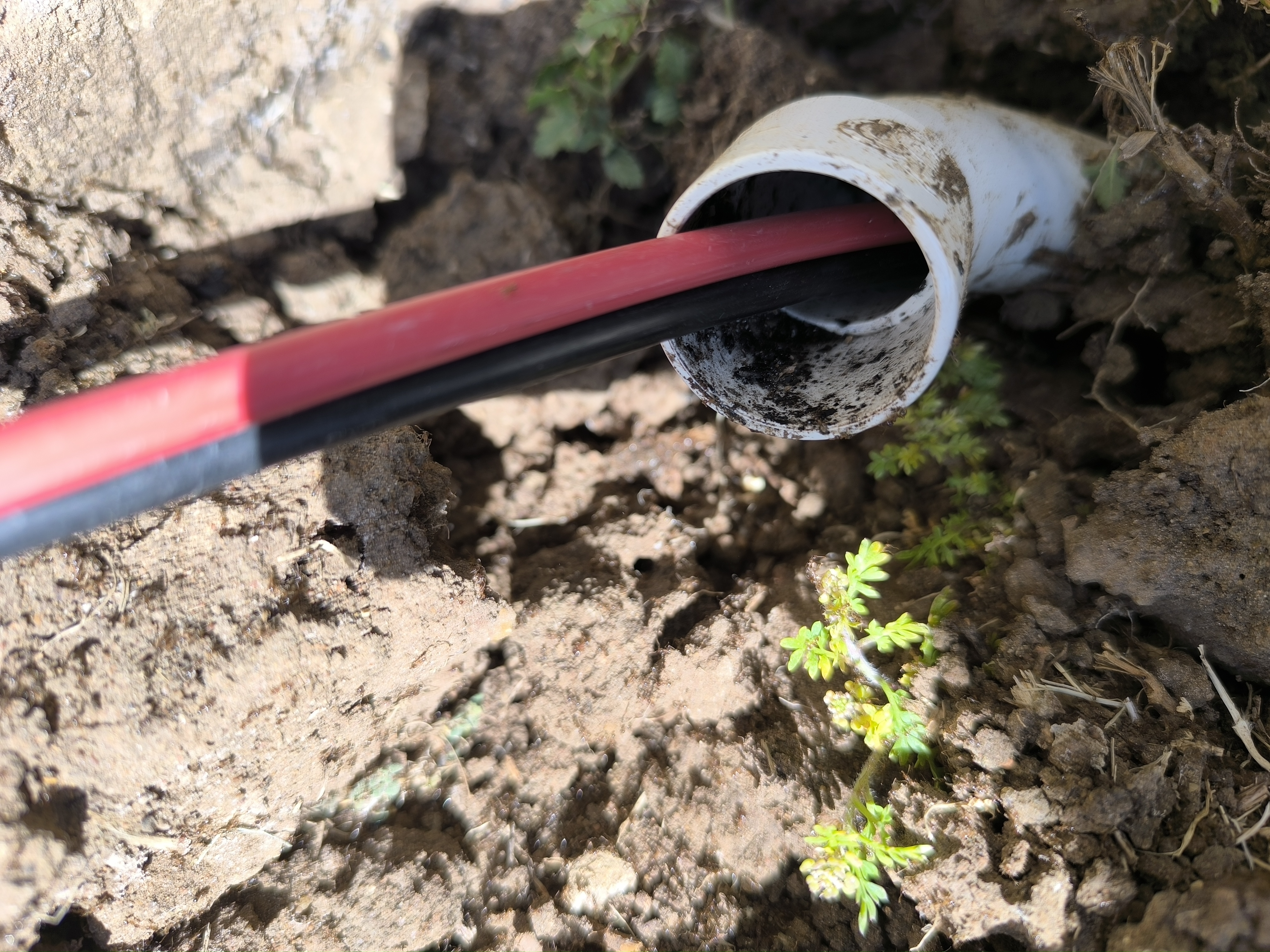

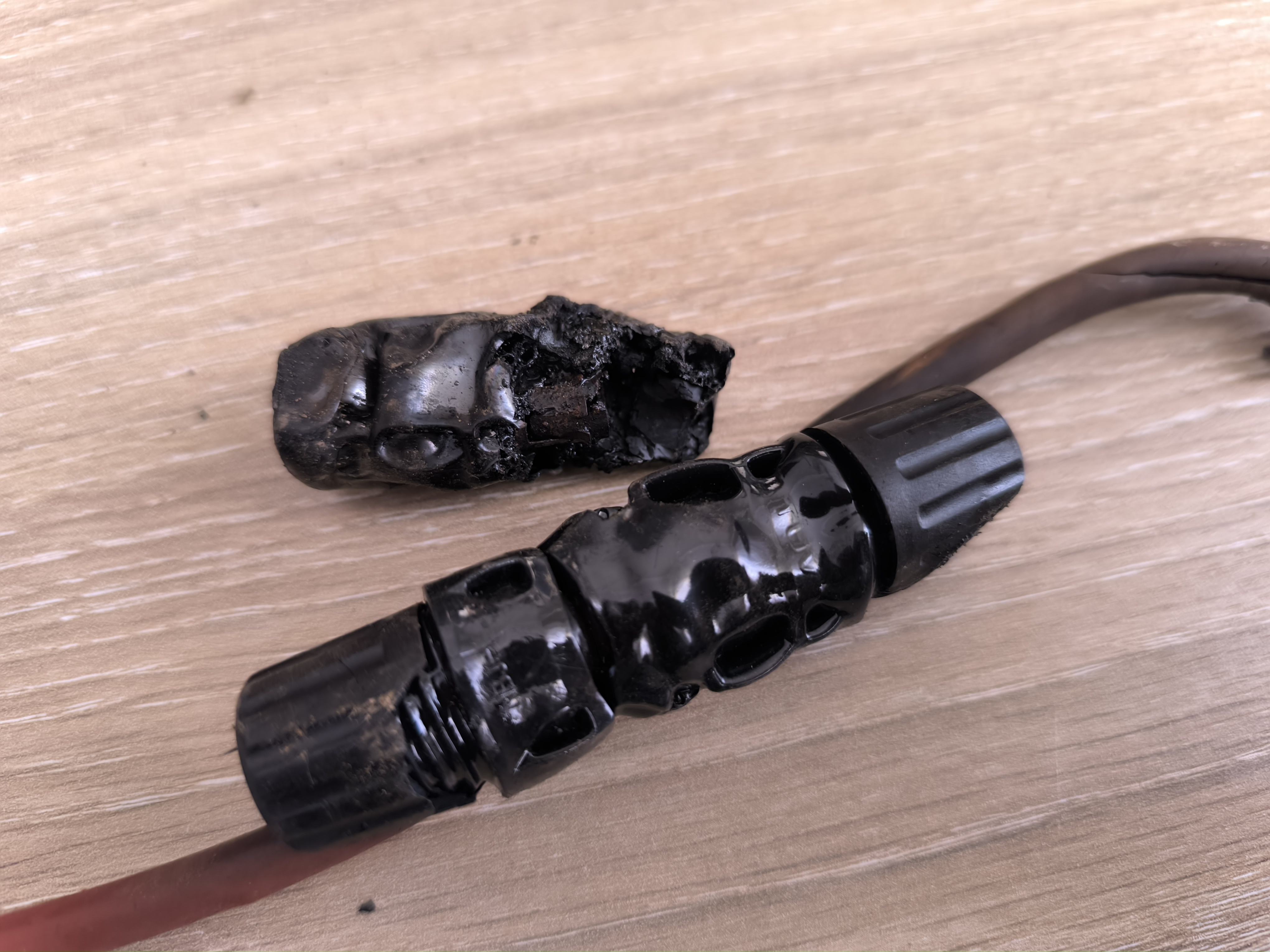

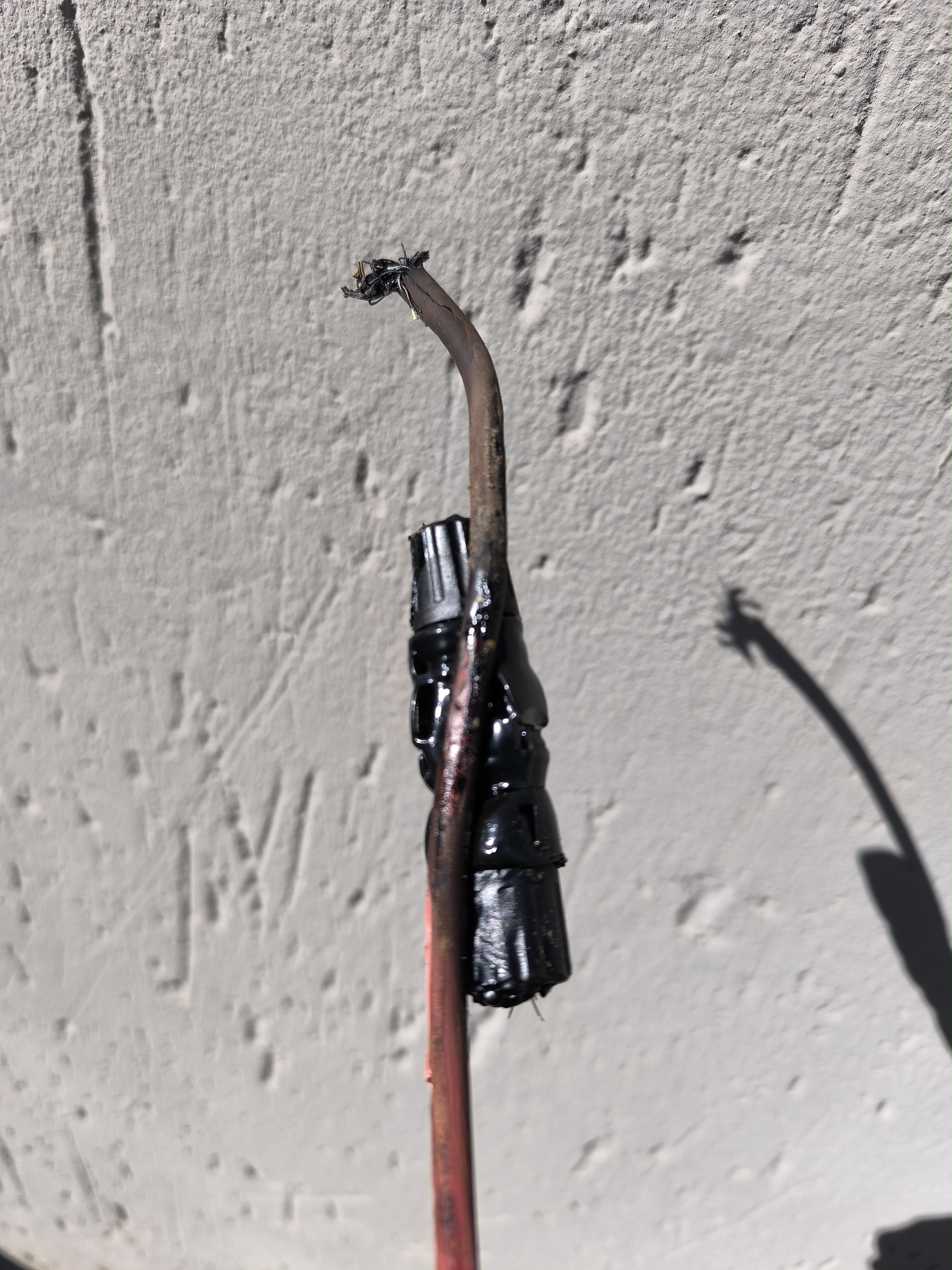

@BLUETTI_CARE @sealy1986 @Mandp MAJOR UPDATE: I decided to just dig up the conduit pipes, and pull the cables out… (just to check them off the troubleshoot list, couldn’t wait any longer for the multimeter) as I pulled on one end of the cables, they immediately snapped. I opened one joint of the conduits and pulled on the cables and a nest of ants swarmed out. Pulled out the cable and found burnt MC4 Connectors (which may have been due to resistance and ants which somehow got into the pipe).
Your initial suspicions were correct…
I will run new cables, when my order comes through tomorrow… and UPDATE you the end result.
Mmmmm! that’s what I call a valid reason for poor solar lol. :grin:
Might be a good time for redesign. Put the connectors into a weather proof enclosure, both ends with no joins. That may help keep the Ants out and be easier for you to inspect in the event of another problem.
Fusing near the panels as an added protection…

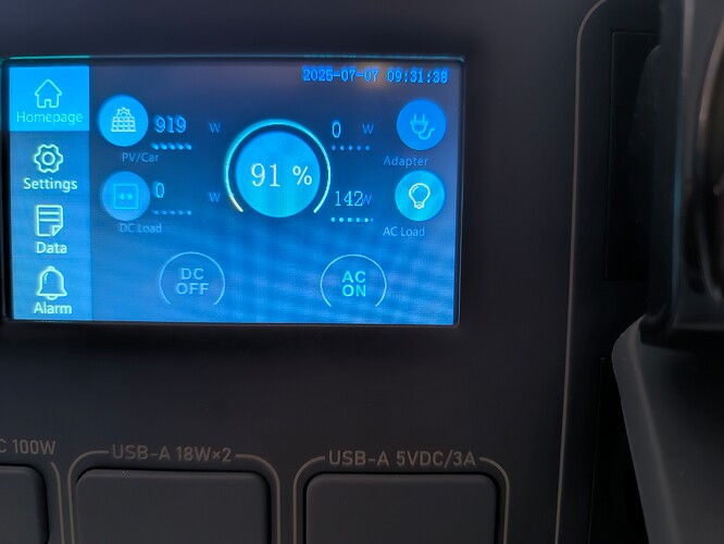

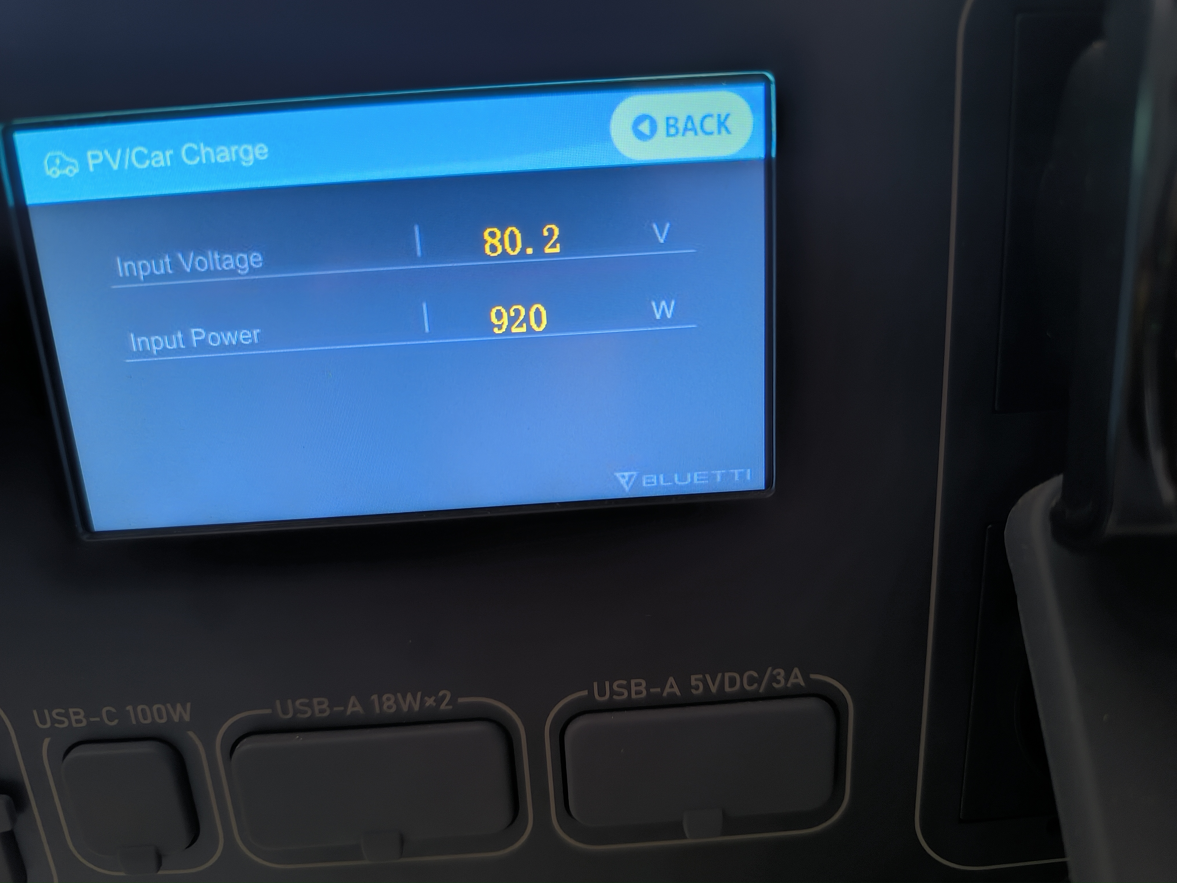

@sealy1986 I ran new cables this morning and I’m getting (1KW) from my panels at that angle - also please note: I do NOT change the angle of my panels during the day and I haven’t changed the angle of my panels in over a year) and as mentioned in a previous reply, I did extensive testing of all angles, and for my yard and set-up this angle gave me maximum results (35degree tilt from a 90degree wall) = Full power from 8:30am till 2pm

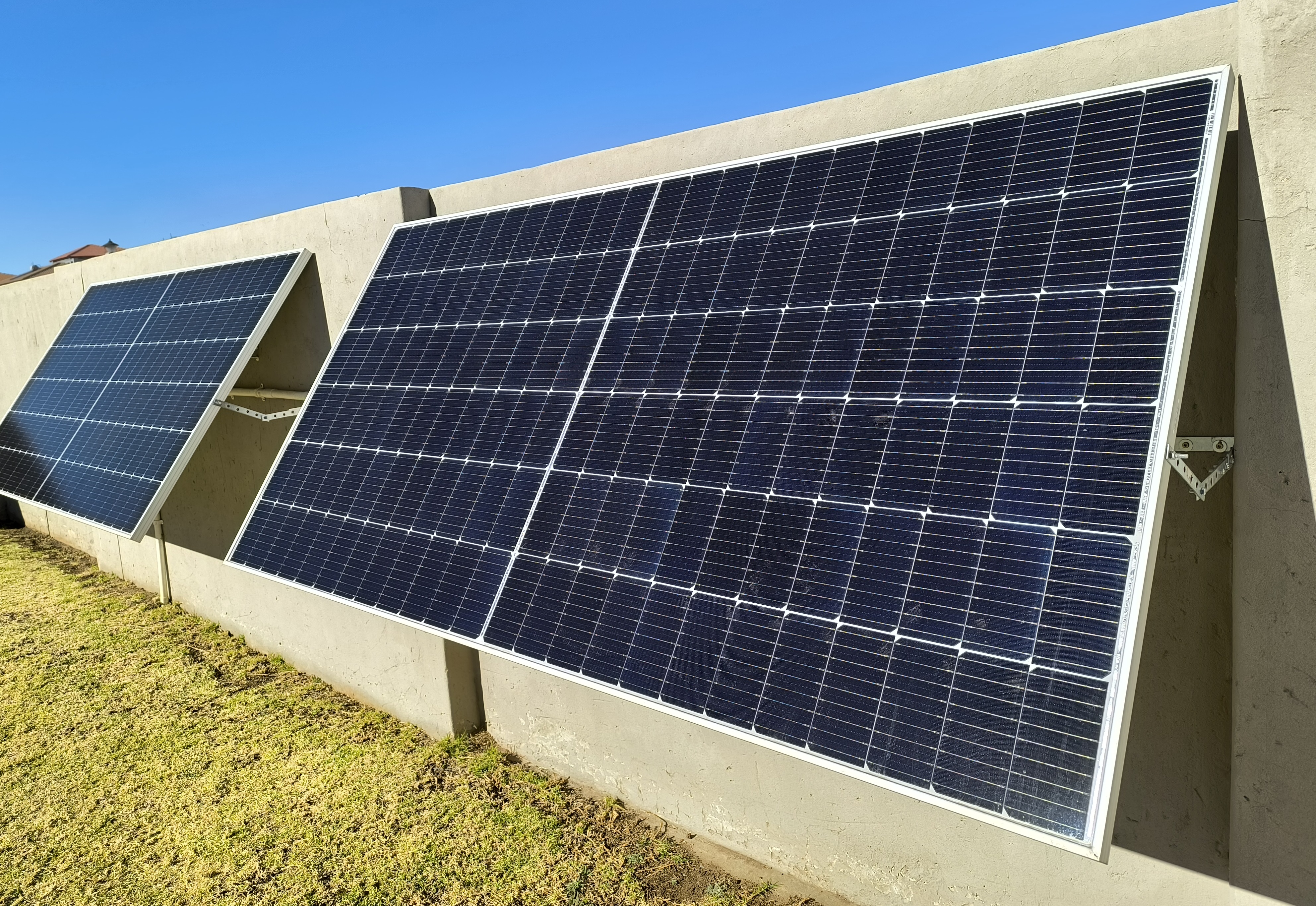

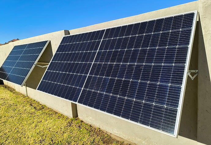

@BLUETTI_CARE @sealy1986 @Mandp (FINAL UPDATE: SUCCESS) My order was delivered this morning, new cables and MC4 connectors. I crimped new cables, plugged them in (maximum power). I have attached images so you can see how my panels look during the day. (and the AC200max Power INPUT). I was already getting full power by 8:30am (I guess I won’t be needing the multimeter).
EDIT: Also incase you were wondering, on my property the sun rises on the left of the picture and sets on the right So the sun never directly rises over and behind my panels (that’s why I’m getting full power from morning till 2pm) before it gradually decreases to 200watts by 4pm, so if I wanted full power till 5pm (or 6pm in summer) I would need to place solar panels facing the sunset on my right facing wall (that wall is on the left side of the picture) I will only do that when I upgrade to a bigger power station.

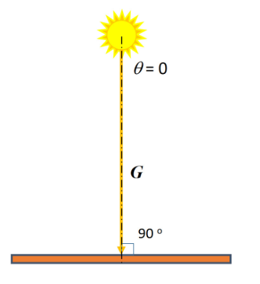

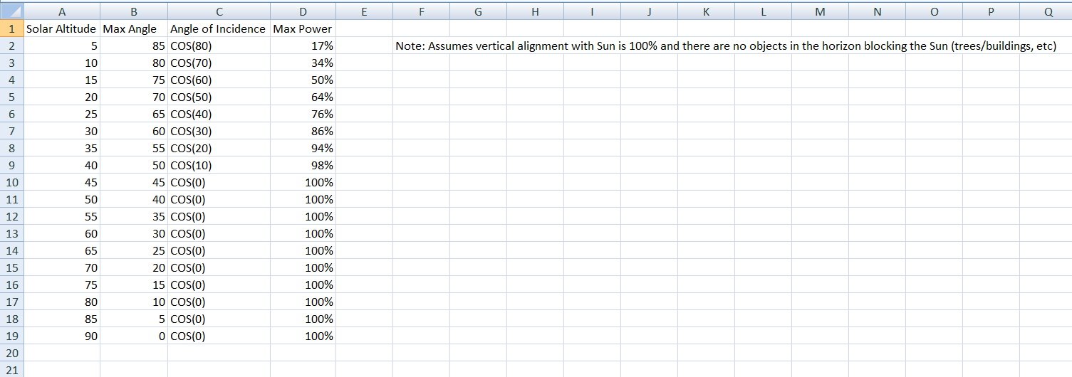

Yeah that looks about right too in the picture. My math/measurements were wrong. The maximum tilt angle is simply 90 - whatever the highest point of the Sun is. Any more then that and you’ll be facing away from Sun. So 90-35=55 degree maximum horizontal tilt. Your panel is tilted 35 degrees from wall vertically to get the same “55 degree” equivalent. To calculate your power you take panel tilt and subtract that from altitude of Sun and the COSINE of that result (angle of incidence) is your projected power output. 55-35=20 so COS(20) is 93.6%. Granted this is when the panel is aligned with the Sun. When the Sun isn’t directly facing the panel you have to calculate misalignment which is the SIN values. So if the Sun is 15 degrees misaligned from the panel (SIN15) would result in 25% power output loss. Think for example as the Sun is rising (in the east and heading west) and is not quite lined up with the panel yet. Since you have them fixed against the wall this does not matter as much to you as someone like me who has a portable panel, so the panels are positioned optimally to be in alignment during “peak solar times” I imagine. Does your panel tilt a full 90 degrees to a flat horizontal alignment? I was looking up what the angle of the Sun was in Johannesburg in your “summer” which is around December and its practically at 90 degrees (83 degrees or so) which means you are basically going to want those panels flat during the summer.
Perpendicular angle is essentially directly overhead at 90 degrees
{7B34F93C-1DB0-406B-B524-5D7C00338501}
Since half of 90 is 45, that is the absolute maximum tilt you can get to and achieve a 50/50 balance between tilt and Sun to get a perfect perpendicular angle. Anything past 45 degree tilt means you experience a cosine effect and your angle of incidence can no longer equal zero. You will always be some degree off.

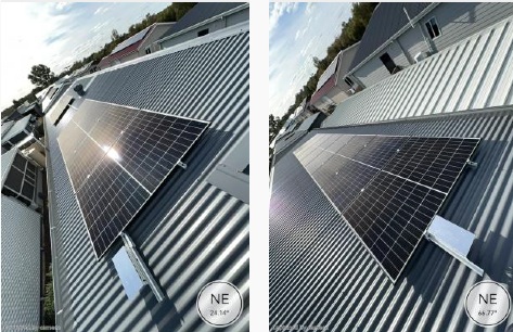

Hi @poyiyo14 Thanks for the reply, and thank you for the compliments I really appreciate it. My solar panel setup is attached in the image below (so you can see what it looks like)…
With regards to making my tilt adjustable for (summer vs winter), it is something I originally considered doing, since I do have more than enough room to keep tilting my panels further upwards or downwards if needed. The reason I ended up settling for my current angle, was pretty much cause of the size of the panels.
With them being huge, adjusting the angle is a 2 man job, and I of-course didn’t want to risk damaging my panels over time moving them around. So I ended up choosing an angle that would give me the best possible results all year-round (without ever touching them again). Which unfortunately has the down-side of being really really good half of the year, and losing performance in the other half (although 700w to 850w isn’t that bad).
I wanted to add more solar panels facing in the direction of the sunset, in order to extend the charging time but unfortunately the VOC is the limiting factor in my case.
