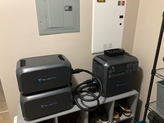

Agree- I have my AC200 Max connected to my transfer panel and use it to power 4 essential circuits ( not the whole house) during an outage. Staying under 2200 watts is relatively easy , and if i use my coffee maker or microwave, I just turn off my boiler and fridge circuit for the time that i am using it - little extra work doing this, but I dont mind, as I am just very happy that I can still use these items this during an outage!
Sept 2024 Update - I am still enjoying my system and I am using it on sunny days to power my 4 essential circuits and in doing so have noticed a modest decrease in my electrical bill. When i do, I flip the circuits over in the morning to be powered from the Bluetti and also turn on the input from my 395 Watt panel. I usually leave it like this until early evening when the sun is no longer on the panel - I then flip back to grid power. If i start with a 100% charge in my system, i usually end up at approx anywhere from 92-100% charge at the end of the day, so am happy with this result. After a couple of days of doing this, when my system gets down to about 80% ( or so) , I turn the panel input on and leave the essential circuits powered from the grid - I can bring my Bluetti system back up to 100% the same day. Late last year my neighbor saw my system and I told him all about it - he bought everything that I had, as he didnt want to be stuck without power anymore during an outage. I used the Bluetti referral program and was awarded the Bluetti Bucks! He then showed a work colleague of his his system and told me that his colleague ended up buying a Bluetti system as well. So there you go - be an ambassador for Bluetti and let your friends and neighbors know about what a Bluetti system can do for them during power outages which in many areas are happening more and more frequently. Would love to see some more AC200 home back up systems added to this post with your story!
Dec 2025 update. I sold my house this past Feb and moved into a condo, and brought along my Bluetti system with me. I was not able to bring the solar panel of course and also being as it is a condo, I am not able to alter the electrical system to install a critical load panel or anything such as that. So the unit is now in my condo utility room and I have a storage drawer with several extension cords that I will use in the event of an outage. I will use it to power my fridge and internet as well as my TV and freezer in the event of an outage. I also have purchased 12v heated blankets in the event that the temperature drops to an uncomfortable level during the winter months. I now no longer have a way to recharge the system, but figure with the items powered that I mentioned, that I should still have approx 2 days worth of power. May look at purchasing a foldable solar panel as I live on the first floor and would be able to use that to repower if necessary. All that being said, it i still nice to know that I have a great source of back-up power in the event of an outage.
