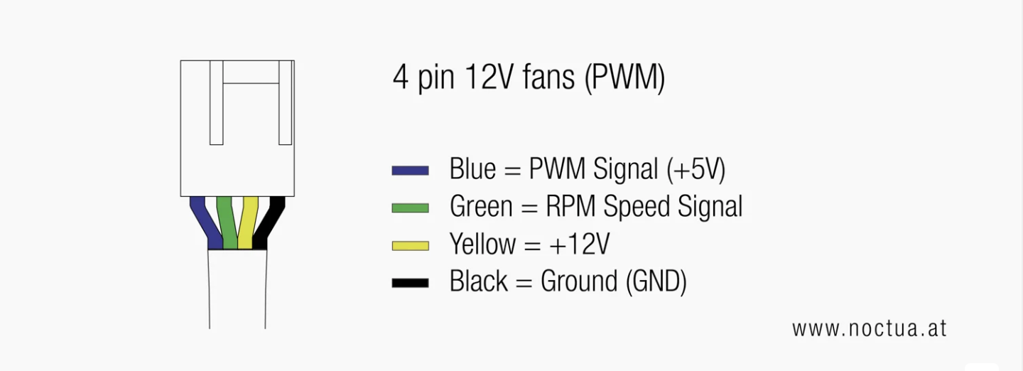

  2. Do you have a 12V Noctua fan?
  3. Are you sure you didn’t accidentally mix up the wires on the connector (the wiring diagram for the 4-pin connector is below)
  1. The connector on the Noctua fan is a standard motherboard 4 pin fan (Molex 2510 or KK series) which is NOT the same connector on the Bluetti Elite board (JST HY 2.00 mm pitch, like I said in my post).
  2. It is a 12 V fan.
  3. I originally did mix up the tachometer & PWM pins, but corrected that, and the error still occurred.
