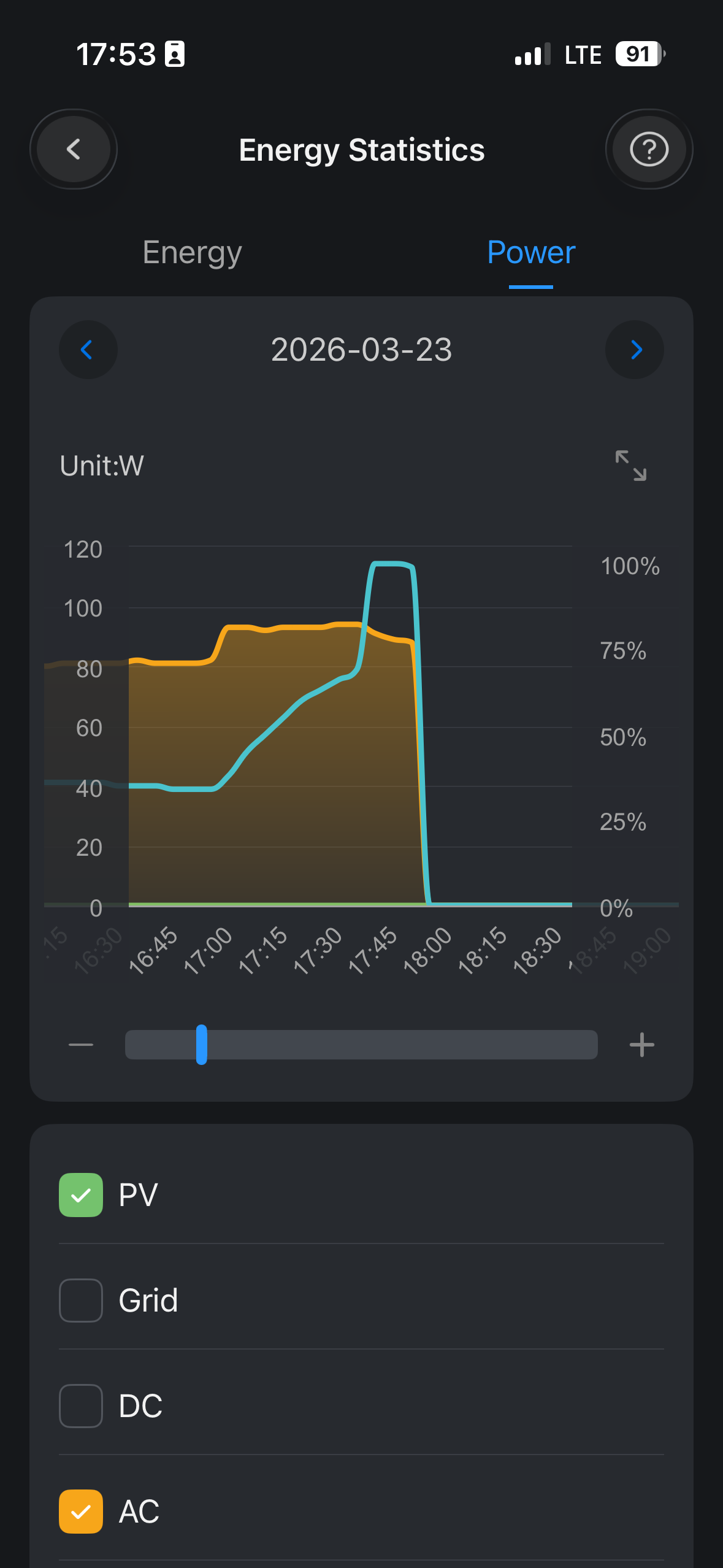

Hi; @BLUETTI_CARE
In my previous message, I said SOC reading problem is solved. Unfortunately it was wrong.
As you can see from the picture. While charging from the grid (460 Wh) SOC jumped from 69 % to 100 % in just five minutes. I am really frustrated at this moment. I can not use PV charging. I can not trust any value show on device. Can it be fixed with software update or Do I have to apply for guarantee.
Thank you

Hi @chem, thank you for your update.
Your firmware is already up to date, and we do not have any additional new firmware available to push.
We would like to confirm whether you followed the standard recalibration process. Please do not load any appliances when charging.
If you have only used AC charging, please also try DC charging.
When discharging, we recommend using a stable load with relatively low power. Does this help resolve the issue?
If the battery level still jumps abnormally, we will need to arrange warranty service for you.

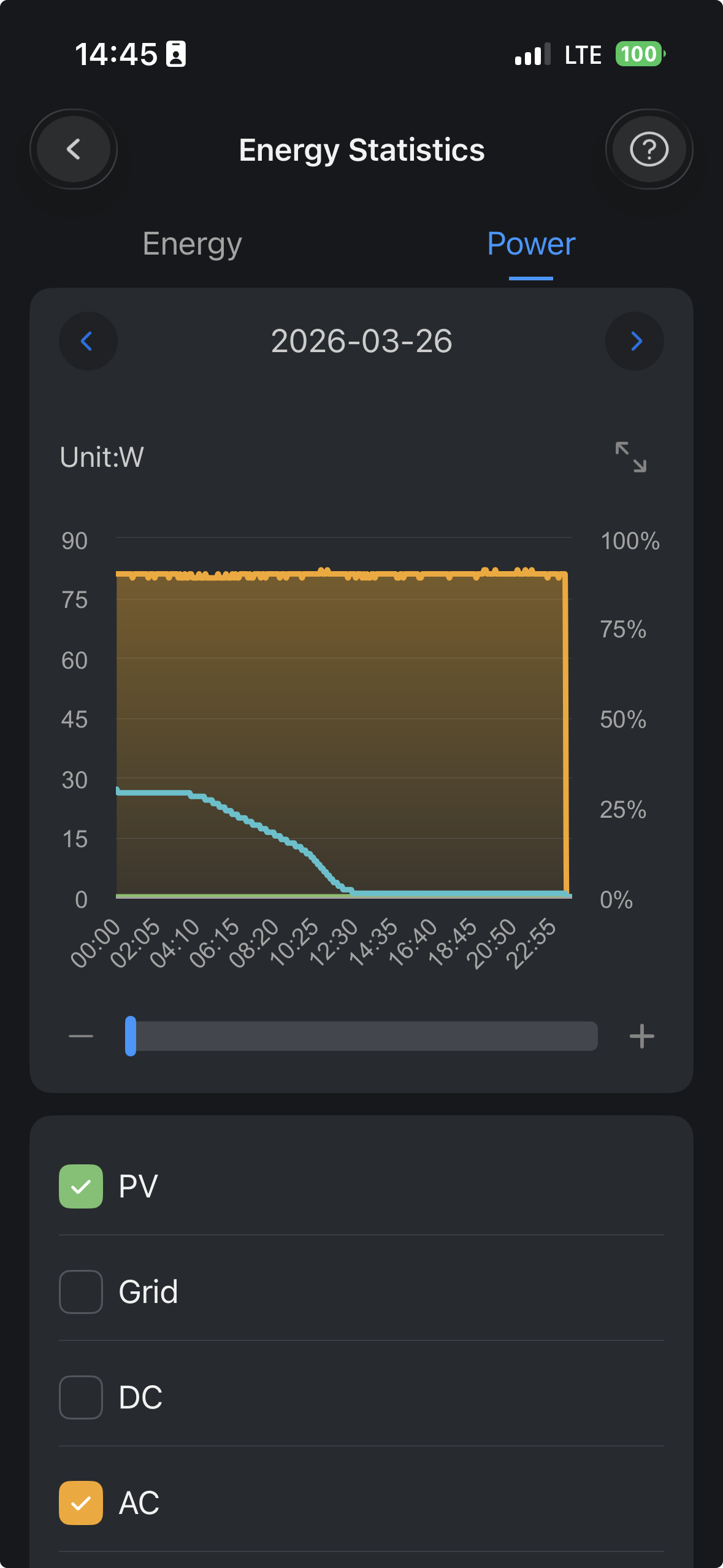

Hi, @BLUETTI_CARE
Thank you for your attention. But problem still exist. What I have done so far is as follows;
  1. I discharged it very slowly with app. 10-15 W load. It took app. ( I am not kidding) more than 10 hours to deplete final 1%.
  2. I charged it from PV. Charging is very consistent. But again discharge is very inconsistent. Especially SOC values over 70 % SOC readings get more inconsistent.
Problems with my power stations;
  1. It can not measure inlet wattage. Currently I am using 1A AC charging speed. It equals to 230W. But when charging watt meter says, power station only draws 160 - 170 W.
  2. Power station shuts the grid connection when set SOC is reached with PV charging. But it still draws all the power from the grid at PV priority UPS mode. My TV setup uses app. 13 W at stand by position. Even with a closed grid; it still draws 13 W from the grid. Both inlet and output wattmeter’s confirm this value.
  3. It can not measure output wattage. As I said before, My TV setup uses app. 13 W at stand by position but on power station measures this value 55 W and with a closed grid connection this value jumps to 92 W. Can this much difference be between apparent and reactive power.
There are also good things to. It works perfectly as an UPS. When grid is down there is not even a slightest flicker.
I am not sure about applying to warranty because in Turkey it is always a mess. I am sure there is no one in Turkey to repair any kind of problems in this device. And I do not think a replacement will be possible.
Best regards
When you charge with a current of only 1A, the current is too low for the system to measure accurately. Would the result be different if you increase the charging current?
It is normal that the system still shows AC input power when loads are connected, even in PV priority mode. Due to factors such as shadows and wind, PV charging power is highly unstable. To avoid affecting the loads, the system bypasses them to the grid to improve output stability. Otherwise, devices like TVs may frequently shut down or restart.
The difference between apparent power and reactive power is indeed quite large.
Apparent power (S) is the vector sum of real power (P) and reactive power (Q).
It appears that the unit is functioning properly. Since maintenance support is not convenient in Turkey, we recommend that you continue using it as is. No repair is needed.
