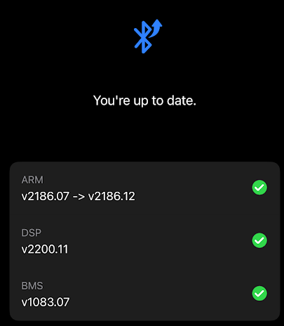

So I just got a ARM update from V2186.07 > V2186.12 but unfortunately, it didn’t help. My freezer still attempts to start but shut off within a minute and then repeat. My current firmware status is as follows.

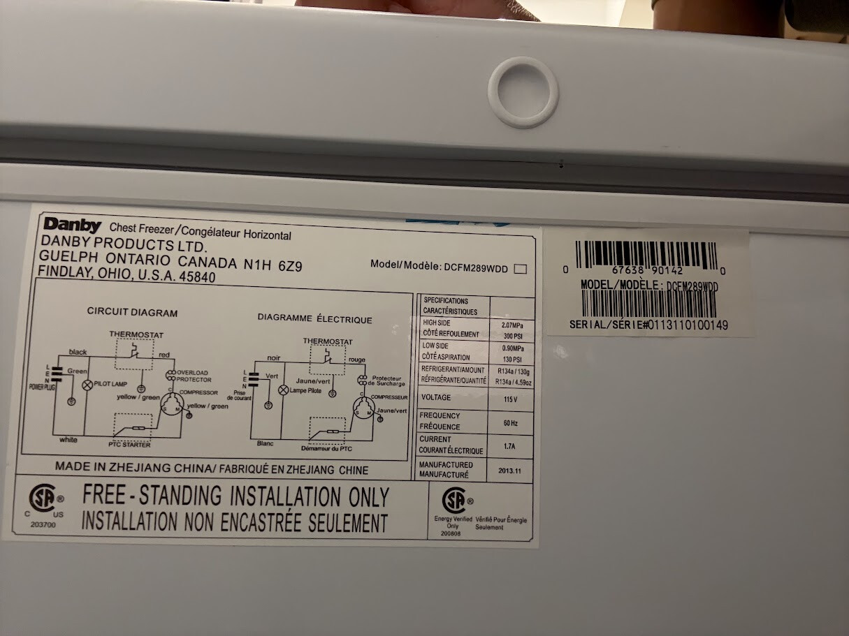

My freezer is a Danby Designer chest freezer DCFM289WDD
