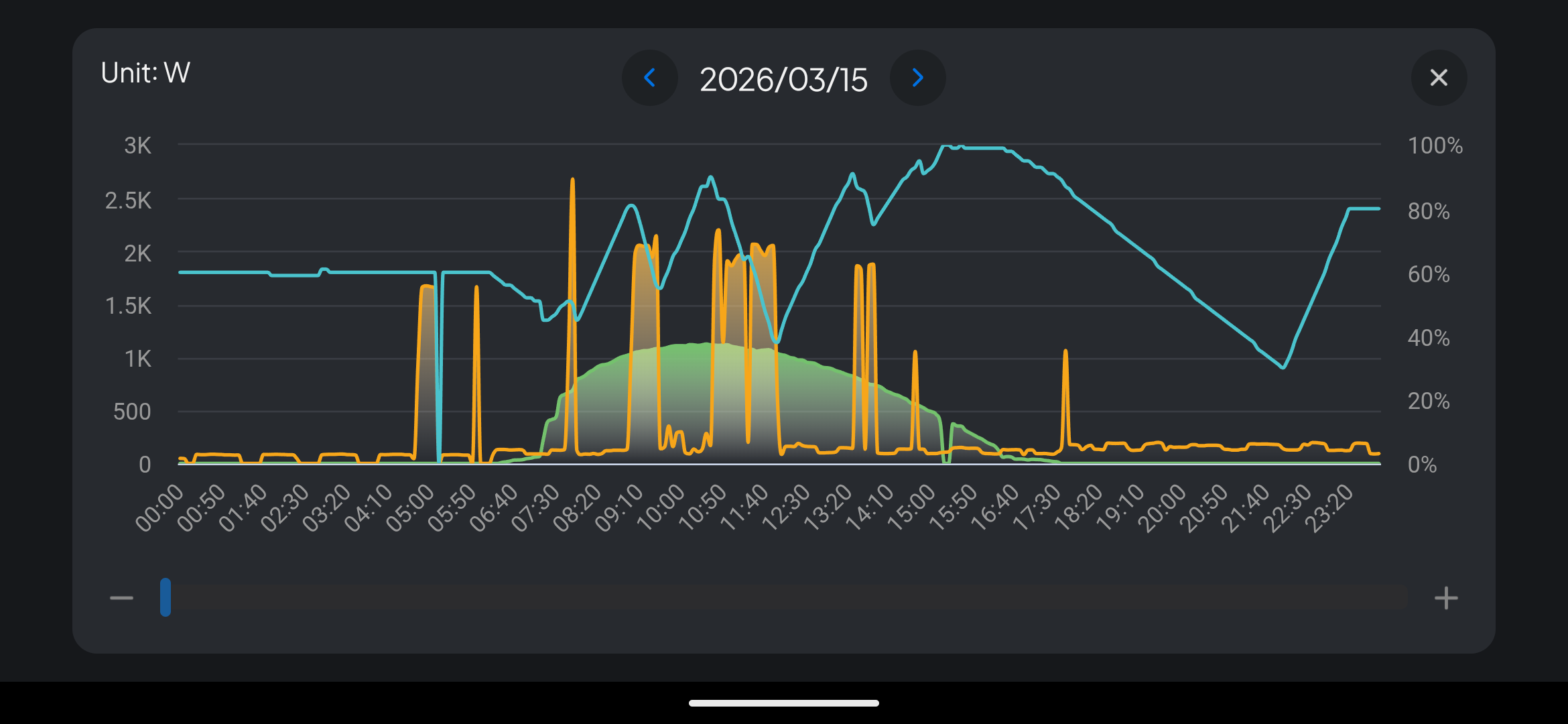

It should be noted that there actually are a couple of options for a user-selectable charge limit in various UPS modes when using grid power. You can set an 80% (or whatever) limit in either Custom or PV Priority modes (I prefer PV Priority as it avoids micro-cycling the battery.) The user manual is rather sparse in details so you have to experiment a bit to see how it works.
The 80% limit does not apply to solar input but this isn’t as much of an issue because the problem is not charging LiFePO4 cells to 100% SoC but rather maintaining it there for extended periods, and if using solar power the charge will drop below 100% as soon as the sun goes down (assuming you have any load), so the battery will never be at 100% for very long.
There is alas no low SoC cut-off functionality and this would be good to have.
