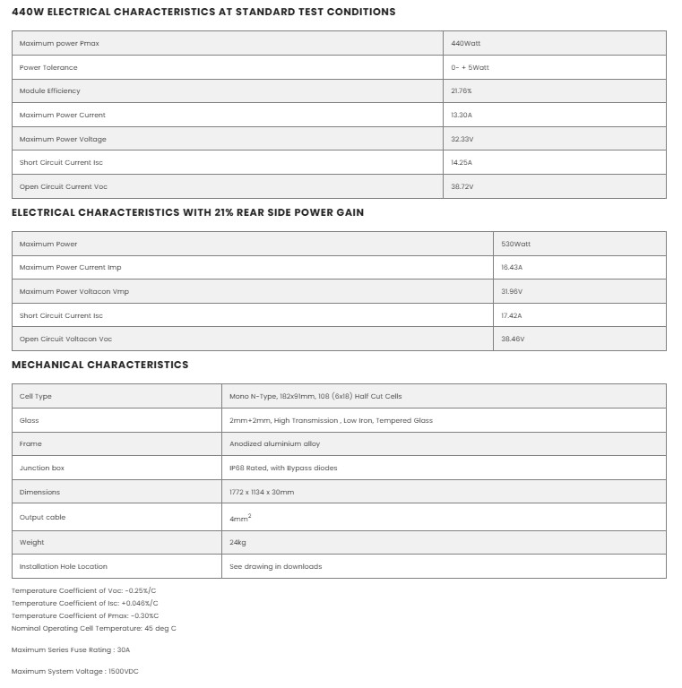

Looking at connecting a pair (2) of these panels in series to DC1 on my AC300+B300K combo
ET Solar Elite 440Watt Solar Panel Bifacial Monocrystalline Full Black Panels
(SKU: ET-NR748TBH440GB)
Elite 440Watt Solar Panel Bifacial Monocrystalline 26% Efficiency - Fu – VoltaconSolar
Would leave DC2 unused, with potential for connecting future panels

Is my plan to use a pair of them with my AC300+B300K combo,
A/ sound? :innocent: or
B/ bat sh!t crazy? :face_with_spiral_eyes:

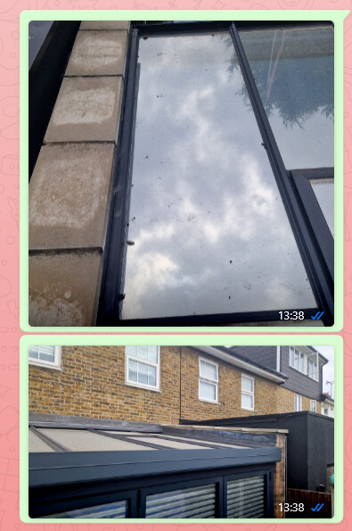

Those panels look great. However, I’m keen on bifacial, where I plan to mount them above a ridiculously reflective conservatory. The glare off this glass is BSC, almost making the room directly above the conservatory unusable in the height of summer.
