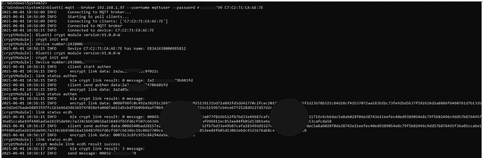

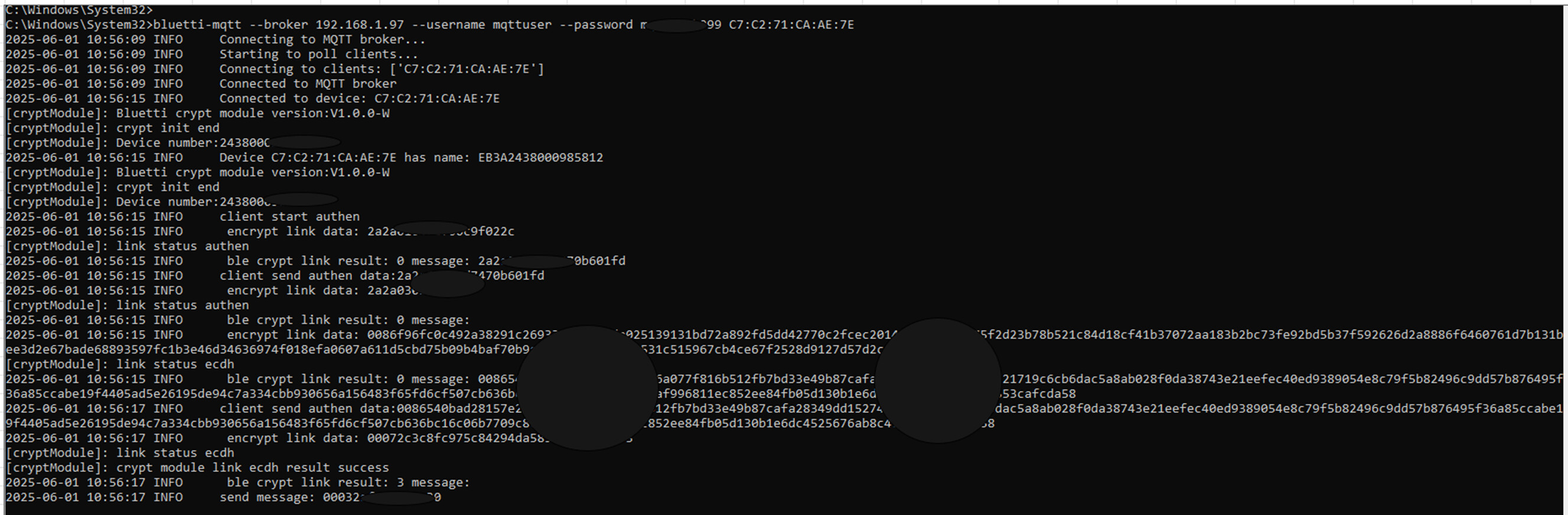

I have got this far. The ChatGPT conversation helped, with where files went.
Windows PC running the example, bluetti-mqtt. I was rather hoping the Broker in HA would now pick the info up. But nothing is happening.
It’s been a bit of trial and error process. Feel a bit weary now, so will leave for a while, see if any one else can see what the next stage is. Maybe it will come to me, with time. Apologies for paranoia blackouts, the numbers bear no similarities to the numbers in the CSV file.
