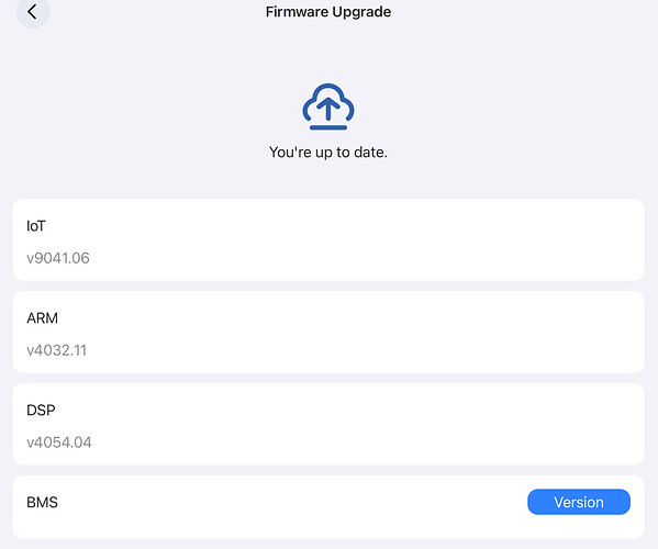

One of them has a firmware version,
IOT v9041.06
ARM v4032.11
DSP v4054.04
but we are unable to match them individually. Could you please confirm the firmware version for each unit? Once we have that information, we will push the corresponding firmware updates.
