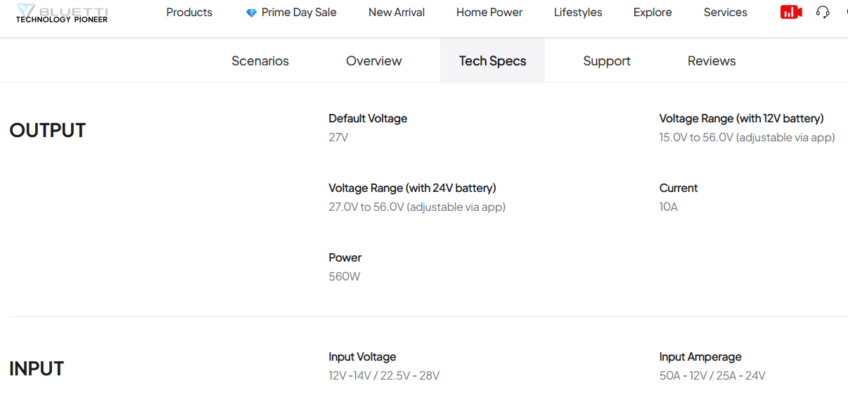

Hi @Audiotech1986, Please find the screenshot as the voltage range of the Charger 1.
Please rest assured, Charger 1 can tolerate low voltages like 14.25V. There’s no need to install a voltage regulator.
We recommend charging while the vehicle is running.
@BLUETTI_CARE hmmmm if the range is upto 14v then when my alternator peaks at 14.9v when driving then it will be out of range can charger 1 be altered to cope to peak at say 16v without a regulator?

Hi @Audiotech1986, The peak voltage won’t last long.
Charger 1 was originally designed for 12V starter batteries. As long as the car uses a 12V starter battery, it should be fine.
We don’t think a voltage regulator is necessary—you can use it directly.

I beleive my VW van is producing to much voltage as stated in previous posts of about 14.9v which is above the 13v threshold of the Charger 1. I have a caravan friend investigating a type of regulator for me to bring that voltage down to within the ratings of the Charger 1 you so kindly shared with me in a previous post
@BLUETTI_CARE @Audiotech1986 It really look like it mightbe too much voltage at the input. Nobody here in this thread have their alternator voltage under 14v, but more in the range 14.1-14.9v.
