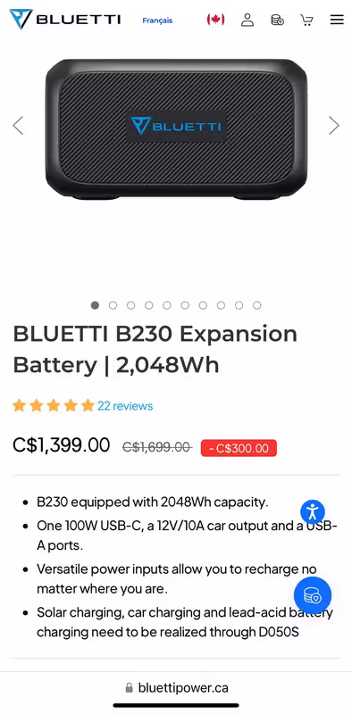

Testing image attachment…
https://i.postimg.cc/yxJ6HRGb/temp-Imageegb-Qyr.avif

With respect to my stating $4,000 for my BlueTTI backup system…it absolutely cost me $4,000. I paid $2,099 to BlueTTI for my AC200MAX, and I paid $1,399 to BlueTTI for my B230. And you charged me 13% tax (as you should). That total comes to $3,952.74.
