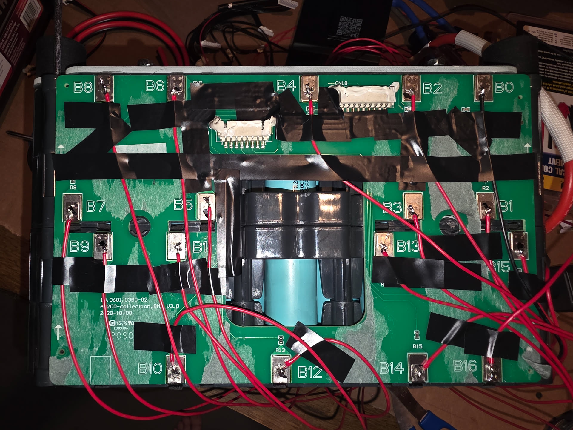

Next, if you tear off the cardboard covering the circuit board on the front of the battery pack itself, you’ll see that the terminals are nicely labeled B0-B16!
(Please try to ignore my terrible soldering job, I’m slowly getting better)
I needed these connection points to connect the voltage sensing leads for the BMS. Since it is a 16S4P system, it needs to be able to monitor the voltage of 16 sets of 4 parallel cells. Each set of parallel cells should measure around 3.3V.
If the connection points weren’t labeled, they would be easy enough to identify. B0 should have continuity with ground. Find the connection point with 3.3V drop to ground, and that’s B1. 6.6V drop to ground, that’s B2. And so on.

I soldered the 16 leads for each set of cells (B1-B16), one to the common (B0), and one to the positive output cable on the side of the pack. One of the B- leads on the BMS goes to the ground on the side of the battery pack.

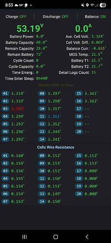

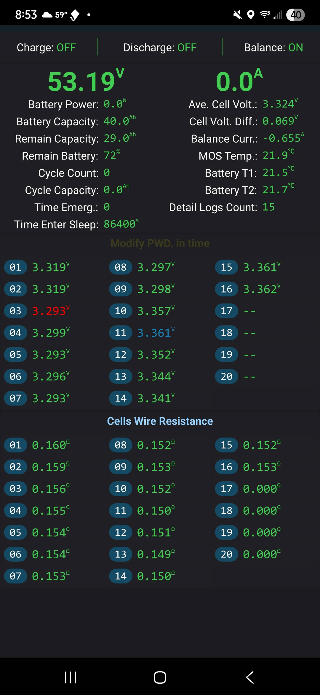

I hit the BMS power button, and we’re off to the races! Android app is showing the cells are fairly healthy. I’m hoping this BMS will do a good job of balancing them once I get a good charger for it.
Through the app I was able to enable power output - and measured 53V on the BMS output!
