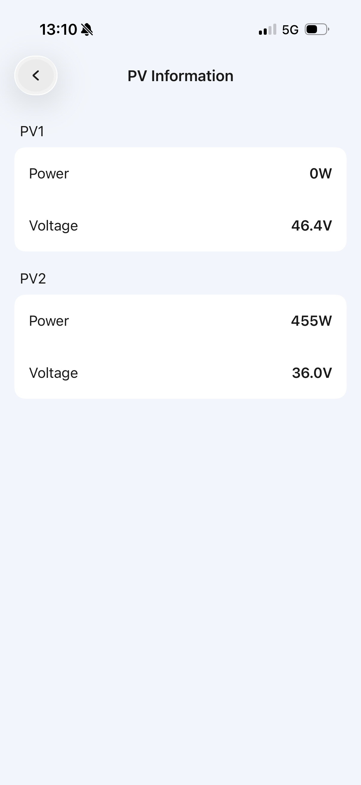

This is what I am at currently
v2204.12 was the ARM that I was updated to which fixed the cut off issue at lower SOC. But it still cut off sometimes at high SOC. I am now testing a new IOT v8026.13 and ARM v2204.13 that may resolve the MPPT PV input issue at high SOC. These are likely test builds, and if it works, probably will roll out broadly in Nov. I’ll let you know what I find.
