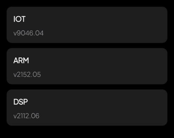

Ok, please tell me your firmware version.
photo_2025-11-06_20-27-06
Hello, I have registered you for the firmware upgrade.
Thank you very much. What should I do next?
