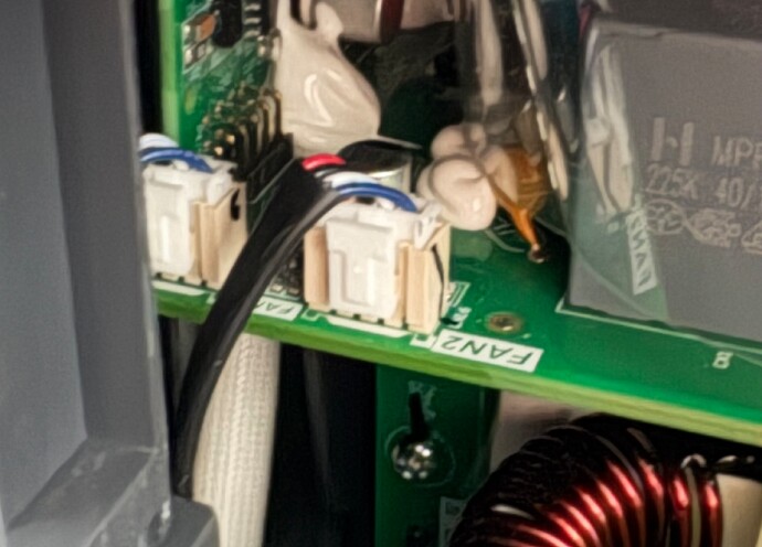

Do you see the markings on the board itself?
I would assume red is 12v
Black is ground
Blue is PWM
White is RPM
you need to open a diagram for the fan you want to replace it with and connect the wires respective of their purpose, i.e. Noctua:
Here is on 1:16 official video, looks like there no instructions on the board itself,
Thanks for help. I haven’t fully disassembled the unit. Only tried cover on the side.
However there’s a video where someone assembles the unit. And at 10:38 you may see how the fan port looks like.
