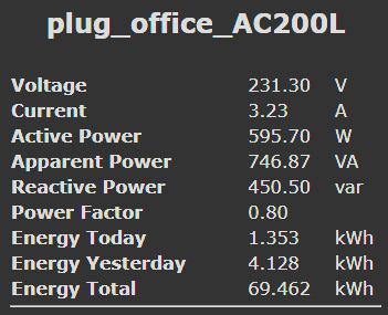

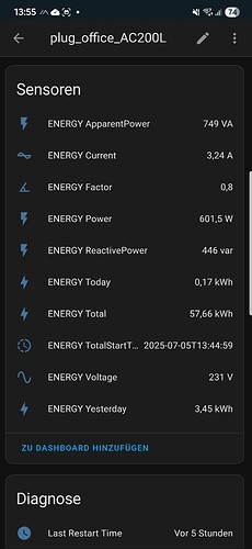

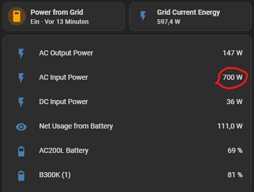

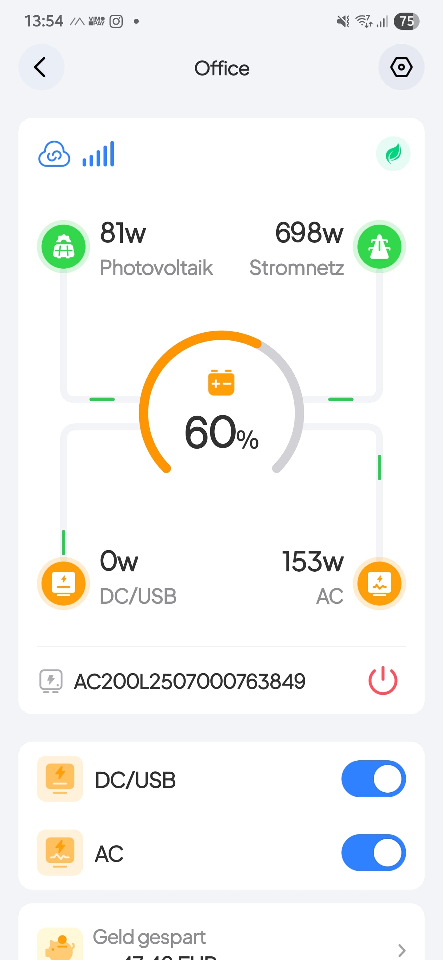

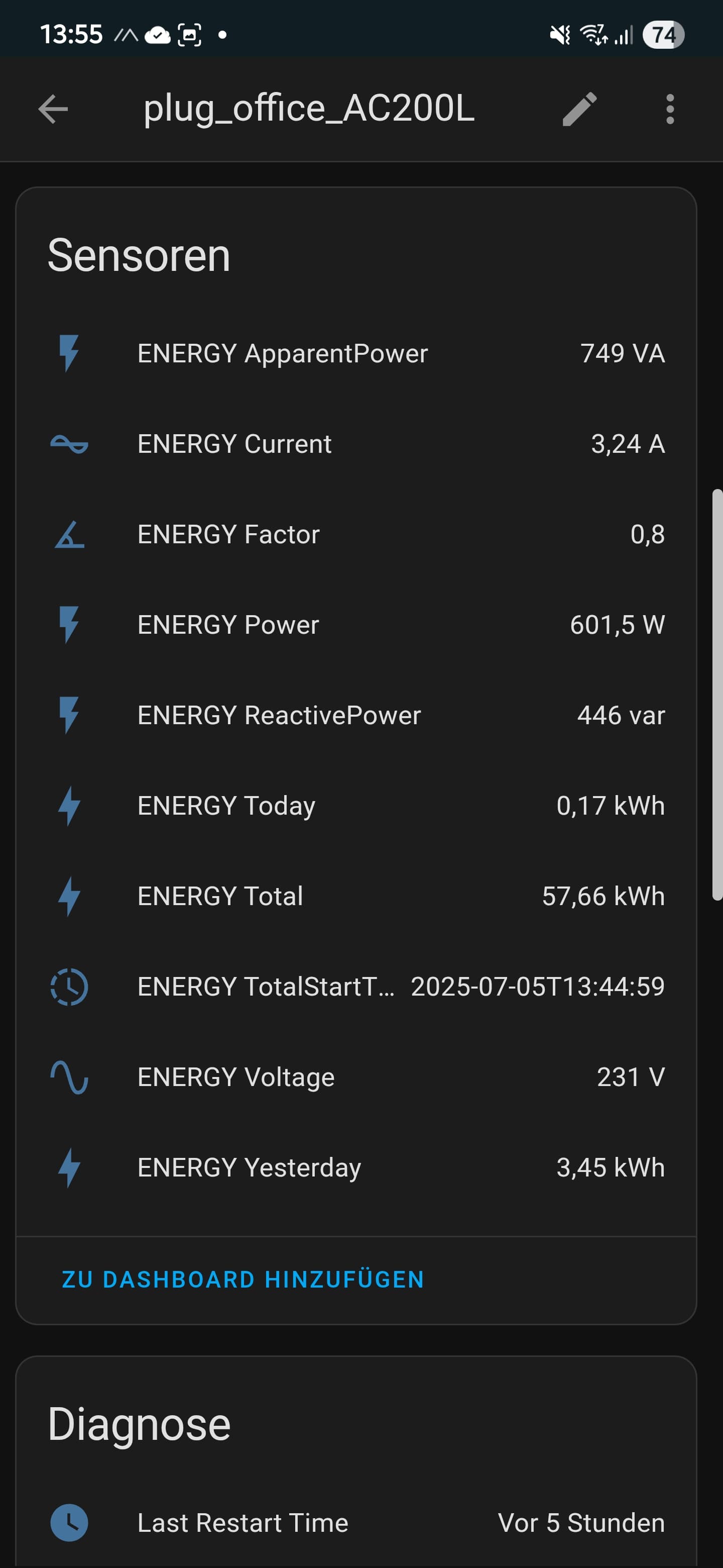

In my case I just came up with the idea to test what happens when I allow the unit to charge while AC is on and I found another interesting behavior:
  • Bluetti app shows roughly 700W grid draw
  • While my power socket shows about 600W grid draw,
If I do a little Math: (698 + 81) - 153 = 626. That would come close to the real power draw but still a difference of 26W. The app shows the numbers in a very weird way anyways.
