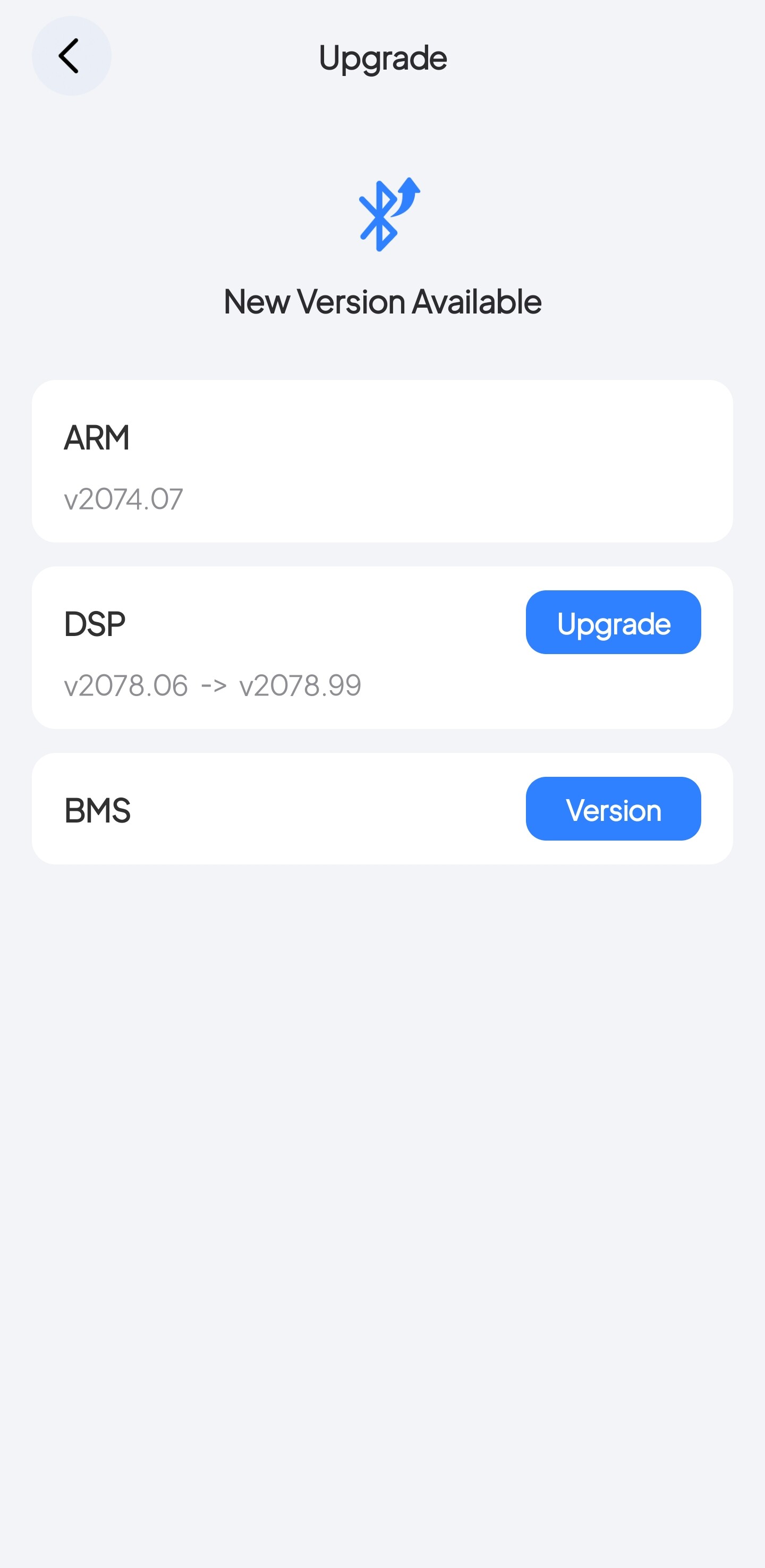

However I keep seeing this. I assume this is a bug? or is there an actual .99 version?
I tried upgrading a few times, but it always show this again.
Hi @seesaaaw, Thank you for the update. This is normal. The firmware upgrade process only allows upgrading from a lower version number to a higher one. To enable rolling back to the original firmware, we temporarily named the original firmware version as Version 99.
Since you have successfully reverted to the original version, we have removed the upgrade prompt, and you will no longer receive upgrade notifications in the future.
