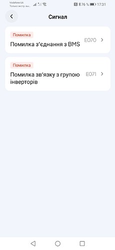

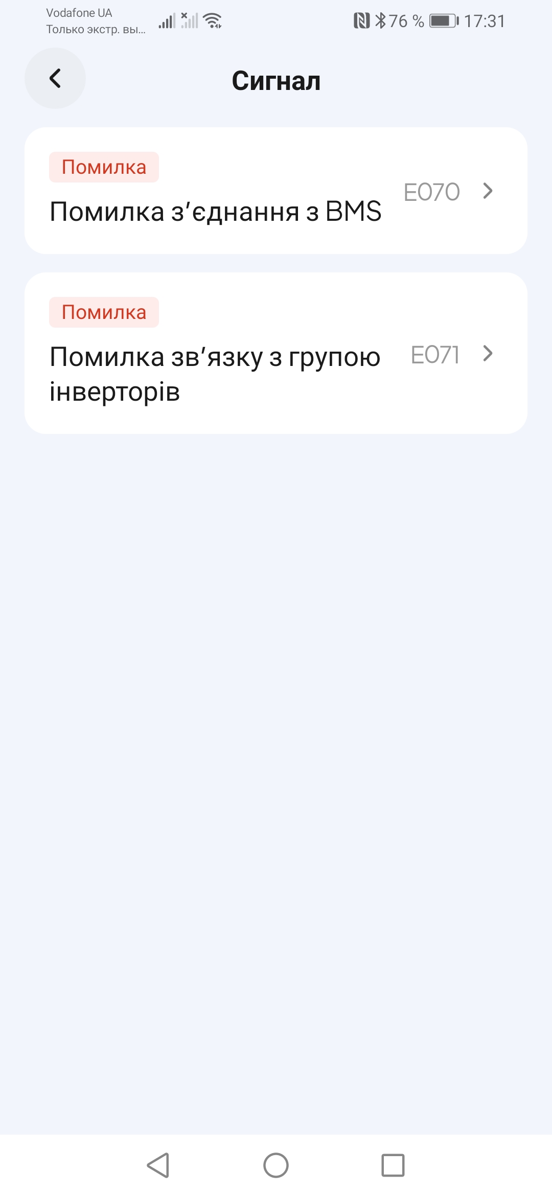

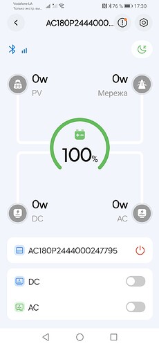

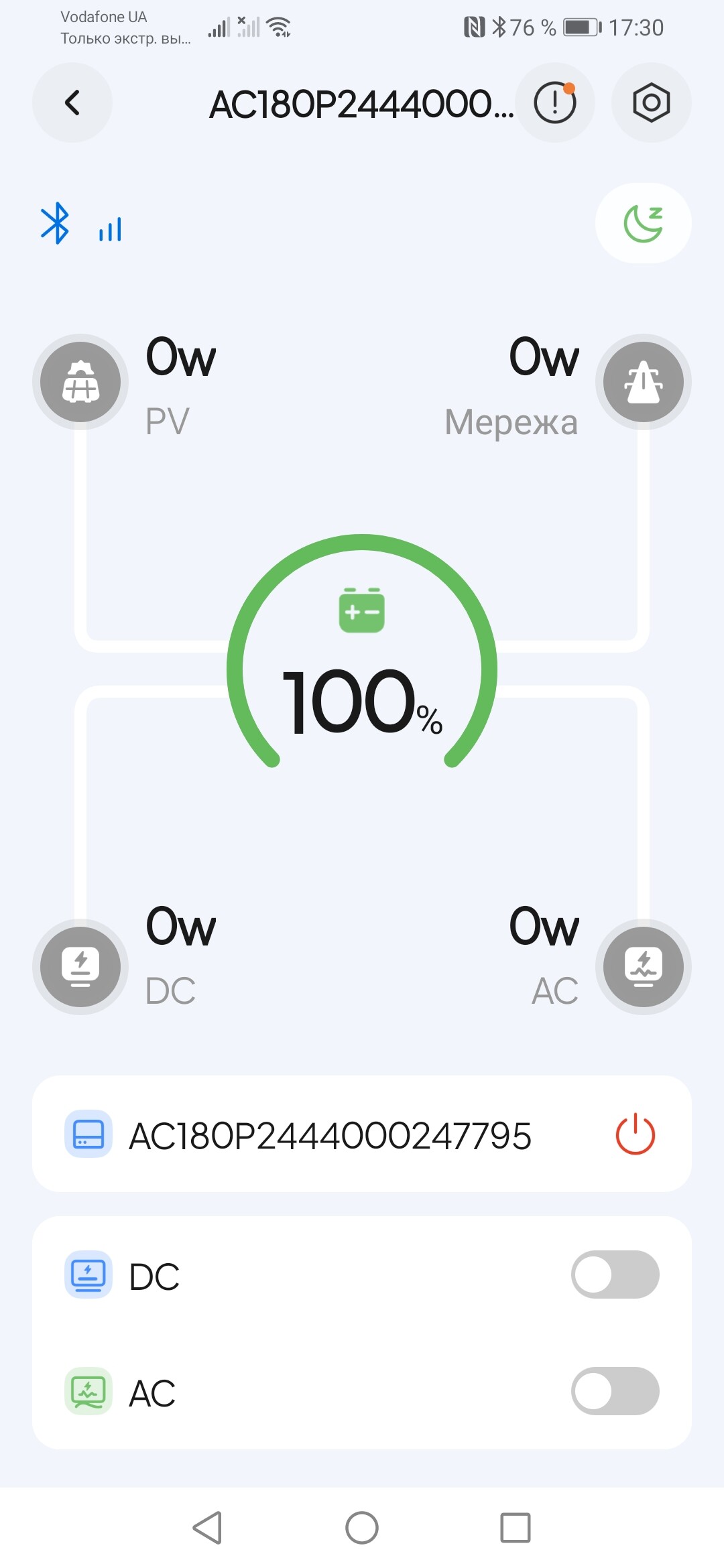

“Hello @BLUETTI_Care,Yes, I have tried restarting the unit with zero load, but the E070/E071 errors still appear after about 30 seconds.Please look at the attached screenshots. You can see that:
The unit is functional, showing 100% battery and working for 30 seconds before the error.
The BMS version is completely blank in the app.
My battery cells are perfectly balanced (checked manually).
Since the unit is in Ukraine, a warranty return is extremely difficult. I am 100% sure this is a firmware communication hang-up. Please push the latest BMS and DSP firmware to my Serial Number (visible in the screenshot). Let’s try the firmware fix first.Thank you for your support!”

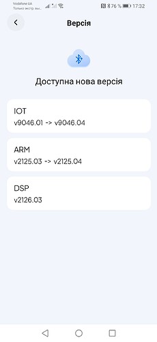

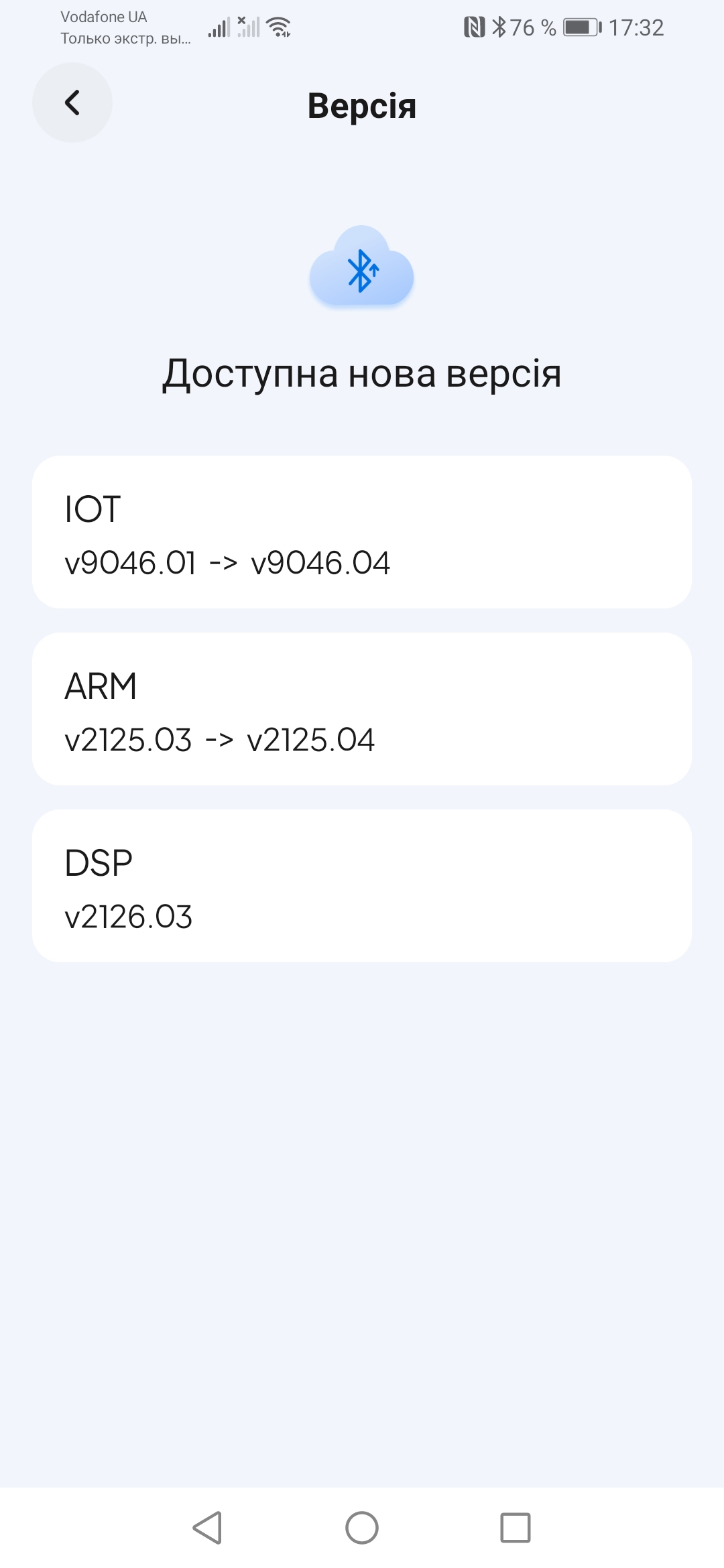

Hi @vetal-19, thank you for your update.
We can see that your AC180P has received the latest IOT and ARM updates, but the upgrade button is not showing. Please make sure the device is bound and connected via Bluetooth, and avoid using offline mode, as this will prevent updates.
We would be happy to push the latest BMS and DSP firmware for you. Could you tap the SOC icon to check the current BMS version? We will push them together afterward.

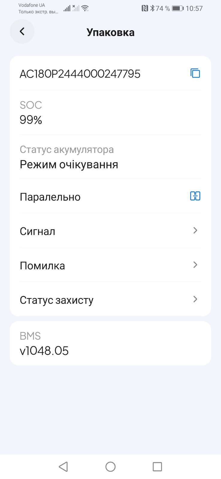

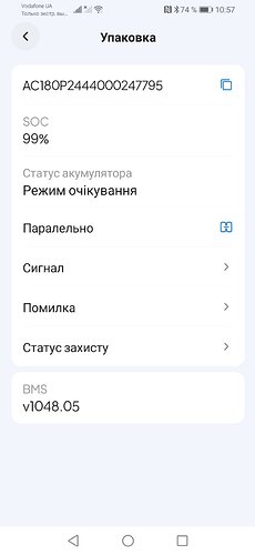

“Hello @BLUETTI_Care, hope you had a good holiday!
As requested, I tapped the SOC icon. Here is the screenshot with the current BMS version.
The unit is connected via Bluetooth and is online. Please push the latest BMS and DSP. Thank you!”
