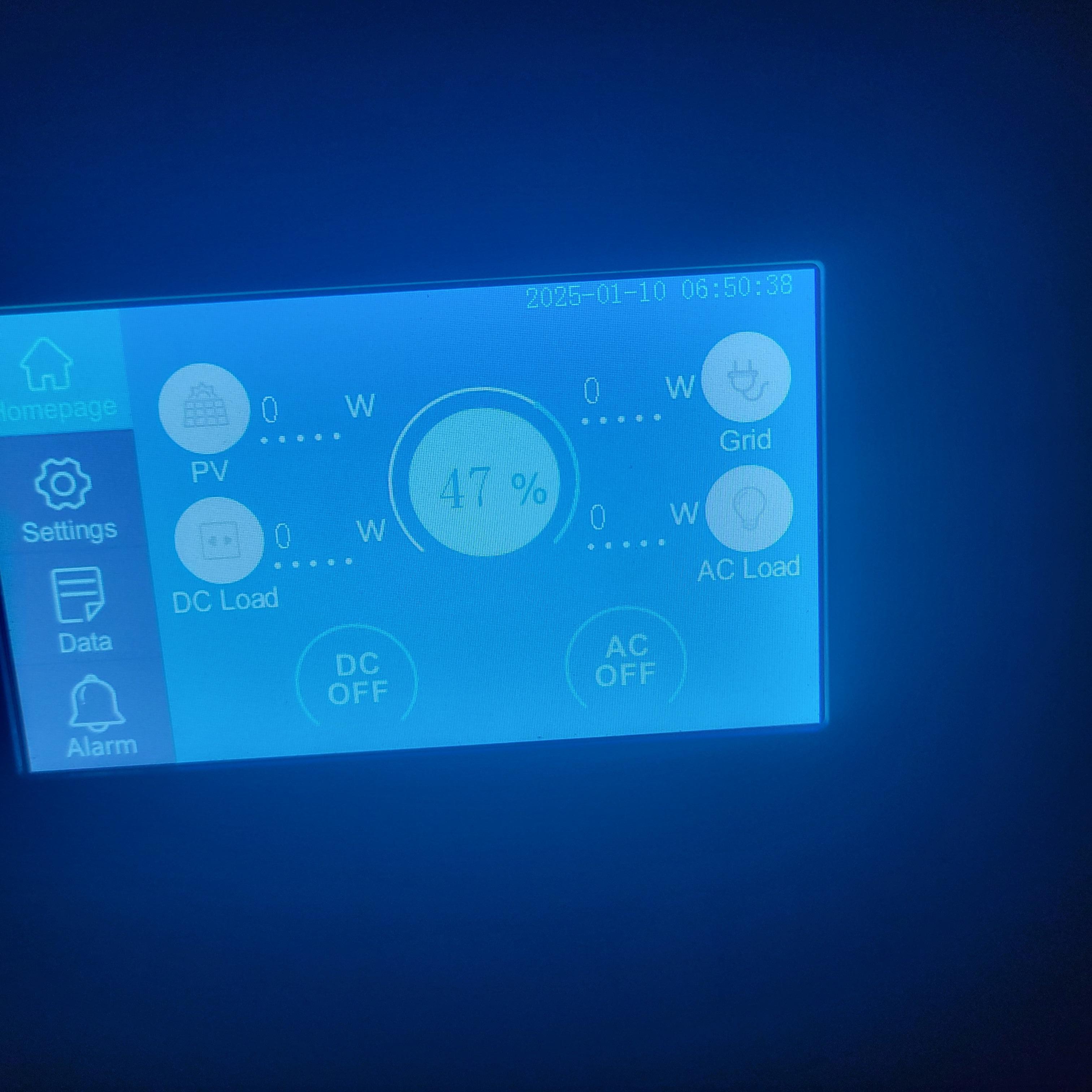

Update
-AC and DC output has been off and remains off.
-ECO mode is OFF and has always been OFF.
-Connections to batteries has not been touched. Recall previously that I was able to get home screen SOC to report correctly by switching the power cables. I am 100% sure nothing has been disturbed.
-System SOC was reporting 17% at 8:17am on 1/9/2025.
-Low SOC was result of numerous overcast days which greatly reduce PV charging.
-Sunny day all day 1/9/2025.
-SOC reported 49% at 6:15pm on 1/9/2025.
-1/10/2025 AC300 is unexpectedly found to be completely off. ECO mode is OFF and was never turned on.
-System was powered on.
-SOC reports as 47% at 6:50am on 1/10/2025 on home screen.
-BP2 is 95% charged. BP3 is 100% charged.
I would like to know your thoughts on this situation?

Yes it is most likely the power cable that is responsible for the SOC misreporting on main screen. I will swap the two cables I have and see if it follows the cable. This morning, 1/13/2025 around 8:30am EST I observed the main screen SOC showing 49%. Thinking this is the suspected cable issue I carefully unlocked and relocked the switch on the cable several times without moving the cable itself. This resulted in the SOC on main screen again reading basically 99-100%. So I can confirm this is responsible for the SOC reporting issue on my system.
It seems odd that switch can lock and the firmware recognize it and then if the switch somehow “unlocks” electrically overnight, but does not move mechanically, the firmware doesn’t catch the changed state of the switch. Should it not still read 100% because it only recognized one (1) battery now being connected instead of two? I think you have a firmware issue here to go along with the cable problem. I don’t think it is reacting properly to the switch being mechanically in the lock position but electrically in the unlocked position.
