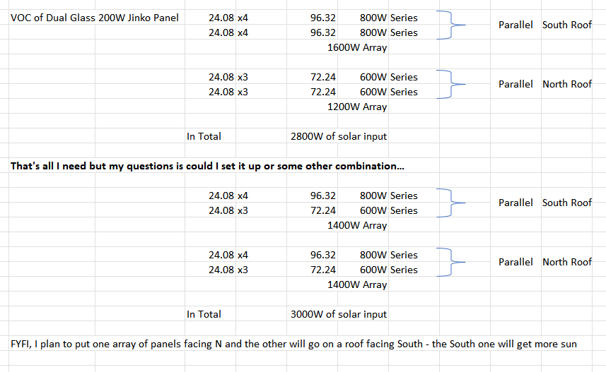

I have an AC300 on order and am following your example… and trying to get some solar panels - they’re a bit scarce at the moment here!
Just a question - I am planning to have 2 arrays:
As I’m sure you’ll gather, what I’m trying to ascertain is: can I fiddle around with the set up until I find the array sizes and locations that work best for me ?
Presume I’ll need a pair of parallel connectors like the Rich Solar ones the other guy needed … ?
Think that’s about it for now.
Thanks

Next day… this is my latest proposed configuration:
I see it’s a good idea to add FUSES to the panels connected in parallel… each panel has a Short Circuit Current of 10.72 A so I presume I’ll need 8 for 2 arrays of 4 panels in parrallel plus 2 more for the combined arrays entering DC1 and DC2 … ?
AI (lol) is suggesting I use 20A fuse for each panel in parallel (8 in total) and then get a 60A DC Circuit Breaker for each of the combined arrays.
