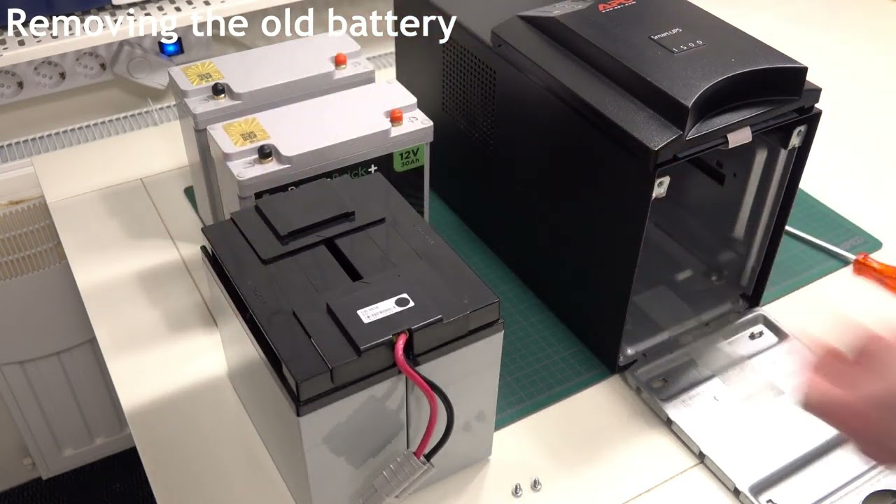

You can consider to upgrade your APC Smart-UPS 1500 with aftermarket LiFePO4 batteries. This will eliminate the need of replacing your UPS batteries every 4 to 5 years and will increase the runtime of your batteries as well, depending on which batteries you use.
:warning: WARNING :warning:
There is risk of fire involved if you do not get high quality LiFePO4 batteries that are designed to be used as drop-in replacement for your SLA batteries, to be used in series, to be charged by your UPS SLA charger.
Read the full video description, especially the part of avoiding low quality cheap LiFePO4 batteries from Amazon etc.
This is my video of my setup. I use (expensive but high quality) European made batteries by PowerTech systems. I use this besides my Bluetti AC300 system. I was unhappy about the AC300 constant charging/discharging when used as UPS and it’s high standby power usage in UPS mode.
I now use my APC SUA1500i as UPS and have my AC300 with a beefy B300 batteries as offline backup. The APC will handle any power cuts and when the power cut lasts longer I can just turn on my AC300 and hotplug my APC ups into my AC300 for a 16+ hour battery backup time.
